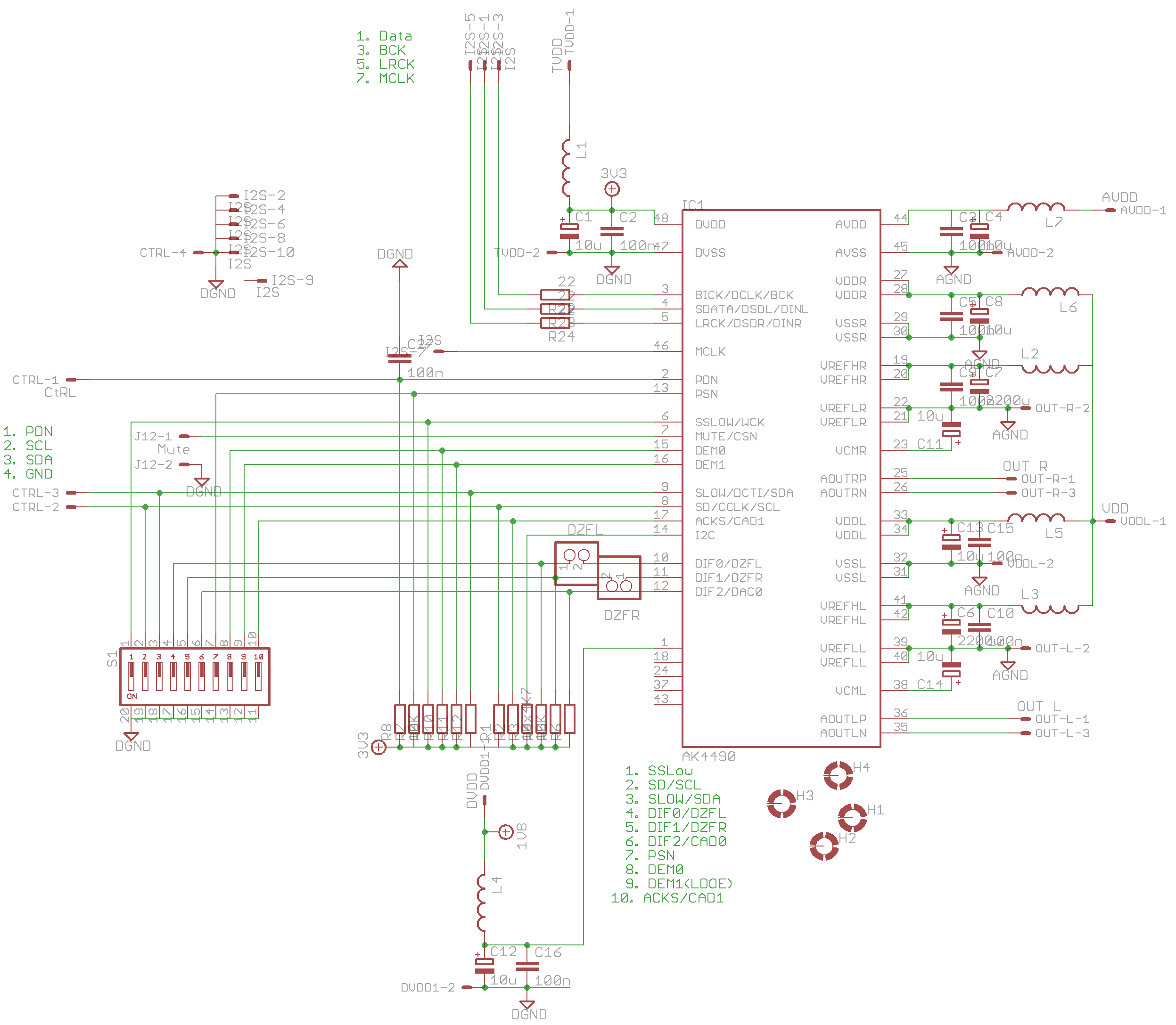

Pops (such as when jumping between tracks) can be a problem with many different dac architectures. Not aware of any bare board Chinese dacs that are full featured in the sense of rigorous pop muting. At least some USB boards make implementation easier by providing useful MUTE and DSD_ON signals. For SPDIF it can be more tricky.
Schematic and gerber
  • AK449x.zip
    AK449x.zip
