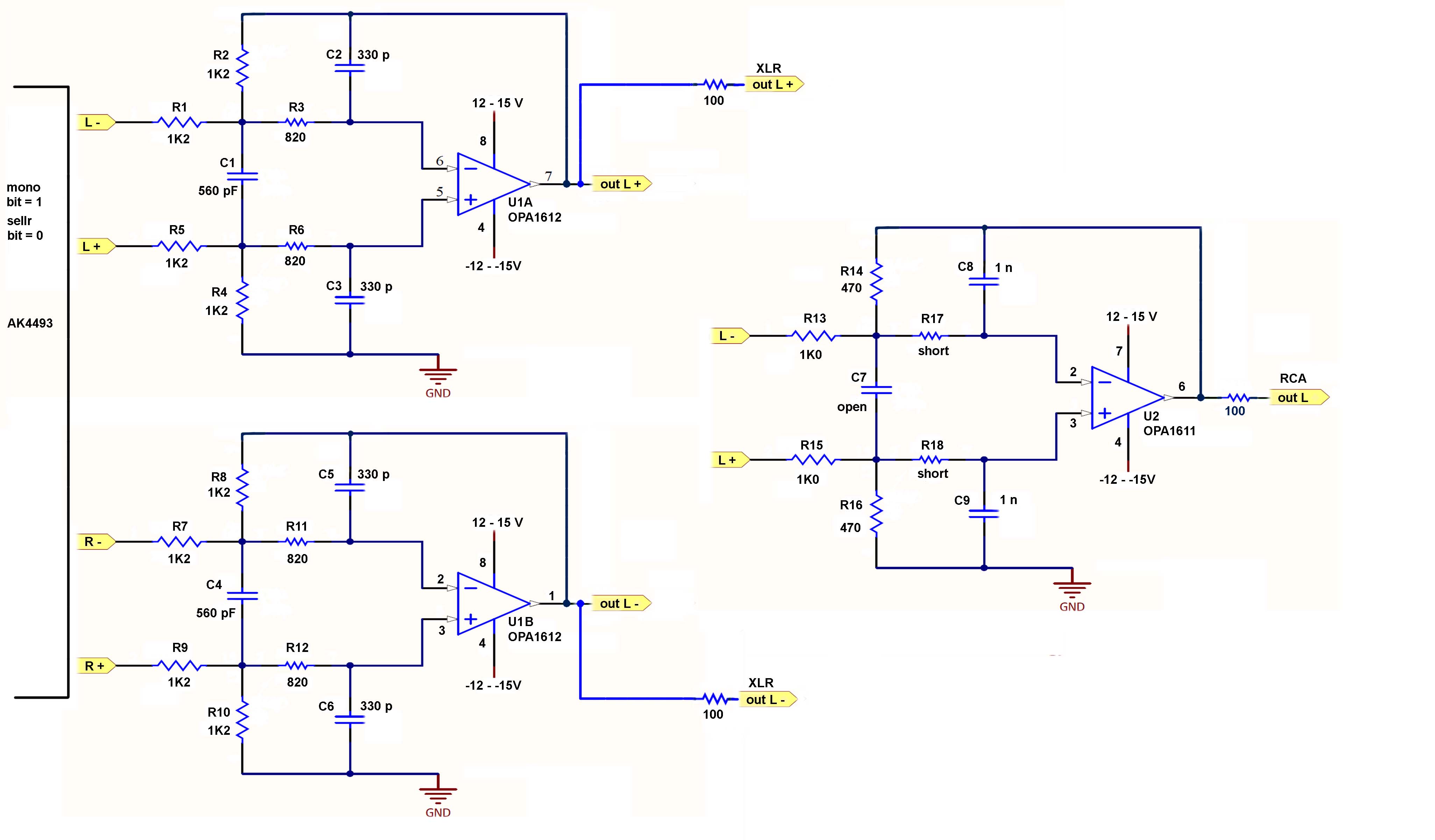

would you please check out this output for dual mono AK4493
Please correct errors and give your recommendation
only one channel Is presented

The XLR outputs are wired wrong. I recommend you read the paper by bruno putzeys about getting your audio off the ground. You'll realise why it's a mistake!
I'm not sure what the maximum output current is of the 4493 DAC. Lower resistor values = lower noise, but also higher load for the DAC (high current draw leads to distortion). Though it looks fine to me.
I would also simulate it in TINA TI or LTspice or something among the likes. They will tell you whether it does what you expect it to do. Sorry I am not going to calculate the Fc and Q of the filters. I'm a bit lazy (read busy with other things) today. My filter has a Fc of ~100k and a Q of 0.5. A low Q is essential for goot transient response.
Also I would ground the signal reference somewhere close to the decoupling capacitors of the opamps.

first stage fc Is around 330 kHz and Q bellow 0.5, same for balanced to single ended differential op amp
I will try to do research In getting audio off the ground even though I am curious about what would bring

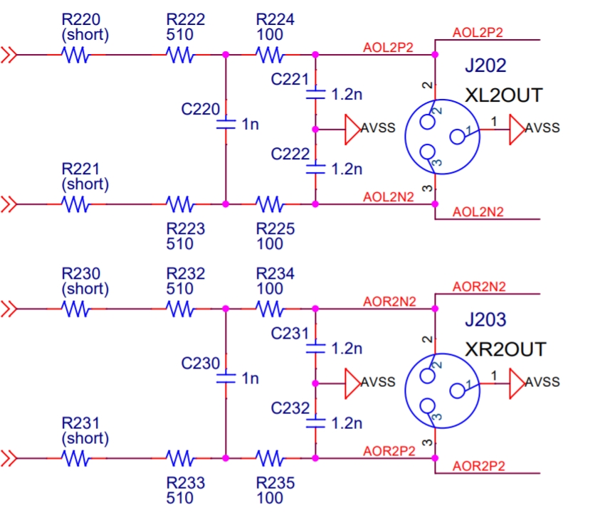

From your schematic a few posts up, looks like you have decided that much more filtering is needed for the unbalnaced outputs than for the balanced ones. That doesn't seem quite right to me. Last time I looked, ESS and AKM were both doing very similar things to add some passive filtering to unbalanced outputs after the first opamp stage. For one example, please see the attached schematic below.
Also, for the AK4499 eval board the passive filter caps appear to be SMD film and the resistors are through-hole, similar looking to Dale resistors (e.g. RN65) sometimes favored for hi-fi audio.

Actually, I read the schematic wrong. I didn't realise you were going for dual mono. The XLR is wired correctly then. The document about getting your audio off the ground is still a fantastic read regardless though.
I'm not sure at what point the dac starts to become super noisy. The eval module uses a Fc of 100k hence I use the same.
I would try to put the RCA output after the XLR output. Otherwise your outputs are loaded unevenly. It also lowers component count, because you need less capacitors 😉.

The ESS and AK4499 are current output DAC's and thus have a vastly different outputstage. The output stage recommended by AKM for the AK4493 is a non-balanced differential output stage. I wouldn't take their designs TOO seriously on this aspect.
As for filter caps I would highly recommend C0G/NP0 caps for their excellent linearity and low microphonics. For resistors I would use thin film resistors. Vishay makes excellent stuff, not always the cheapest. Though I rather spend 20 bucks more on a great product than have a generic product.
@hidjedewitje,
I agree that the first stage in the dacs I mentioned are I/V converters rather than differential summing multi-feedback filters. Since the is one more active pole in the latter first stage, residual RF from the dac outputs may be somewhat less (among other differences). My point was that one of the reasons SD dacs may not sound as good as they otherwise might is because of insufficient filtering of RF from the outputs. The RF may or may not cause issues in downstream equipment. If in fact there is remaining RF that needs filtering, which is suggested by samoloko's second stage for the unbalanced outputs, then there is probably also remaining RF that should be filtered from the balanced outputs. A passive filter offers 'real' poles and may produce less distortion in that position than an active filter might. Of course, everything depends on the particulars of a given dac chip and the surrounding implementation. Its up to the designer to figure out how much of what processing will be optimal for the project's design goals. 🙂

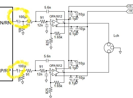

But I've measured DC at outputs and it is 2.5V to GND... Here is a topic with a similar question and here some quotes:
No it's not. That's why it should be biased to half of the positive rail. And that's why we need capacitor to block the DC at the output.
You do understand that the capacitors are necessary for the circuit on page 24 to function correctly. The circuit in example 1 on page 23 is shown without capacitors because it does not need them. If you use the '1632 as shown on page 24 you will need the caps and if as shown on page 23 you will not.
So, why coupling caps are not needed in this case I can't understand

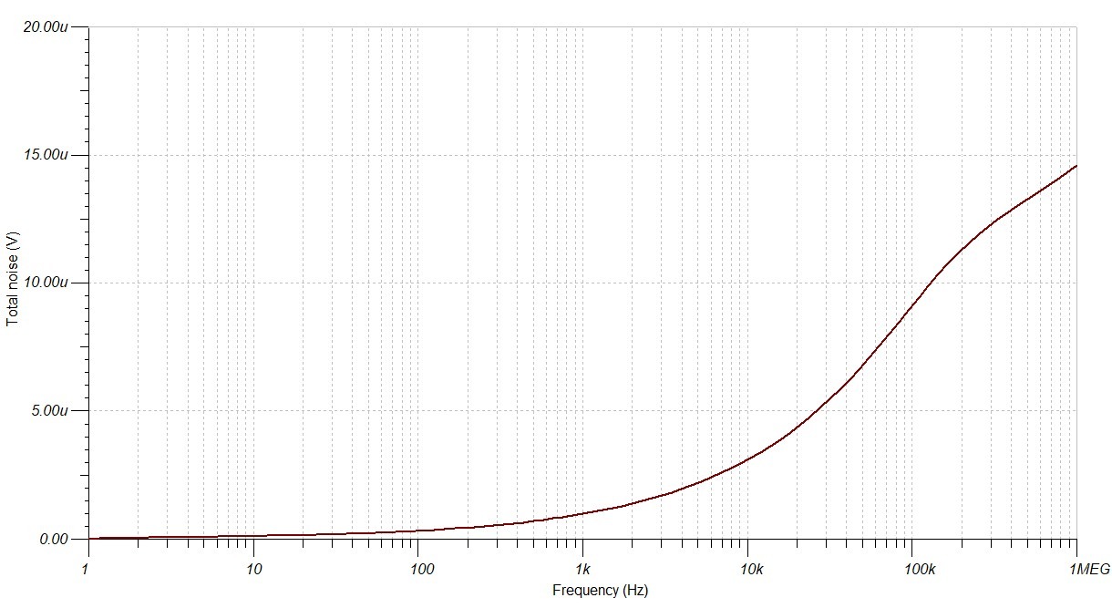

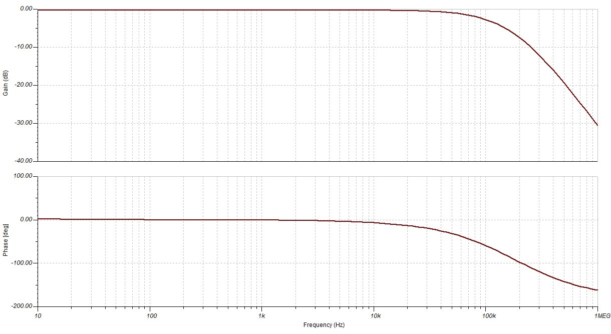

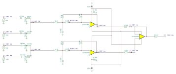

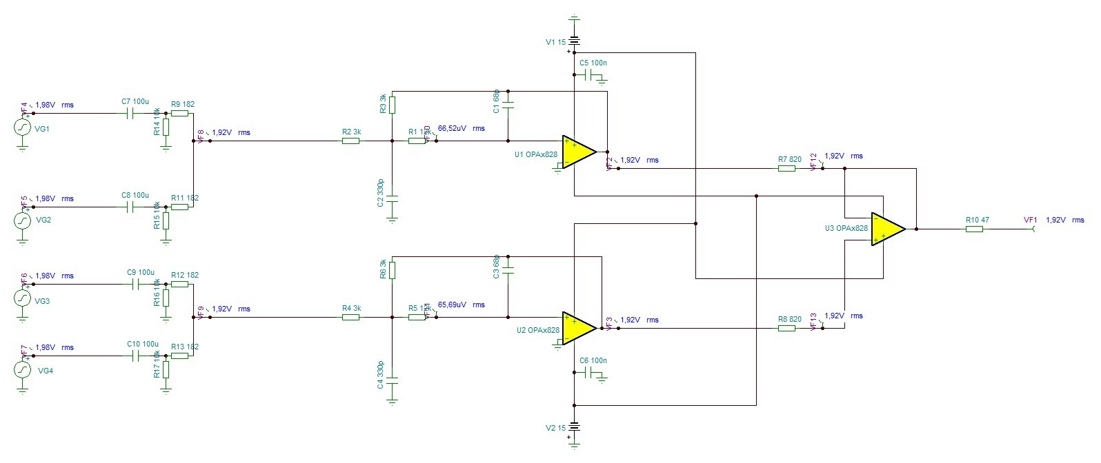

Witam, zaprojektowałem przedwzmacniacz do AK4493 mono. Jestem początkujący, więc proszę o swoją analizę i wszelkie możliwe sugestie. Nie mam pojęcia czy napięcia wejściowe są prawidłowe (2,8Vpp)? . VG3 i VG4 są przesunięte o 180 stopni. Z moich obliczeń fc=177075Hz i Q=0,49
:cop:Translated:
Hello, I designed a preamplifier for the AK4493 mono. I'm a beginner, so please give me your analysis and any possible suggestions. I have no idea if the input voltages are correct (2.8Vpp)? . VG3 and VG4 are offset by 180 degrees. From my calculations fc=177075Hz and Q=0.49
sznobel
This is an English language forum only. I used Google translate to read your post. Google says the English translation is:
"...Hello, I designed a preamplifier for the AK4493 mono. I'm a beginner, so I'm asking for your analysis and any possible suggestions. I have no idea if the input voltages are correct (2.8Vpp)? . VG3 and VG4 are offset by 180 degrees. From my calculations fc=177075Hz a..."
Regarding your schematic, the circuit can't work properly. The output opamp feedback path will cause it to ignore the signal from the first opamp on top.
