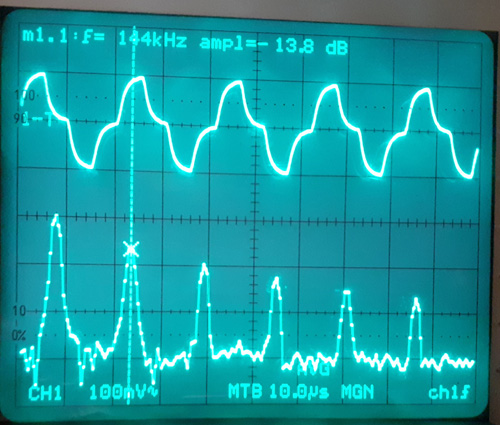

Comparison for AK4490 at 192kHz SR (quad), fs/4 signal, Slow vs. NOS filter, MCLK 24.5MHz.
"Slow" results in 8 segment per cycle, NOS in 4. H3 and and H5 are well reduced. The difference to NOS is some 30dB.
This suggests that an (external) working FIR at oct/hex rates would achieve similar amounts of reduction of H3 and H5, making life easier for the analog filter. AKMs can run external filters, too...

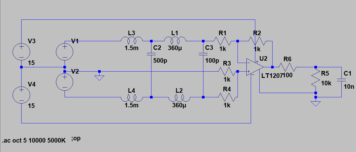

I had great success with a passive 4 pole L/C filter on the output of an AK4490 DAC. I have long been suspicious of using an active analog filter to filter in a band where its loop gain is rapidly approaching zero. The ferrite inductors from coilcraft worked fine, did not add measurable distortion and had a nice small footprint. It removed the image above the sampling frequency to much better than 80 dB. The analog filter on the demo board did not.

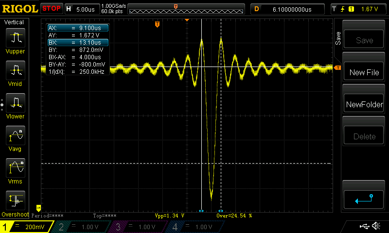

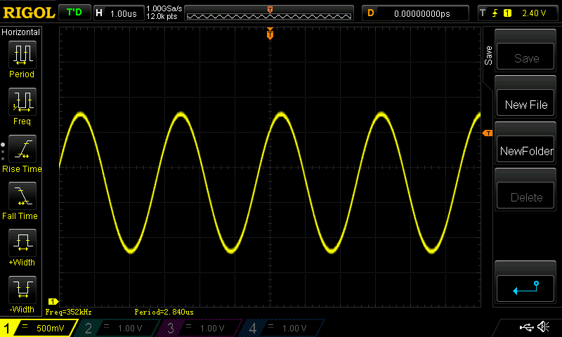

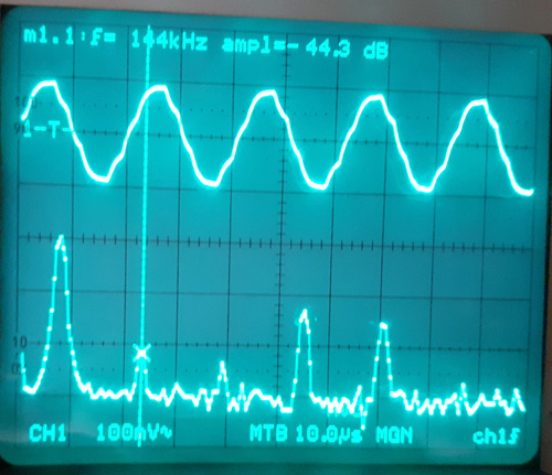

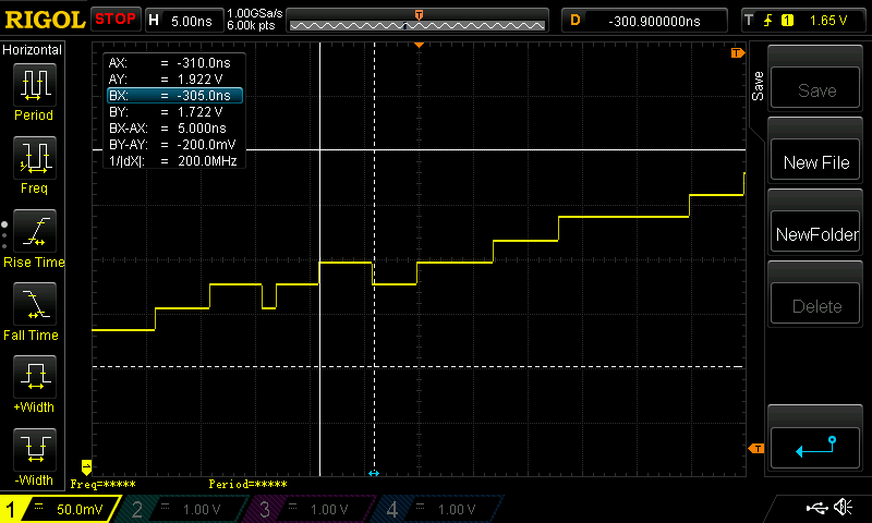

ES9038Q2M, 768kHz fs, MCLK fsx128 = 89MHz, brickwall filter. Sine 350kHz, probed directly at the chip output, no analog filter. That does not look like a "refurbished" 192kHz chip 🙂
At fs 855kHz (MCLK 106MHz) the output is already broken, as specified in the datasheet (MCLK max 100MHz).

The ES9038Q2M measurement looks very good.
What does the second figure show? Is it a zoomed view of the first one?
Have you measured the frequency response or at least cheched at a few points that it is flat?
I assume by the way, that you mean MCLK = 98 MHz, not 89 MHz.
Those steps are probably sampling of my digital scope. Visually I could not identify any steps at slower time base. Wideband spectrum measurement would probably show some. IIRC IVX measured some stronger MCLK content which would be perfectly fine at 128xFS.
It should have been analog to pictures in https://www.diyaudio.com/forums/equ...-oversampling-filter-issue-4.html#post6659154 but see my previous post.
Not yet. I went closer to fs/2 where the brickwall filter started affecting amplitude (correctly). But the waveform was still correct, the brickwall filter works OK.
Yes, thanks for the correction. 768kHz * 128 = 98.3MHz. The cause: I had my calculator switched to hexadecimal 🙂

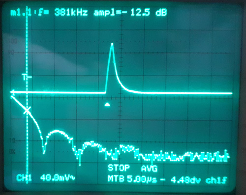

Now that looks very good! No FFT needed.
Does this suggest that the ESS FIR is operating at DS-modulator frequency, or at least they don't use a S/H at the DS input? I think so.

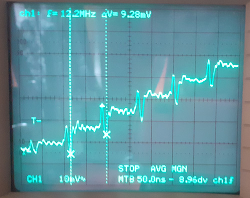

In the dirac output of the 4490 I can see 16 steps which would match the 16x S/H stage as known from the 439x internal diagram.
It for sure will beat this ;-)
At these pulse lengths the SC-filter is still integrating and hence the waveform is more like linear interpolation than Dirac-delta which helps spectrum.
You cursor readout shows 1.5 periods, so actual sinc freq. is more like 250Khz*1.5=375kHz and the shape suggests true brickwalling. Quite a difference.
