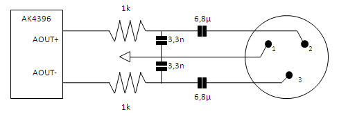

While I am waiting for my 1543 DAC from HK, I did some research on my Emu 0404 USB. Sound is not bad but not the crown in audio.
So I found some passive approaches for the output stage just to omit the opamps.

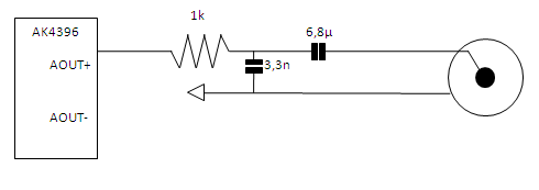

In the datasheet is reported that Aout+ and Aout- is 2.8Vpp each so in addition you'll get 5.6pp or 2Vrms if you're going symmetrical. That's my problem!
I need unbalanced connection and so my question arose: is there a (passive) possibility to keep the 5.6Vpp for unbalanced output?
The XLR solution could be:
No filter needed

You should never use the output of the DAC-chip directly. These are normally very sensitive to the load (Even though the Zout is low).
Also, you should never use onle the 1 of the outputs of a differential DAC, to have a simple solution to the single-ended output. You have to use a differential-to-single-ended converter.
Doing as above, you will never ever discover the potential in a DAC like the AK4396.
Look at page 34 on the AK4396 datasheet:
AK4396 datasheet
This is the simple approch to diff-single-ended conversion, using a single op-amp. I must emphasis, that this is NOT the best solution, but it is way better the above!
The best solution is a discrete design, prefferable with no negative feedback. Search the forum, and you will find many of these.

Hi Hurtig
is fig. 17 (3 opamps) so much better than fig.16 (1 opamp)? What are the differences?

About the 2 different schematics in the AKM datasheet. No, the 2nd one is not better. I just gives you balanced output to. But it is still an op-amp, follow by another op-amp. Not that good.
You could get OK results from trying different op-amps. But it's still an op-amp and sounds just like it.
I would go for a discrete analog stage using NO negative feedback.
If you do choose an op-amp, my suggestion is the old fashion NE5534. If you can get the "A" version it's even better.
