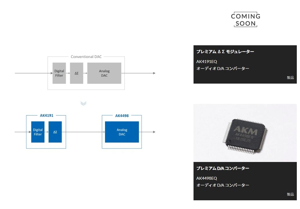

AK4191EQ
Looks like it could be the digital front end for something like AK4499, but apparently with enhanced specifications. Not a complete dac though. Made to be used with AK4498.
From a Japanese website and translated by google:
"AKM's new DAC may be the answer we expect. AK4191EQ and AK4498EQ split the traditional DAC's digital filtering & delta sigma modulation and analog parts to reduce the interference between the digital and analog parts. The general idea is similar to removing the current-voltage conversion with the AK4499EQ. The more scattered the better, moderately reduce the degree of integration to reduce signal interference. As for the indicator, it is inconvenient to directly compare with the AK4499EQ because it is split into two parts."

Clay,
Agreed. Also , having the opportunity to tap earlier into the signal at a point of greater DR and lower distortion can be an advantage. (SN / THD = -153dB).
TCD
That's still in the digital domain, I'm not sure you understand what you are talking about here. By that logic, AK4137 and CS8421 already allow this.
I know exactly what I'm talking about.
The ASRC's you have mentioned a/ OP I2S or in the 4137's case also DSD (1
bit) b/ remove jitter and actually encode it below the rejection CF (depending
on how they are configured).
The 4191 allows access to multi bit OP's after the modulator. We won't know
exactly what features that will include till a more detailed data sheet is
available but suffice to say this chip could drive a multi bit (unity weighted)
discrete DAC OP stage be it resistor or CCS.
It may end up having some advanced features such as RTZ encoding or
other algorithms to linearise the OP DAC. There are white papers (not akm)
kicking around on the various OP coding schemes.
TCD

"Tap into the signal at a point of greater DR and lower distortion". Sure sounds like you were confused and talking about an analog signal.
Surely, you must know that the original digital data before it was passed through ANY of those blocks is "a point of greater DR and lower distortion". It would be possible to develop your own on a PC or in an FPGA and do better than AK4191. Claiming that processing that adds distortion is a point of lower distortion is nonsensical.
Further, without knowing what the contribution of the digital portion of integrated DACs are, how do you know it's lower than what is out there? What if CS43198 or ES9038 performed better?
Maybe you do understand and it's just poor wording / semantics. Either way, to me, the interesting part here is the AK4498, not the AK4191. The AK4191 is virtually useless without the AK4498. The AK4498 can now do what Mark has dreamed of and completely DIY the modulator in a clean fashion.
No confusion here 🙂
Are you just arguing for the sake of it? (probably... 🙂 )
OK - I will spell it out in very simple terms.....
OP of DAC (chip) absolute best = THD -124, DR = -140 (mono)
OP of modulator THD / DR = -153dB
You got it?

WRT 4498, interesting in that they have gone back to pre resistor weighted
architecture (4499) to the switched cap / cmos opamp style AKA4497.
It's certainly easier to work with.
TCD

Do you think AK4191EQ converts pcm signals to 1 bit dsd at output?
The block diagram certainly wouldn't seem to suggest so (all the remains for the AK4498 to do would appear to be synchronous switched capacitors filter and other analog stuff). Why would one do something stupid like that anyway? Lipshitz/Vanderkooy showed that pure 1-bit streams have issues with transparency years ago.
