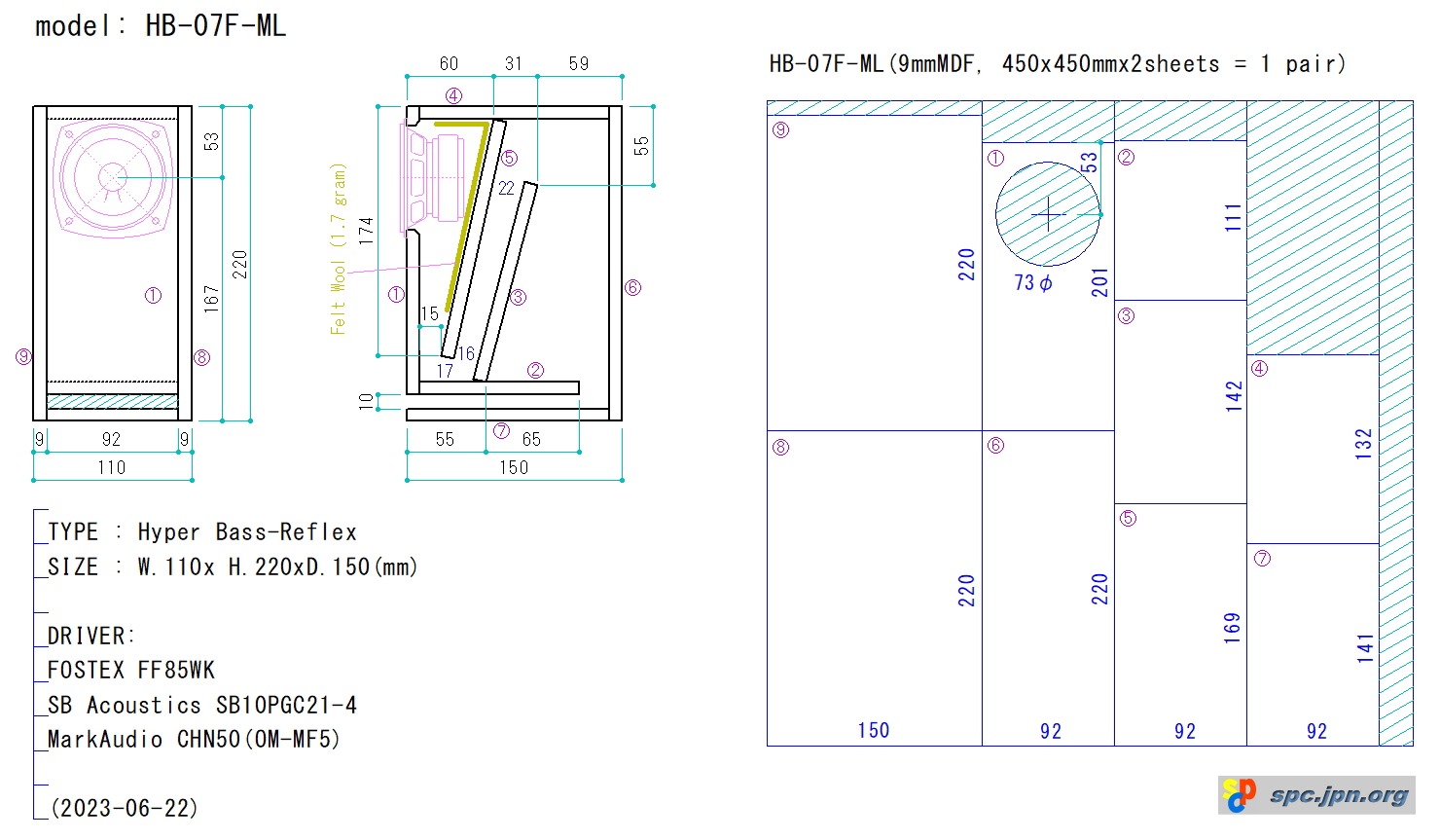

AIYIMA YM91R20-2F-ZXJ-L1 (3", full range) installed in HB-07F-ML (double bass reflex).
It is a low-priced product, but it has a die-cast basket and neodymium magnet.
The sound quality is better than the price. Cost performance is high.

What is the technical idea behind this enclosure?
I understand it is bass reflex, but what is the rest?
Can it be used really with listed drivers what have so different T/S parameters?
Can it be used with Alpair 5.3?
The system is double bass reflex.
Fewer opposing surfaces reduce standing waves and the use of sound-absorbing materials is reduced.
I do not own Aplair 5.3, but Alpair 5.2 sounds very good.
You can use it without worrying about T/S parameter.
Reactions: circu
