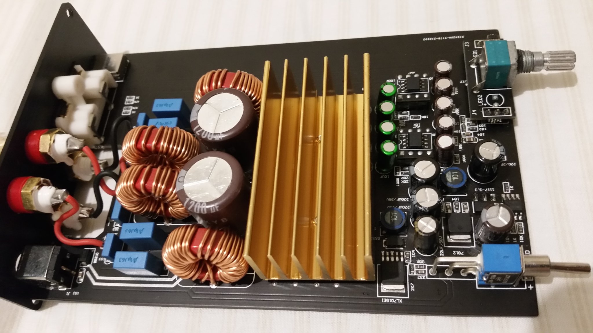

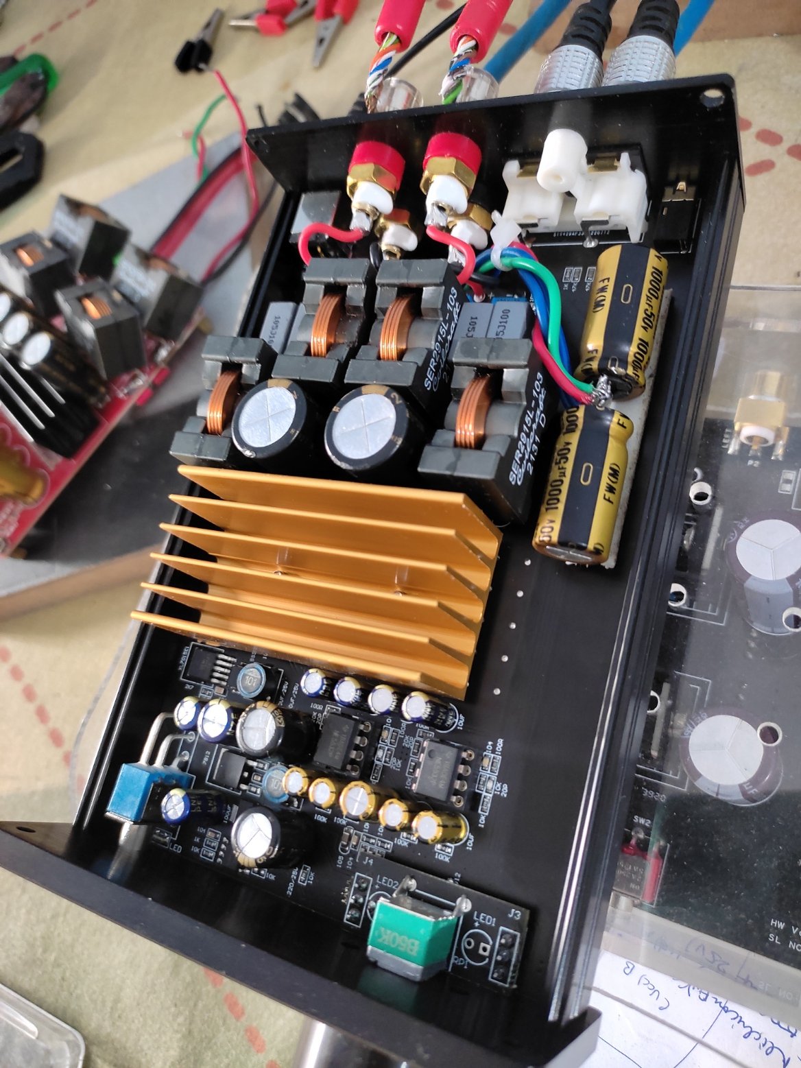

I totally understand. Thought, i should add my findings here since it wasn't mentioned before in this thread.It sounds like a lot of work, well done.
Without pix and numbers on it it is difficult to follow what has been done sadly. Well, must confess that since I don't own such a unit and it has been ages it would probably make no difference to mu understanding anyway, so don't waste time on this. Further, it appears this unit had quite a few variations along its production time, so what was true on the 3 units we tweaked might not necessarly be on other units. But these productions variations were quite small and after all this is DIY.
This is exactly how i have done on my unit other than the PS caps which have an extension with decently thick wires.- When you bypass caps, it is important to keep distance / wires as short as possible. Locating elsewhere the remote bypass can be fine under some circumstances but seldom so, it needs consideration (ESR & Co, time constant). Apart from the 2 main PS caps, it is IMHO for this unit best in most cases to bypass at the pins directly (somainly under the board). It also enables quick fitting and removing if you don't have 2 identical amps to try to assess the sonic variations.
The cap i was talking about was the middle one out of the 5 before the OPamp. I felt since bypass works great on this position (as per your finding), why not to replace it completely with a quality film cap. But that was a blunder. No bipolar for that position now as per my terrible experience. It was changed from 10uF electro polar to 2.2 uF bipolar to finally 100uF electro polar. Ans everything is fine now.=> I bet so, LOL!
Well, one needs to understand what the caps are doing and what value can be used. I don't know what cap you mean and have really no time for it, but you were lucky if you replaced a 100uF with a 2.2uF without damage. Not saying it can't be done, again all depends what the cap stands for initialy, but they can be some issues re bandpass (RC filter), buffering, instability due to wrong value... behaviours where time constant plays a role and it works and then no more after a certain time. Having said that, what you describe could also be due a a bad connection / soldering point, so who knows... important is everything is back in place. Please try to refer to my comments in the past on this cap: IF (??) I did some back then or touched it and it was senstivie I for sure put some comments.
The value of ceramics used on the board is lesser than as on TPA 3255 datasheet. So, i guess i will be fine. I have done this successfully on my TPA 3116 boards.=> Some is true of course but I would advise you look at the chip's sheet to make sure you don't overdo it re min requirements, just in case...

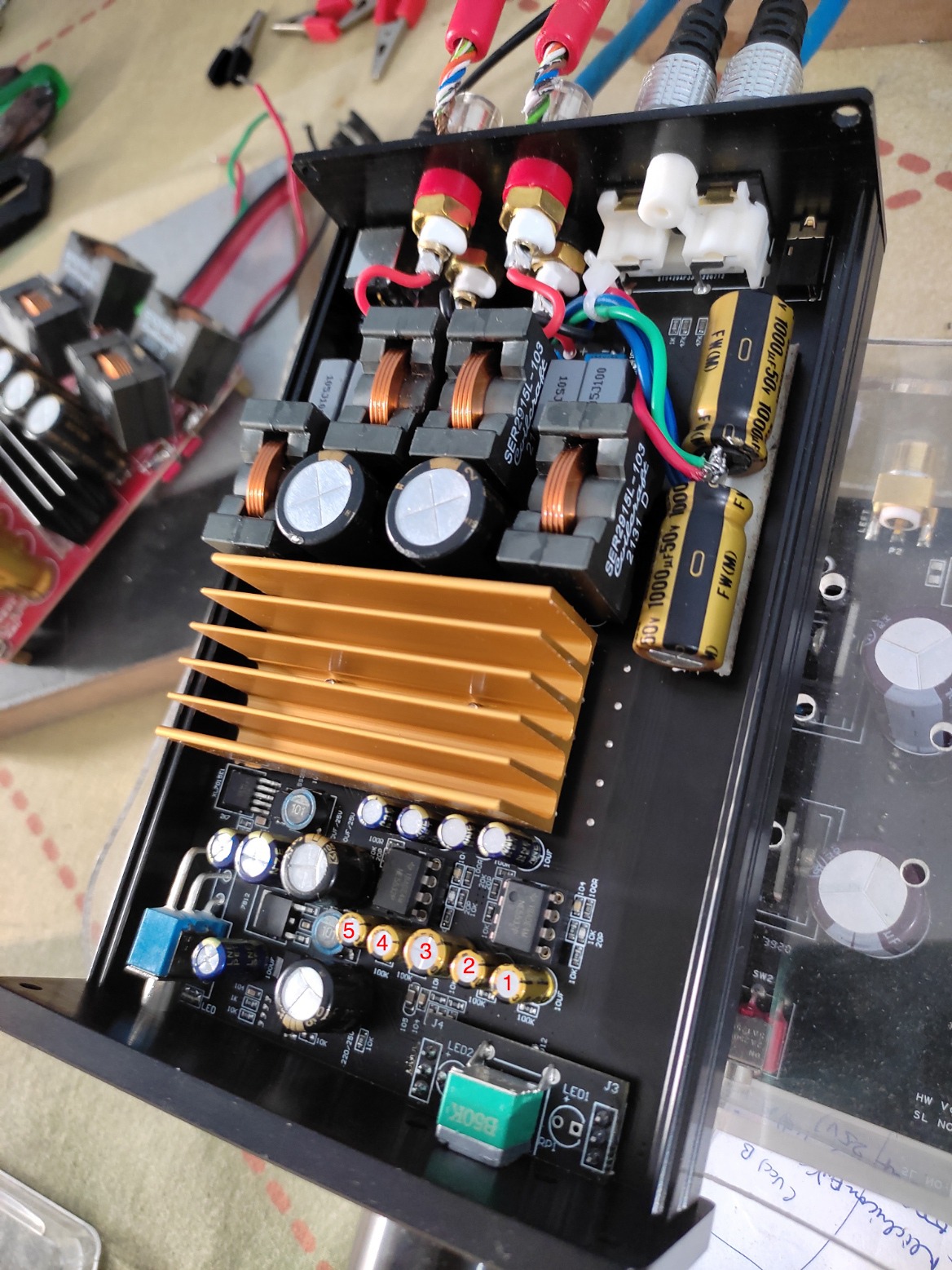

Hello,
I had A04, a green pcb that came with fake NE5532 and 4 gold Nichicon 10uf no serial(not FG FW) before the heatsink also fake.
I changed for LME49720 and those 4 fakes for Nichicon UES and the foggy and bad stock sound became clear, transparent and neutral, I changed back for Elna silmic and it took several weeks for the clear and transparent sound to appear but softer and warmer than UES , with more delicate and open highs.
With that experience I now have A07, and I changed all the electrolytic capacitors before the heatsink also with Panasonic but FR.
I use opa1656 with 4 Nichicon UES and 5 Elnas before the opa.
Now it's sharper and more transparent, it still took weeks for the sound to open up.
For another A07 I would use 4 Elnas in that position and UES or Elna before the opa for a totally different sound

Nice ! I have my order of Elna Silmic II 4.7 uF 50V on mouser as well for those 4 caps in the coupling position. Elna Silmic II's have usually upto 150 hr of burn in time as reported by many who have used them in their gears. But it's nice to hear that your Elna's are now sounding clear & transparent. I havn't tried Elna's before but so thought of giving it a try. I have tried Nichicon ES in my other amplifier build but it didn't had that hi-fi highs. Even bypassing it with wima didn't helped much. My 0.5$ MKP cap was much better than that so i replaced them with MKP ones. ES ones have great vocals but highs are pretty rolled off. On the other hand Nichicon KZ has airy & very nice high end. It doesn't feel that I am loosing any detail with them. I have used myself those in other builds and in this as well on the power decoupling caps position. I guess those will be a perfect combo for those 5 elnas before the OPA. Best of both worlds.Hello,

For the caps before heatsink on power side , i guess Panasonic FR are excellent choice. I have used FM myself since i had those beforehand but FR should be little bit better. For this position FM performed better than Nichicon FW, FG, KZ, Kemet A750 polymer caps and many others.
Since FR upgarde is already in place, i don't think you will gain as much as reported in this thread after OPA PS bypass. But still a very simple mod & worth trying. Even a simple Wima 0.1 uF MKP with a small 4.7-10 uF electrolytic will play nicely.
While looking closely i noticed that couple of your ES are mounted in opposite direction as opposed to other two. Even though they are bipolar they have different lead length to denote the outer foil. I don't know how much it will make a difference to the sound but ideally they should be mounted in same orientation.
I might be completely wrong but i have found that even though Panasonic FM & FR in decoupling position (or bypass at power pins of OPA) provided an instant upgrade in terms of richness of sound the sound was rather flat & 2d like as opposed to Nichicon KZ (more 3d stage). I might swap my Panasonic FM out of the chain and rather replace them with KZ or PW in future if i felt like this for so long.

That's why I changed the UES to Elna silmic on the A04, the treble never opened up. With Elna it was the opposite, although it took time.
Outside of that, I think UES sounds great, and I took a chance on using it on the A07, but in conjunction with Elna, and it worked great.
I think it's because of the influence of Elna or the opa1656 combined, or maybe A07 has better treble than A04.
I use the 10uf 25v UES and put the shorter leg as negative. Elna's value is 10uf 35v, I wanted to try KZ but they are 8mm in 10 and 22uf.

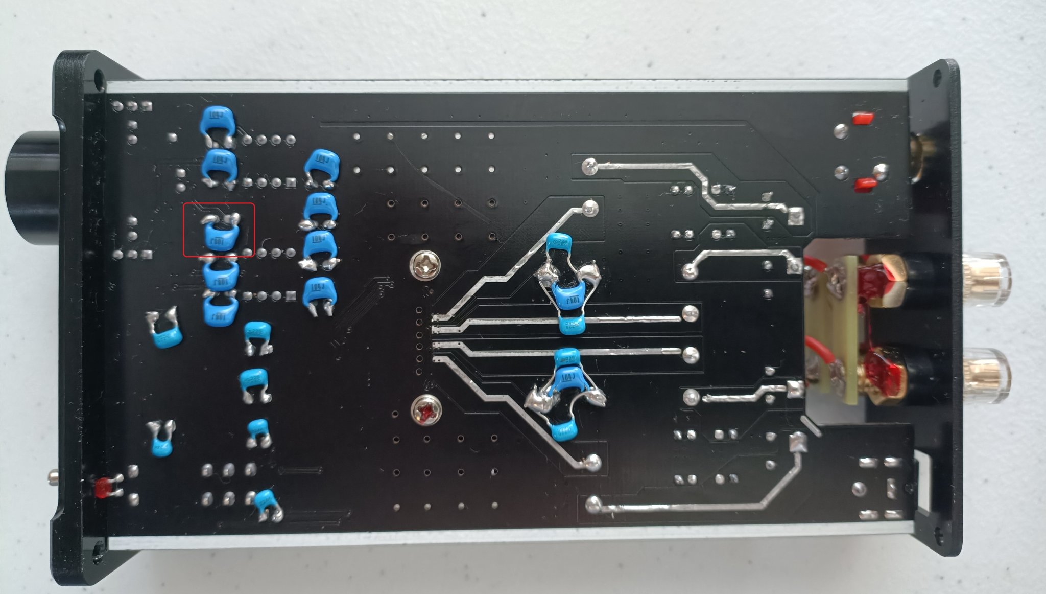

I had a similar experience with the Aiyima A04 where the right channel started to sound weird/lower than the left channel.
I previously added bypasses (0.1uF MLCC C0G) to all the coupling capacitors (the 5 before Opamps and the 4 after the Opamps).
In the end I decided to remove the bypass from the center capacitor of the 5 before the Opamps and now everything sounds nice again.
Then I decided to trace all the connections(Opamp pins and capacitors) and I realized how they work:
The Positive RCA Signal (L/F) passthrough a 1K resistors before getting into the POT input. The Pot outputs go into Capacitors 2 and 5 (positive lead) and then go into Opamp Pin 2 (1IN-) on each Opamp.
The negative(ground) RCA signal go into Capacitor 3 (positive Lead) and from there it goes into both Opamps Pins 3 and 5 (1IN+ and 2IN+). The 1OUT(pin 1) from each Opamp go into Pin6(2IN-) via a 100ohm resistor, and also go to Post-Opamp(amplifier coupling) Capacitor 1 and 3(from the second Opamp).
The 2OUT pin 7 from each opamp go into Post-Opamp Capacitors 2 and 4.
Basically what the Opamps do is to take the Input signal and invert it and then get that inverted signal into the second section of the Opamp to produce the "positive" signal.
1Out=(1IN+) - (1IN-) = 0-Input Signal = Input Signal Inverted which goes into 2IN-
Then:
2Out= (2IN+) - (2IN-) = 0 - (-Input Signal) = Input Signal.
Both Outputs go into the Chipamp coupling capacitors for the Positive and Negative Differential inputs into the Amplifier.
I don't know if there is some kind of extra gain on the Opamp section, but even if there is then it would be done on the first section (where the first inversion is done). Other way the signal amplitude for both Output 1 and 2 won't be equal.

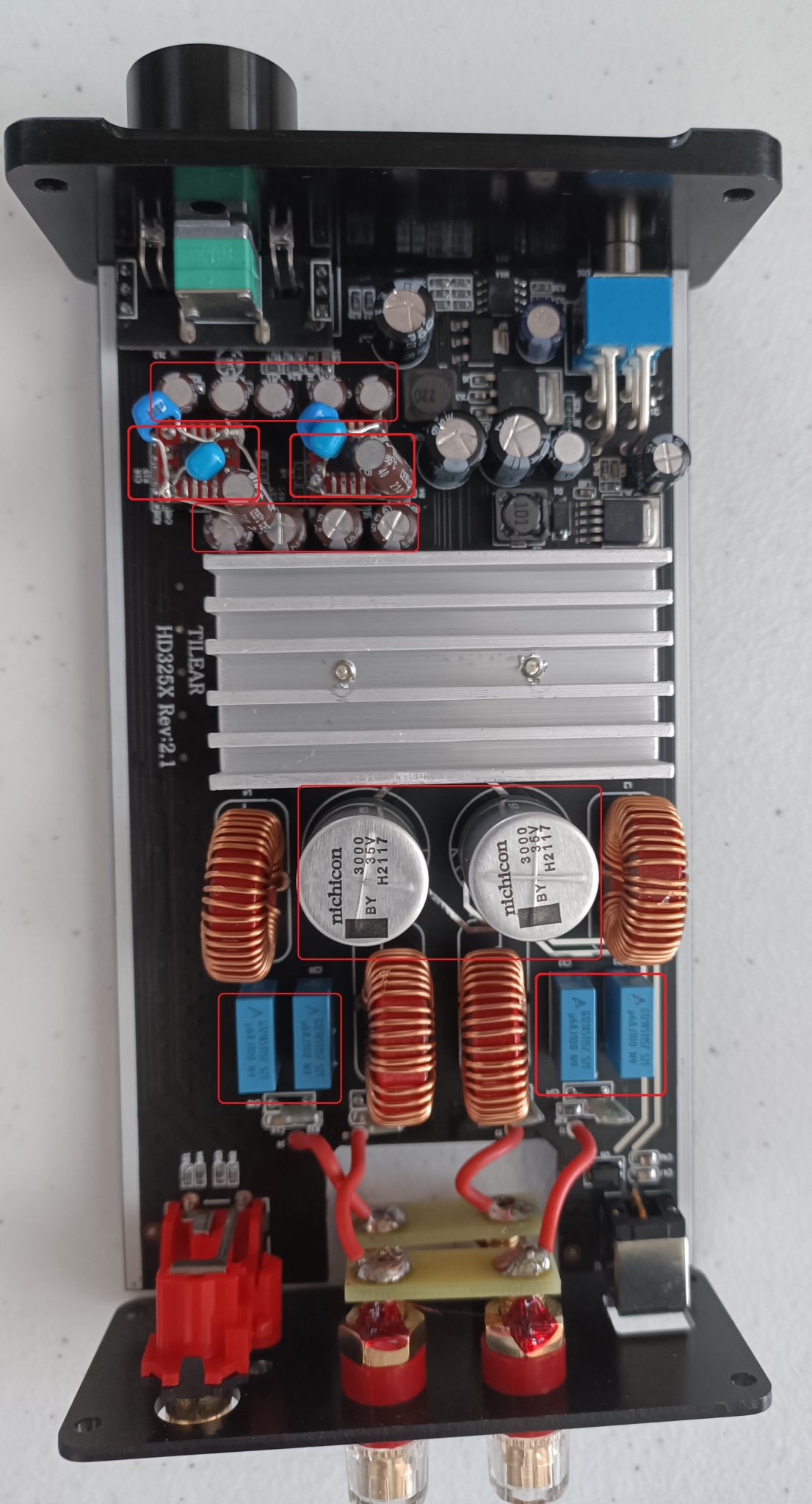

Thank you for your comments on the Center Capacitor(Capacitor 3 of the 5 before the opamp). It made me realized the solution for the issue I was having after I installed the bypasses.Though this is for A07, i think the layout is pretty much the same as A04. Capacitor marked 1 is responsible for OPAmp power supply. Capacitor 2 shows continuity with Capacitor 1. So i changed them to Panasonic FM 220uF 35V (fits fine). For this position i have tried Nichicon KZ, Pana FM, Nichicon FW and few other but Pana FM was clearly the best audibly even with the stock NE 5532 (might be due to high ripple current as opposed to Samwha WF it replaced). I have the Cap 1 bypassed with Vishay MKT 370 0.22uF as well. Under the board the OPAamp VCC & GND is further bypassed with Wima FKS2 1500pF x 2 each, so 3000 pF in total. The OPA 1656 is in order & am looking forward to bypass the top terminals with a small size Pana FM electro &/or Wima 0.033uF FKP2 (largest size available).
The 5 caps before OPA has been changed to Nichicon FW (can't say if they made any significant difference). The 1st & 4th cap from the bottom right has been bypassed with wima 0.01 uf (just because i had them laying around). The middle of the 5 caps near the OPAmp has been changed to 100uF 35V. Previously i had completely removed the cap in that position and replaced it with Wee WME 2.2uF film cap. I saw some weird behaviour, the sound quality changed for very good initially then after some time the sound changed to mono like (like am listening to bluetooth speaker) with no seperation. And occasionaly right channel will stop working. I almost got a mini stroke. Changed back to NIchicon FW 100uf 35V. Everything back to normal ! Big Relief !!!
Based on your suggestion & mine initial experience as well i bypassed them with Wima but felt the soundstage collapsed & became somehow narrow, don't know if this was real or my bad experience with full film cap replacement tricking my mind but i finally removed the bypass. So, no bypass in this position now.
The four caps on the output side of OPA i am contemplating to change but am confused between Nichicon ES, Nichicon FG or Elna Silmic II. But thinking of doing this once i have my OPA 1656 in the place since that would define a better route in which would i like to go depending on their sonic signature (also as per your report no significant benefits). No bypass on these four caps as of yet.
Prior to these I changed the coils to Coilcraft 10uH (since i had them with me & they made significant upgrade in my TPA 3116 amp when i did it). Its pretty neat & is very firm. I am not able to compare the improvements made since most of the mods were done in a go & it's hard to imagine how the amp sounded in stock. but change must be very positive. The DC caps has been changed to Nichicon KZ 220uF 50V x2 (since these were my fav caps on other TPA 3116 board, based on various choices i tried) on the board & bypassed with extended wire to Nichicon FW 1000uf X 2. I didn't noticed any change with the increase in capacitance (might be due to my less demanding needs for wattage). Nichicon KZ is bypassed below the board with 0.22 uF Vishay MKT 370. I don't want to go crazy on bypass in this position since i am very happy with KZ sound signature & heavy bypass will alter that sparkly HF am getting. I am contemplating the idea to bypass those 4 small ceramics close to the chip itself with some FKS2 (or FKP2 if slim enough) since they fit inside the cavity of heatsink just fine so will be much beneficial than heavy bypassing on the power caps lead out. Also FKP2 or FKS2 have a much lower DF compared to MKT or MKP types being a foil cap and are much suited for pulse duty. So even a smaller value can outperform a larger value MKT or MKP.
After all these mods i really have no idea how much the sound have changed since i have no memory of what the amp sounded in stock (i almost jumped on modding it, considering how much difference it made on my other TPA 3116 amp) but irrespective of that, it just sounds very very good. Very much close to my reference DIY amp with even better low end. Am just hoping that OPA 1656 chip brings further sonic improvements.
Now everything sounds perfect, and the audio from the right channel does not drop anymore.

Glad it helped ! My main purpose of posting my findings was due to the reason that it was completely opposite of what was suggested in the thread (bypassing the middle one gave most benefits). Since then i removed all the bypass and re-did one by one making sure i do it based on my liking rather than just copying some tried formula. I am on A07 but i don't see why Aiyima will deviate from these fundamental design choices they used on A04. Also as per your findings in the previous post, you said the Cap 2 & 5 before the OPamp are the input coupling caps while the thread mention these as Cap 1 & 4 !! I guess some of the earlier statements in the thread were made prematurely or maybe there were very different batch samples which is very unlikely. I will reopen my unit tommorrow again to check on this. Thanks for pointing out.Thank you for your comments on the Center Capacitor(Capacitor 3 of the 5 before the opamp). It made me realized the solution for the issue I was having after I installed the bypasses.
Well, caps 2 and 5, and 1 and 4 could be the same caps depending on where you start counting:Glad it helped ! My main purpose of posting my findings was due to the reason that it was completely opposite of what was suggested in the thread (bypassing the middle one gave most benefits). Since then i removed all the bypass and re-did one by one making sure i do it based on my liking rather than just copying some tried formula. I am on A07 but i don't see why Aiyima will deviate from these fundamental design choices they used on A04. Also as per your findings in the previous post, you said the Cap 2 & 5 before the OPamp are the input coupling caps while the thread mention these as Cap 1 & 4 !! I guess some of the earlier statements in the thread were made prematurely or maybe there were very different batch samples which is very unlikely. I will reopen my unit tommorrow again to check on this. Thanks for pointing out.
1 2 3 4 5
5 4 3 2 1
Ahh I see 😆Well, caps 2 and 5, and 1 and 4 could be the same caps depending on where you start counting:
1 2 3 4 5
5 4 3 2 1
I followed the numbering as per the attachment.
So are the input coupling caps 2&5 or 1&4 ?
LOL. I counted from Left to Right. So, according to your image they are 4 and 1Ahh I see 😆
🤦♂️LOL. I counted from Left to Right. So, according to your image they are 4 and 1
