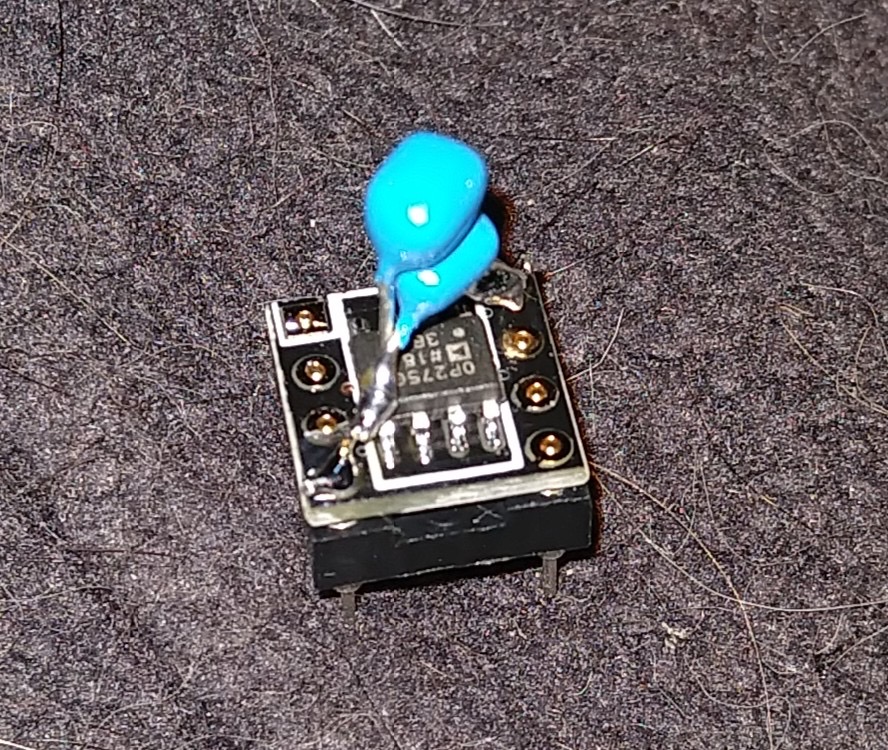

They fit fine in new dip8 sockets. Once you’ve used a larger pin size it stretches the socket’s holders. In older sockets that have had a lot of rolling activity I’ve had to use new dip8 sockets as intermediate mounting sockets in between the browndog adapters and the existing (soldered in) dip8 socket and full contact is made.

Claude, I’ve used browndog adapters for awhile now. They work fine in dip8 sockets that haven’t had a larger diameter pin inserted into them. I’ve also found that cheaper made sockets stretch out really easily compared to higher grade one that can be bought at Mouser or Digikey. Just the use of sockets (one that would normally be soldered into the boards) as intermediate mounts will help the situation .

The picture I posted shows browndog, then socket, then browndog in the socket.

Lester’s SOIC8 adapter (that he ships with his TPA3255 amps) uses really big pins. Anywhere I’ve used his SOIC8 adapter the socket has been stretched out and I’ve had to use other sockets as intermediary mounts so the browndog adapters fit in tightly.

Both. I’ll only swap out the socket on the PCB when I decide on which opamp to finally use. While testing/rolling I put the new socket into,the old one and the browndog into the new socket.
Pete
Ok, so in theory I can just buy new sockets and use them as quasi-adapters instead of having to replace them on the board? This PCB is rapidly reaching the end of how many more times it can be heated up. One of these times it will just fail. Im going to get a new board or new amp at some point I imagine. This was more a playground than a final product.

Yes, that theory is correct. That’s what I do now.
You can just buy the cheaper grade if that’s all you’re going to do for now.

Cool, thanks. Their all of $.80/ea on Digikey and I already have a cart with other stuff. If I get motivated enough to permanently attach them then I wont have to buy again. Plus, as a bonus, having a little extra space between the boards might make for attaching caps easier vs on top of the Brown Dogs.

Well, it will fail eventualy but heatcycles won't kill it yet. If you haven't yet touched the tracks around the OPA socket, then it will be a first and it is OK... it is not riskier than desoldering all the small caps you wanted to.
Repetitive actions on the same spot will though kill the trace sooner or later, depending how skilled and lucky you are.
Adapters on adapters, that's really not great re contact R, parasitic L and C, and hence for the sound. Probably better than nothing, but barely...
It’s not really hard to solder onto the top of the browndog..😉
Not a great pic but you get the idea.

Socket into socket... well, if you really manage to bound and force permanently your Brown Dogs into a socket, then I guess it could be acceptable... I have this on one of my test rigs, not the best thing I did but no choice as to allow various combos. So "Brown Dog with its pins bounded to a socket" assembly would go into the existing socket on the amp. Note it won't like it and you won't be able to remove and refit these easily or often a socket into socket is forcing things usualy, but well...

Touched the tracks? I swapped all 9 of the caps and have soldered ( a few different times) caps on the legs of the socket so I assume that counts as "touching".....lol
And yes, these 1656's are so loose you can basically "rattle" them around in the socket. Zero force needed to put them in, they just fall to the bottom of the socket. For sure they would fall out if I turned it over. There are all sorts of weird audio artifacts using them as is. Not even sure how to explain it, like RF noise maybe?
The browndogs are just inserted into the intermediate sockets. No soldering is involved unless I interpreted your sentence incorrectly.
