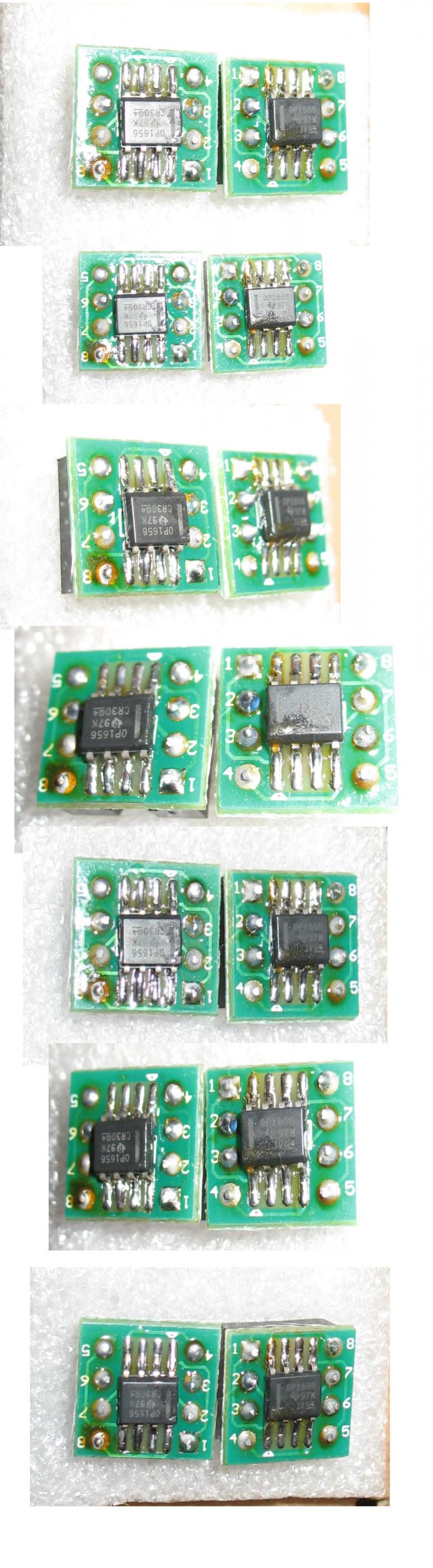

And yes, Op-amps are definitely a subjective taste. So many factors in play. I didnt "dislike" the OPA1656's, I just wasnt as in love with them as most and found the much simpler, cheaper LM4562's more to my liking. As I continue tweaking this amp though you can bet Ill reroll all of them. Im definitely doing the opa bypass as well as the others. Not sure I can find room for 20uf under the board though. I have the .01uf Muratas already and I also have some low ESL (ESR) .01uf's coming as well to try which may be even better than the Muratas, well see. As you suggested, Im a bit of a tinkerer and as this is a super cheap hobby Im happy to "waste" some money trying a bunch of different things.
You may well be right about the larger capacitance not making a difference but as dropping to 2200uf caps did I figure its a good experiment either way.
Yep, the additional OPA PS caps are best over the board, that is around or over the OPA... need indeed to be inventive, especially if you want to roll op amps.

Greetings... I have been doing a lot of reading on the Aiyima A04 and purchased one recently (green pcb) with the intentions of doing some minor modifications initially. I like what rhing suggested on touching up soldering joints and swapping out the op amp. Soldering the 1656 op amp on a Dip-8 adapter seemed a little to detailed for me, for now at least (small space for soldering). So, I purchased a pair already mounted on adapters from eBay. What I received, well I really am shocked that someone could sell this workmanship. But, I would appeal to some input to the attached image (of many photos). My thoughts are excessive heat, limited patience was implemented; I don't know if the op amps could have been damaged with excessive heat. Thank you...
My end goal with all of this is to get enough knowledge to build my own amp, potentially from scratch. Id also like to find/make a pwoper power supply for this. The Meanwell 200-36 looks very nice but I need something with a case. Still low on my priority list but Im certain a real power supply would help a lot vs the 32v 5a Aiyima one Im using.
