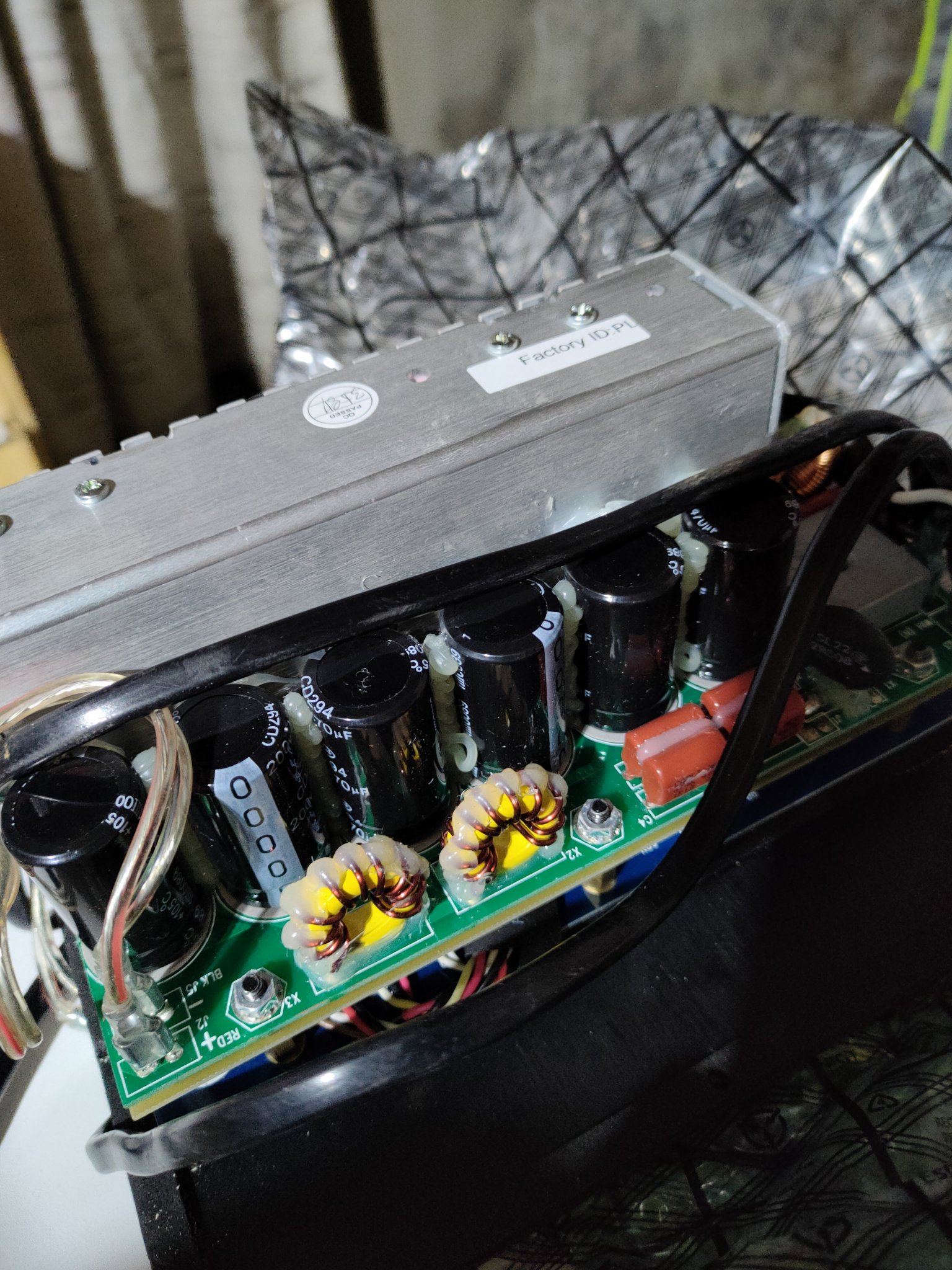

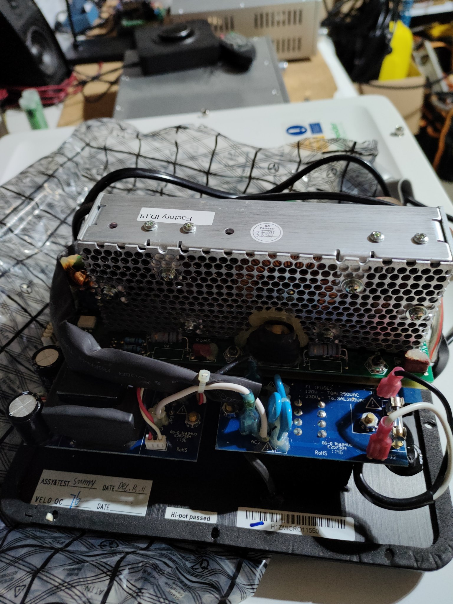

I bought velodyne microvee modules on alli 1 kw.... And they keep their promises... Women love it... it lifts their skirts and gives them chills....
1000kw at 4 ohms, 2000kw at peak. :hbeat::hbeat::hbeat:
