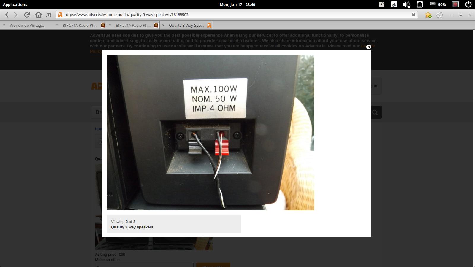

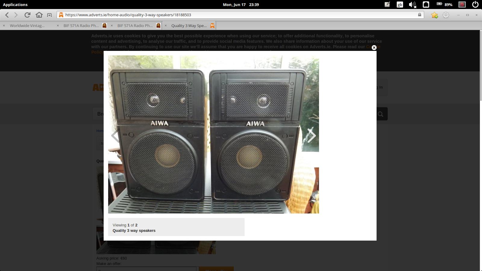

Can anyone identify the speakers in the picture, someone is selling a pair near me, if they are any good they would be a nice match for my mini compo series 22. I have been googling for ages to try and find them with no success, owner says there is no model number, maybe the grill can be removed, could be under the grill
Thanks in advance.

No, they are not good. The tweeter is a piezo, the enclosure is plastic, the crossover is a joke. Everything above 5 bucks is too much.
So you have heard these? Or are you just judging by the looks of them? Also what is the model number? Also what is wrong with plastic enclosure, there are some very decent speakers made
with plastic enclosures. Also the cross over caps can be replaced with film types, even my Bower and Wilkins has electrolytic caps in them
Aiwa made literally hundreds of these speakers, many with the same drivers, just with a different design. No, I haven't heard these but several with the same drivers. They are awful. That got nothing to do with hifi, that's "80s ghettoblaster" range at best.
How would they pair up against a pair of JBL control 1's for example (similar size) and probably cost, Obviously there are better speakers available, but lets compare apples against apples here.
The JBLs will not only beat them, they will bury them a mile deep (and the control 1s are maybe middle class). If you want good sound, hands off of these! Yes, you don't believe me, and that's fine, it's your money after all. But please don't start a thread 'how to upgrade my crap Aiwa speakers'.

Crossover capacitors are not the problem, the problem is that the whole AIWA crossover is just one capacitor! This AIWA loudspeaker is not a hi-fi loudspeaker!

Well, let me get a bit more into detail here. The 'bass' driver has to be smaller than the enclosure to fit in. If the enclosure is 4 1/2" wide, how big will the driver be? Hm? The opening got, let's say 1/2" to the edge, take that off of both sides and your 'bass' driver is 3,5" wide. It got no port, no passive radiator, it does not do bass whatsoever. It simply can't with that size. The enclosure is plastic, you can feel it vibrate, it makes noise. The 'crossover' consists of a single electrolyte capacitor. Yes, you could theoretically replace it with a film type but the drivers can't by far reproduce any details on which you could notice an improvement. Some of these speakers are just 'clip in', and it's a PITA to open them. Do you see any actual screws to open the enclosure? I don't (just the push connectors are screwed, the 'screws' on the front are just decoration in the plastic) and that means they are clip-in. Since these are more than 30 years old, the plastic isn't elastic enough anymore and will break off and you can't close them anymore.
