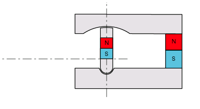

Hi Sreten,
The system you propose in the drawing is not stable. It only works if the moving magnetic system is perfect vertical. But if it turns a little there will be a horizontal force on the upper pole of the moving part applying a force on the tone arm, either up or down, depending on the direction of the turning.
Regarding the force possible, a flux density of 0.1 T shouldn’t be a problem with standard ceramic magnets, i.e. those from magnetic door locks.
Regarding eddy-current braking, you can put a strip of copper at the inside of the upper stationary pole. But anyway the speeds involved are too less to let an eddy-current brake be effective IMHO.
Cheers 😉
If you read the text with the original diagram this is discussed,
some optimisation is possible, whilst on the subject :
Originally posted by dice45
Iwould not be happy concerning the hanging architecture, i prefer to have my vertical pivot axis as close to the records surface as possible; warps and pressing bubbles have the fewest effect on effective stylus speed then.
I agree there would be a motion vector along the groove.
However using double v blocks and a knife edge vertical
bearing as previously mentioned would address this if it is
a concern. both approaches have merits / disadvantages.
🙂 sreten.

sreten said:If you read the text with the original diagram this is discussed,
Oops missed that point. Maybe something along the lines of the attached pic may get rid of it. But I don’t think it will do completely and such a thing is not easy to make. You need a skilled instrument maker for it with the appropriate tools and machines.
Cheers 😉
nice diagram !
But it misses some of the other points, namely the deliberate
\o/ bottom interface to "increase stiffness ?", the top section
is suggested as a possibilty in the text, the text also suggests
the top gap is much larger than the bottom.
The hanging design makes the structure easy to make, the idea
is the instabilility is deliberately exploited to reduce the increase
of tracking force over warps due to the hanging design.
🙂 sreten.

Hi Sreten,
I tried to make the air gap as small as possible, just to minimise play and as such increase stiffness. I didn’t intend to suggest any further construction details. The hanging construction seems to me an obvious way. You need to put the counterweight somewhere and anyway you can’t put is through the magnets 😀
