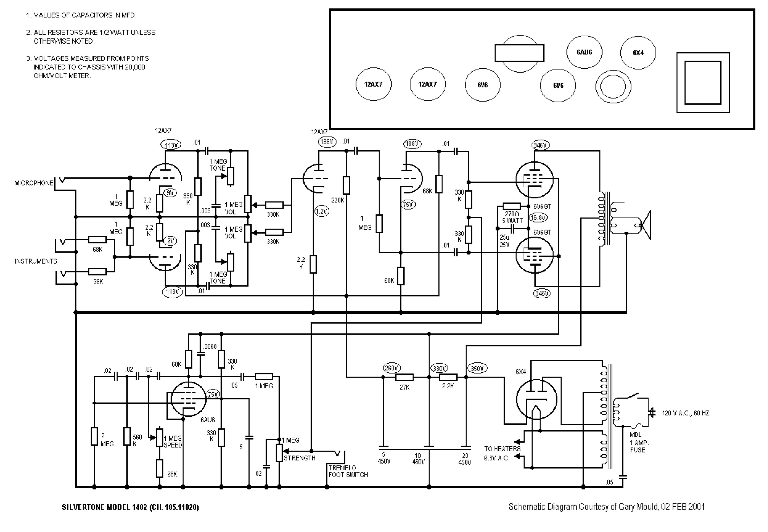

I know that this is a well covered subject in many forums, but I still have a question regarding the operation of this type of tremolo that appears to inject its output directly to the grids of a cathode biased 6v6 PP pair. I've attached the Silvertone version of this circuit because that's what I have to work with.

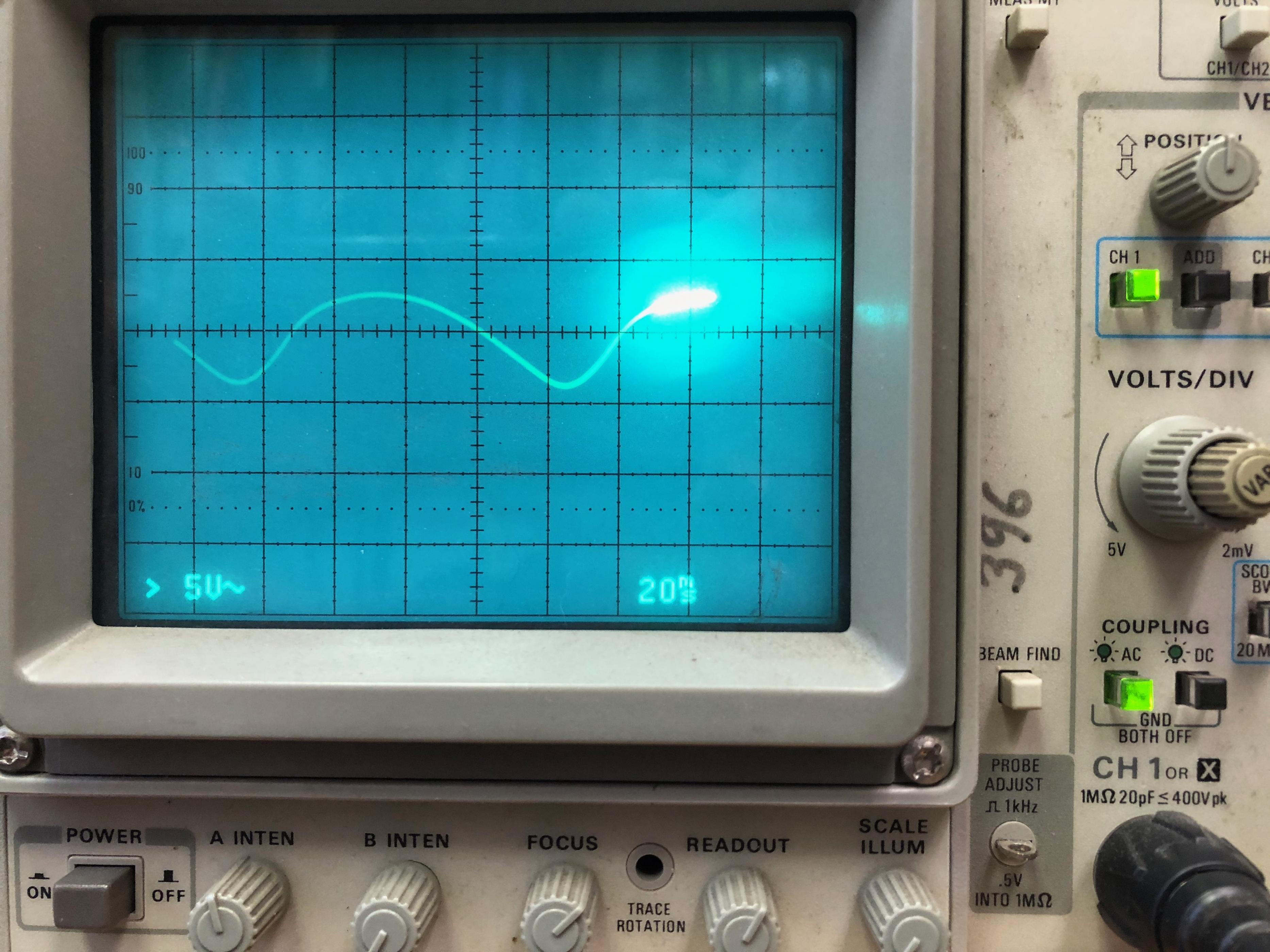

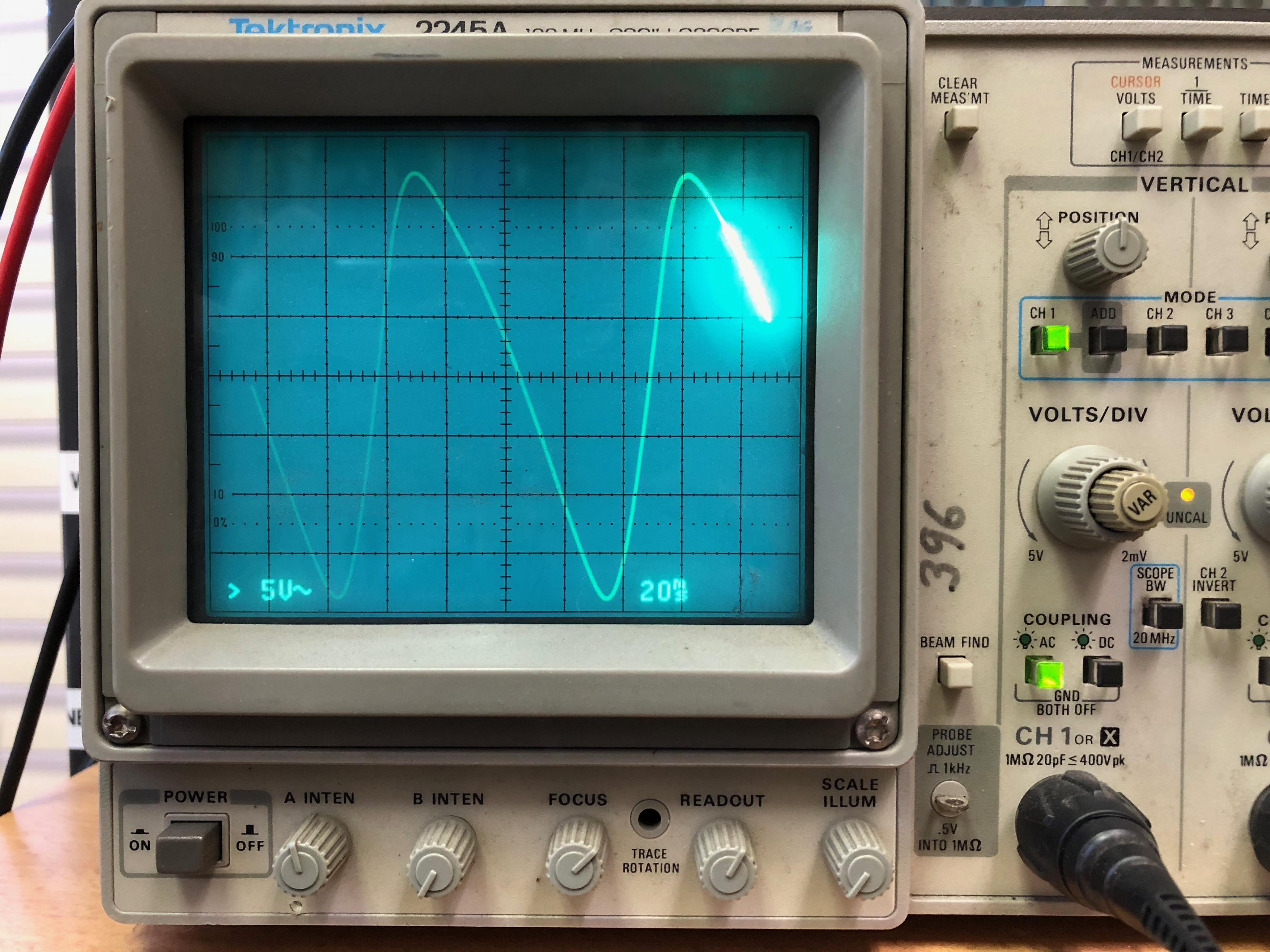

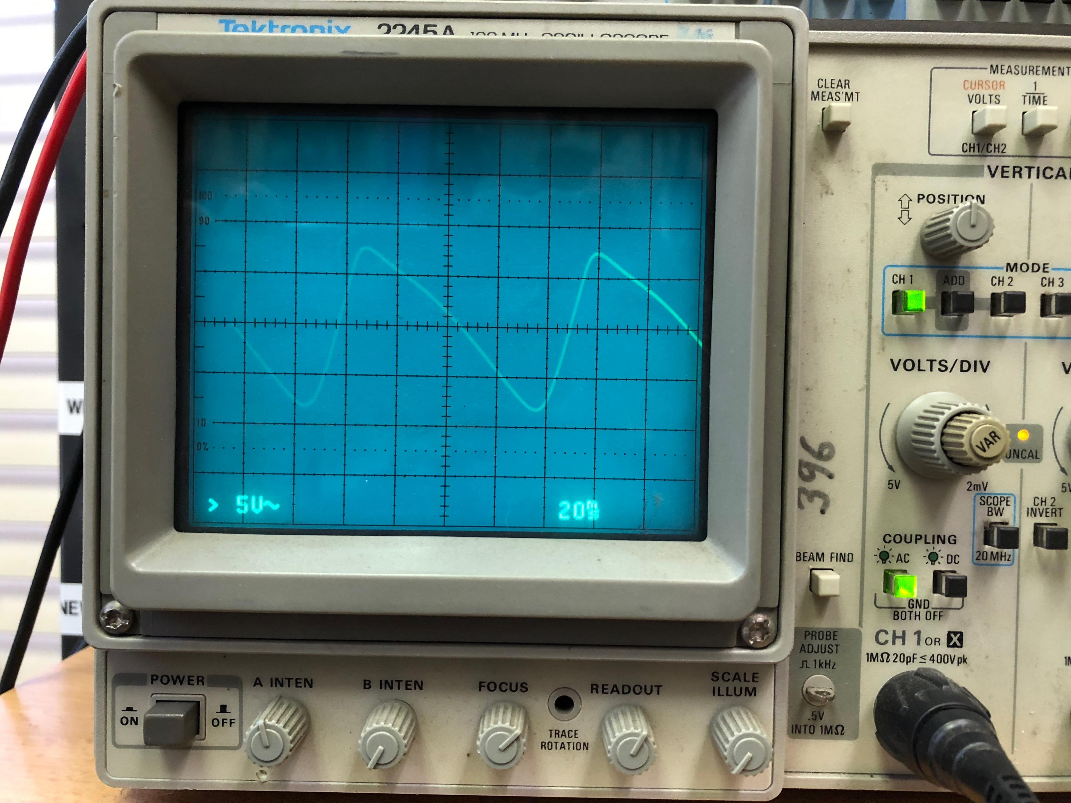

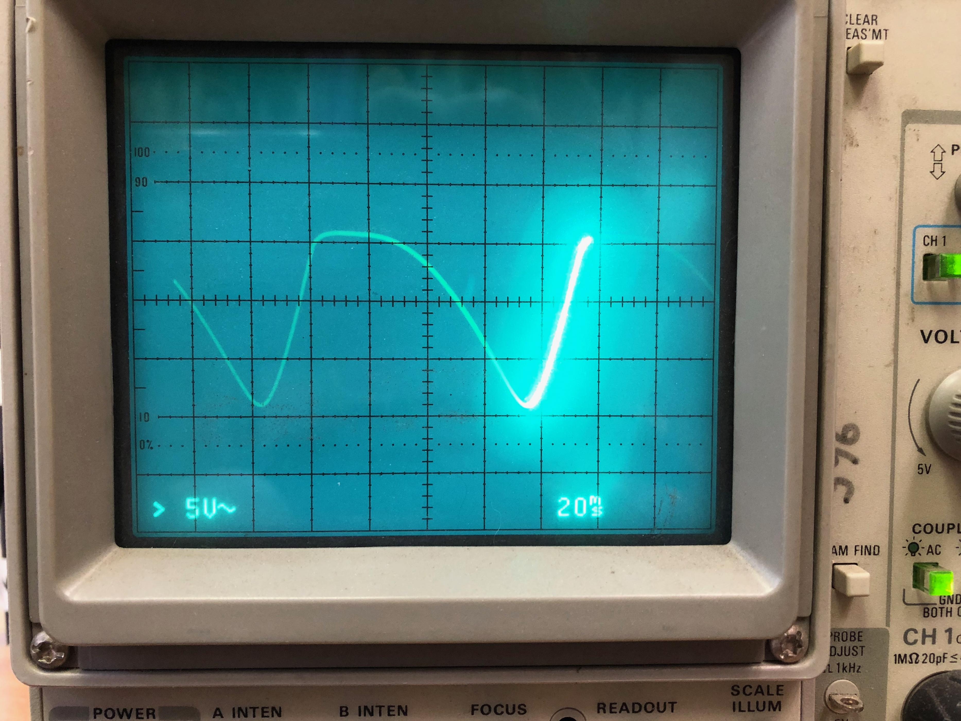

The circuit is oscillating but my question is, what is the expected strength of the signal at the grids of the output tubes? In its current state there is just a faint amount of audible tremolo even with the intensity fully CW. I've also attached shots of my O-scope as I trace the signal from 6AU6 plate through to the 6v6 grids.

Peak trem at grid equal to grid-cathode bias is a little too much.
15V p-p on an oscillator with 330B of B+ is remarkably small. Are there any DC voltages at the 6AU6? How far out have the resistors drifted? Disconnect the 1Meg off the plate; does the plate swing better?

I apologize that my labels didn't come through on the photos. The first shot is the plate with a x10 probe, so 150v PP swing. The rest are x1. The last photo is the 6v6 grid. So you're saying thats too much swing?
