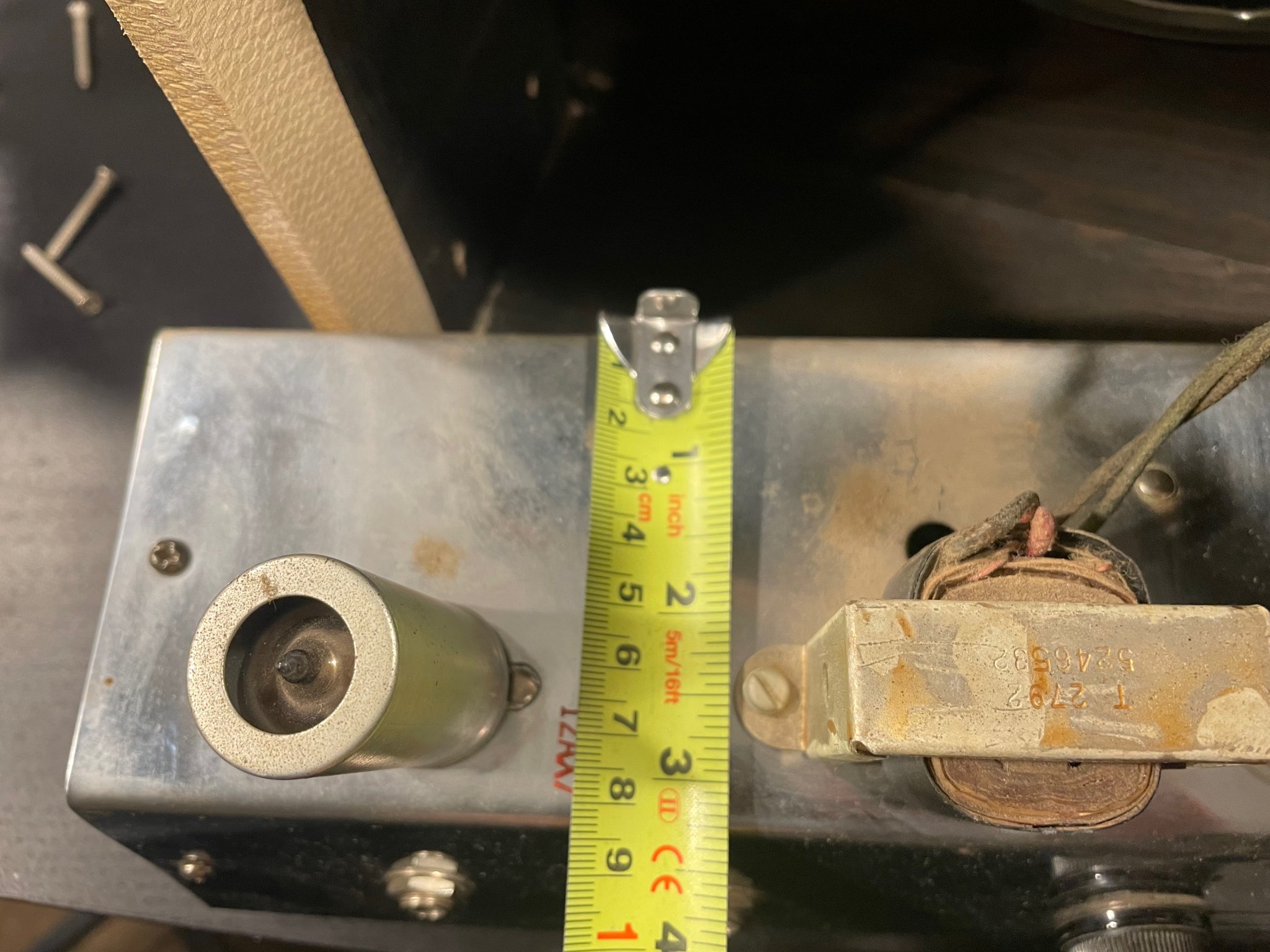

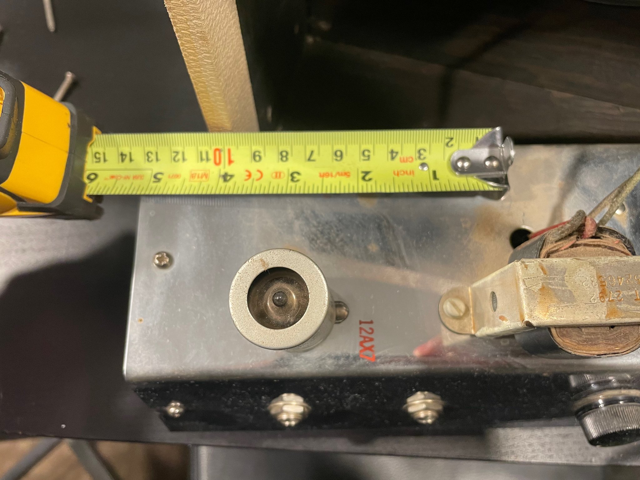

One question if anyone has the time, do you know of any smaller isolation transformers? I'm currently googling but have a maximum of 2" in one direction to mount it to the amp chassis which is unfortunately too narrow for that Triad one unless I can mount it to the side and run the cabling in.

A quick look at Digikey didn't turn up any physically smaller isolation transformers.

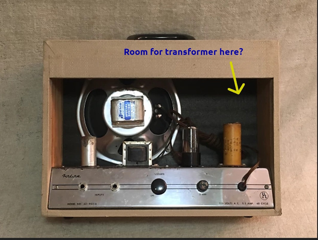

Can you mount the isolation transformer to the inside of the wooden cab, rather than to the existing metal chassis? Or alternatively, cut and add a piece of metal sheet to the existing chassis to carry the transformer?

Yeah I think mounting it to the inside of the cab is going to be the simplest way to go. Have more grommets to feed the cables down into the chassis so will take a look again and see about getting that setup.

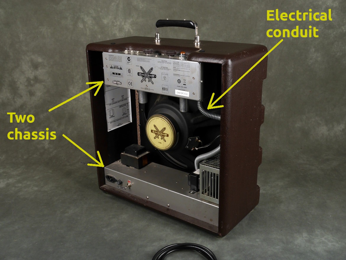

There were some early guitar amplifiers that had two separate chassis in one cab. One chassis carried the power transformer (and usually the power amp), and an internal power cable carried high-voltage DC to the second chassis (which usually held the preamp and all its controls).
I've never seen the original vintage amps with this design, but about a decade ago Fender released their Excelsior amplifier, which was a homage to one of these old vintage amps. In the Excelsior, Fender addressed modern-day safety concerns by using a short length of flexible metal conduit to connect the two chassis, with the high-voltage wires tucked safely inside the conduit.
As long as nobody goes poking around inside the cab with a pair of sharp scissors while it's plugged in (!) I'm not sure the conduit is actually necessary, but it may be something to consider.
One more thing to consider: if you have to run power cables from chassis to (cab-mounted) mains transformer, it might be convenient to be able to disconnect them so that you can remove the two items separately for service. This will require safe and dependable electrical connectors.
If you go this route, my suggestion is to take a look at Anderson Powerpole connectors. They are used in many high-end control panels, and are superbly designed for their job. Each connector consists of an insulating shell, and a separate metal contact, which you crimp or solder onto the wire end, then insert into its shell. For your purposes, 15-amp contacts and matching shells will be more than adequate, though beefier 30-amp contacts fit into the same shells.
