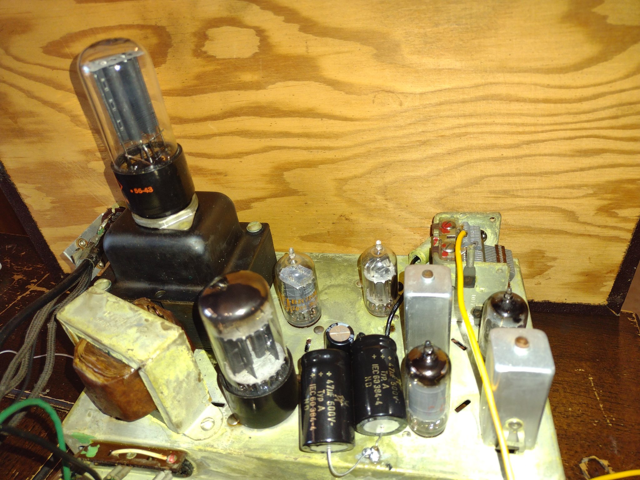

So my Airline 2509-A is on the bench. I've been having so much fun repairing it, and have brought it back to specs, and it sounds wonderful, as is, but I've got the bug, and I know there's more to be had.
Can anyone recommend any mods upgrades to this little guy?
On the list is reconing/replacing the 4 ohm 8" oxford drivers. Posible candidates are:
4 ohm Jensen P8R - AlNiCo Guitar driver, almost EXACTLY the same Frequency response as the oxfords, great sensitivity, about $120 per piece, but very period correct for restoration.
I have a couple of 4ohm 10" Marantz ceramic magnet woofers from a wrecked pair of HLM-310s with a lower sensitivity (I think about 88 db vs the Jensen's 92) but MUCH flatter response.
The cabinet has been stripped, imperfections filled, and sanded, and will be getting re-stained and fresh grille cloth should be on its way soon.
If you owned this cabinet, what would YOU do to make it shine? No limits

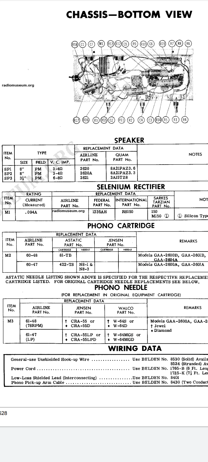

Yes, I am positive that these are the original drivers for the cabinet. If you're unaware impedance can be matched depending on how the drivers are wired. This unit shipped with two 4ohm 8 inch drivers and one 8ohm 3.5 inch tweeter. Impedance matching isn't really an issue.
