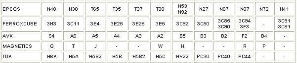

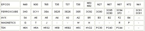

Here's a comparison chart for various brands materials:
