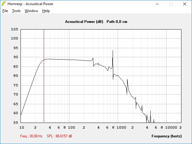

Here's what I get with a single seas in 93 liters. 2/pi 2,83v

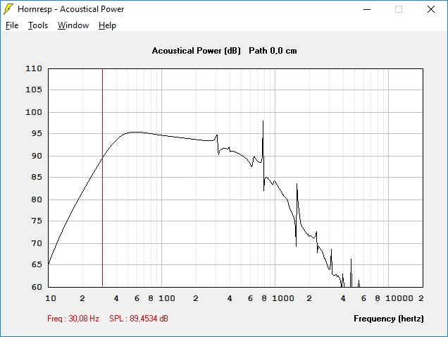

Here is that very same box at 93 litres (including port), only with 2 drivers in parallel, as you can see, there is 3db increase of SPL due to doubled displacement, and 3db increase due to increased power (because of half impedance), note that because the box size restricts low frequency performance the gain at 30hz is hardly worth noting at all. Throwing power out the window and wasting potential of your expensive drivers.
Looks good from 40 hz up though. But you might as well use a sealed box.

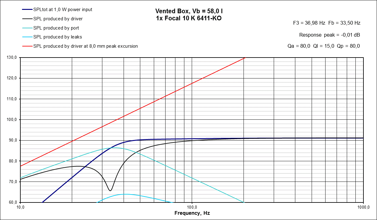

IMHO you are approaching this in the wrong way. Air displacement doesn't mean anything in a BR box. You have to look at the combined driver+tube output and not the driver's alone. At tuning, the sound comes from the tube and not from the driver, have a look at the attached picture. If you want to compare two drivers use a decent box simulator and see what happens changing box volume and tuning frequency, those parameters will affect the bass extension and its shape. Max SPL is determined by the T/S parameters of the driver.
Ralf

The Accuton system has less cone displacement because the port is doing more work at 50Hz compared to the SEAS system.
For the same SPL at the same frequency, the total air displaced (woofer cone + port) by two different systems is the same.
