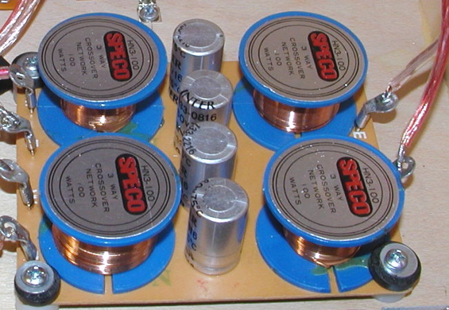

I'm thinking of rebuilding some existing crossovers. These were more or less generic off the shelf crossovers similar to this -
Crossover 3-Way 8 Ohm 800/5,000 Hz 100W | Parts-Express.com
My current crossovers are 800hz and 5000hz, and that works about right for the speakers I have.

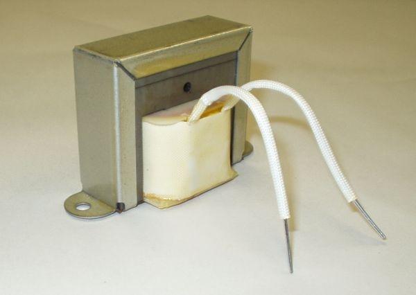

The most linear sort of inductor, down in the small inductance ranges used in crossovers, are non saturable reactors. This is a regular E/I core, with the I's placed on the opposite side of the E fingers. Means the air gap is basically infinite. The useful bit comes from the linerization of the inductance in the coil, due to the support from the core that cannot saturate.
Take any air coil and a decent inductance bridge and sit and unwind the coil one turn at a time. You will not find the inductance changing by the square of the turns ratio. Instead you will find that the stuff clumps. As an average the reduction of turns will provide a close match to calculated values, but in reality 1 turn or 5 may provide the same amount of change. Air coils are not linear.
Examples of these odd ball inductors can be found on any Kilpsch crossover from the factory and most Altec crossovers. Special order only nowadays though.
Actually, air core coils do behave properly. When unwinding, be sure that the wire that you've undone is stretched out straight, away from the coil; and that you did not displace any of the remaining windings. Also, that the coil is away from any ferromagnetic materials, and preferably in the same position for each measurement. The field behavior that is associated with inductance is very well understood, and has been for a long while. It just can be seemingly complex in it's behavior when all factors are not kept under control.
Incidentally, I tend to prefer copper foil coils; mechanically more solid, less susceptible to vibration?
PS. I didn't understand the EI configuration you were describing. Also, any ferromagnetic material will saturate. With a large air gap, it takes a higher current to reach the saturation level, but it will saturate.
Agreed. You do want to make sure you are outside and that the DUT is on a cinder block, before you hit it with that higher current, with one of these....

Here is a photo, though again, keep in mind I was young and naive, and working in something of a vacuum.
This image is hosted by another forum, but it was placed there by me, so I think this probably qualifies as fair use of an image.
Attached is the actual crossover, for reference.
