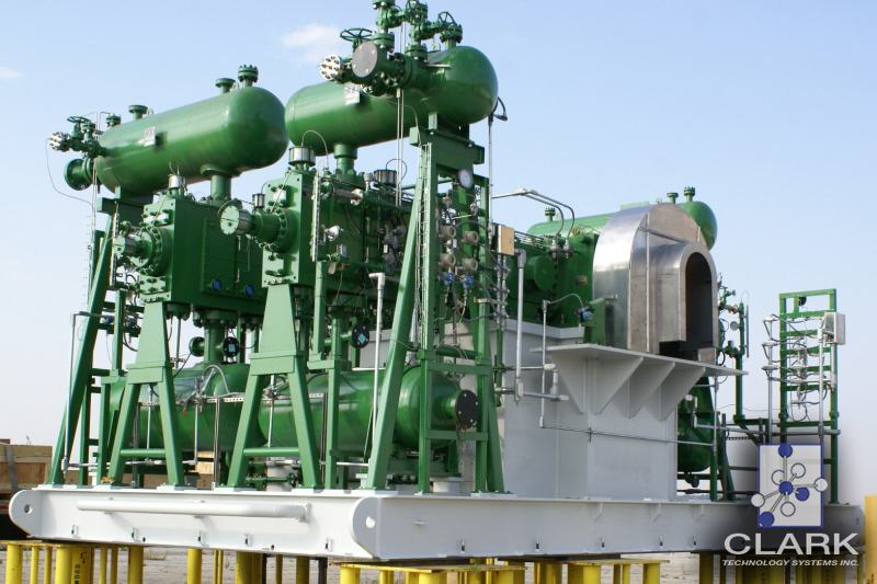

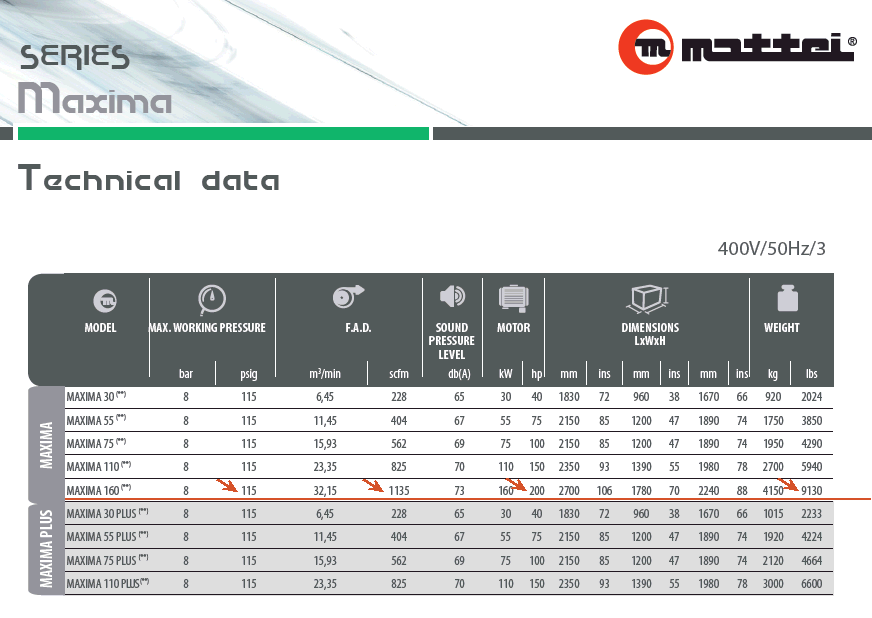

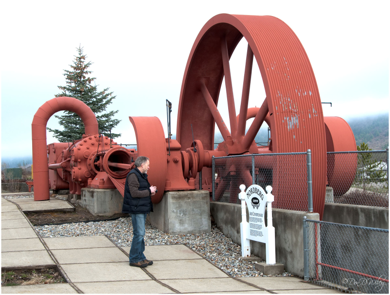

A LOT of the money made in the African diamond district was actually made by the air compression companies. Hopefuls would rent jackhammers and buy air from extremely long pipes, and dig until they hit diamonds (or went broke). Hundreds of jackhammers in one area use a LOT of air.
Old books/mags----
Compressed Air: Its Production Uses, and Applications {1909}
Compressed Air, 1901
Current examples---
Large Compressor Packages Project Case Studies
