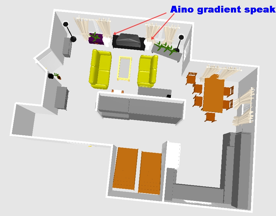

Back to acoustics during holidays... My home and livingroom make a huge resonance chamber specially between 80-300Hz (low RT and EDT). This is generally a good feature, gives good resolution, but it also sort of sucks lots of bass energy. Take a look at pictures, notice also difference L/R.
It is nice to have a minidsp-controlled multiway loudspeaker system to attack these acoustic challenges. Room acoustic treatment is out of question and it is not even likely to make any fundamental improvements in this special case.

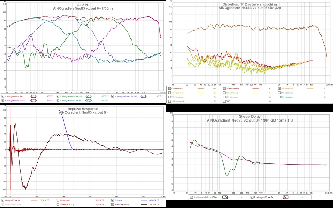

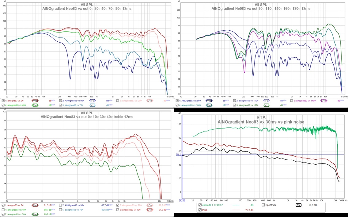

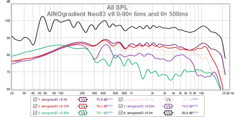

I had the oppertunity to take AINOgradient out for some measuring sessions!
First I reran eq and xo adjustments to get best curves, slopes, match and lowest distortion, this is dsp-version vx, xos 180Hz LR2, 600Hz LR4 and 3500Hz LR4. The lowest xo range makes cardioid response because subwoofer is closed and has omnispehric radiation.
Measurements were taken on grass, 1,6m distance, mic level between upper mid and tweeter. Some wind and noise, ambient noise level 30-40dB. I used RoomEQWizard as usual and converted polar measurements for OmniMic to get polar spectrograms.
Vertical directivity is not as good because this is a tall multiway and it is also difficult to measure because itcan't be set horizontally. I enclose an indoor +/-15¤ measurement.

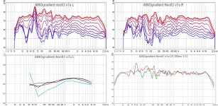

Room response with same vx settings.
Not bad at all.Speakers 80cm from front wall, 2,5m from side walls and mic 1m from back wall. Similar setting as in earlier posts.
Those colourful piccies are wavelets, not spectrograms!
Those wiggles around 600 and 900Hz in outdoor measurements were ground reflections. I thought that the long grass would attenuate enough, but false!

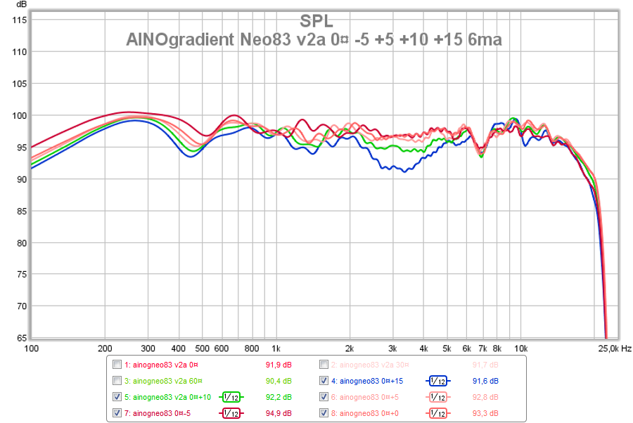

Here new indoor frequency measurements with slightly retuned equalizations, version vX1
