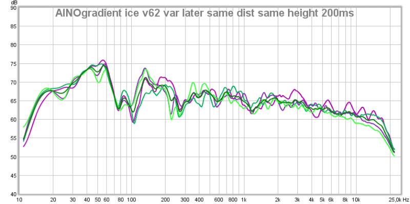

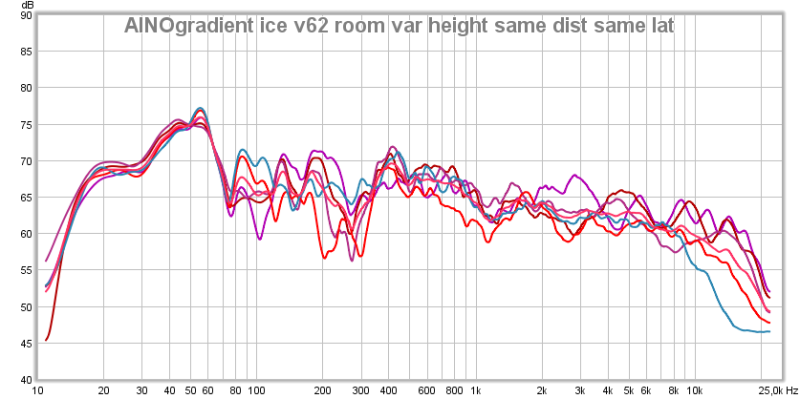

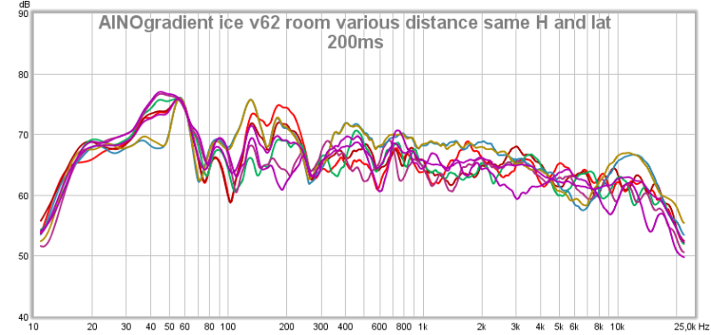

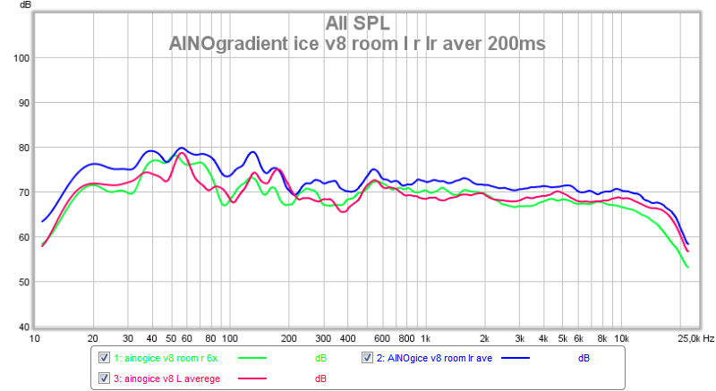

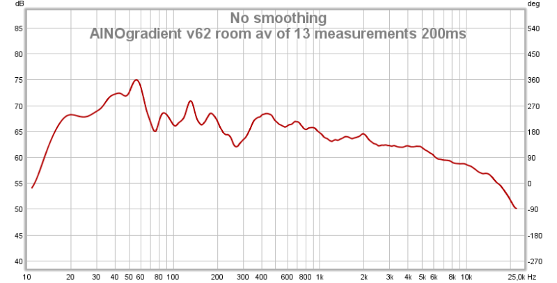

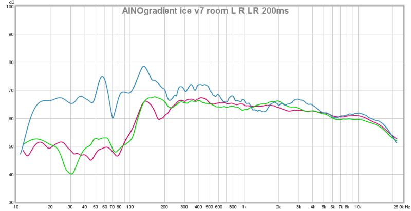

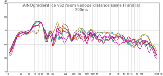

Room response of AINOgradient
A single bass box and two towers (LM,HM,T) playing at WAF-accepted speaker positions in my living room (60cm from front wall, 2,5m apart, 2m from side walls, mic at 3m distance. Mic centerpoint a my listening spot and moved at max 1m radius in 3 dimensions, 13 measurements "center-weighted" and also shown the effet of moving in just one plane. 200ms rear window and 1/6 oct smoothing in all measurements.
I think that the power response in close to what is considered good for small rooms (my room 3,6 x 5m with many openings and a tilted ceiling, lots of windows. The measurements with low level of highs are from floor level!

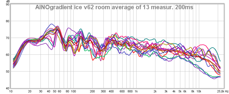

ainogice v62 room var height same lat same dist 200ms.png91.5 KB · Views: 455

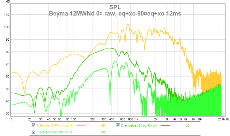

That dip above at 250Hz was a phase issue. I carried the proto woofer and MTM pole outside today and set W to LM xo lower. I had to boost LM's low end a little. LM still has a dip around 220Hz, it is a floor bounce cancellation at my measuring distance 150 to 150cm.
there is a difficulty with phase matcing of the lowest xo of a 4-way speaker having Duelund(ish) xo. I have managed that by using LR4/LR2/LR4 orders instead of all being similar. But in the room - monopole radiation of the woofer is practically impossible to match flawlessly with a dipole lower mid. A sacrifice of my concept. Generally speaking (sub)woofer matching is very difficult below the Schroeder frequency of the room, because reflective modes make phase go all around.

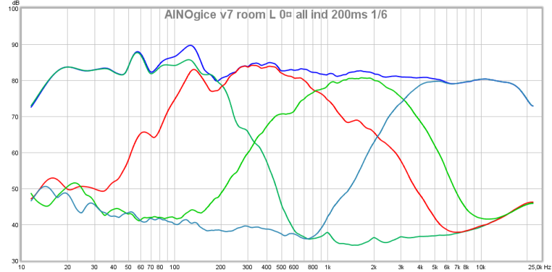

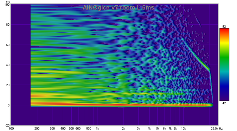

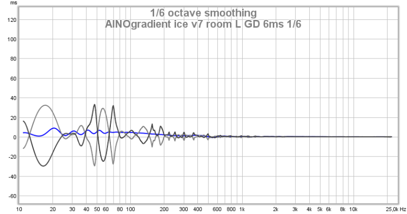

I didn't save outdoor measurements, but here are the indoor measurements with speakers at listening position, like in the previous post. The last one is with LR playing together.
AINOgradient ice v7 indoor

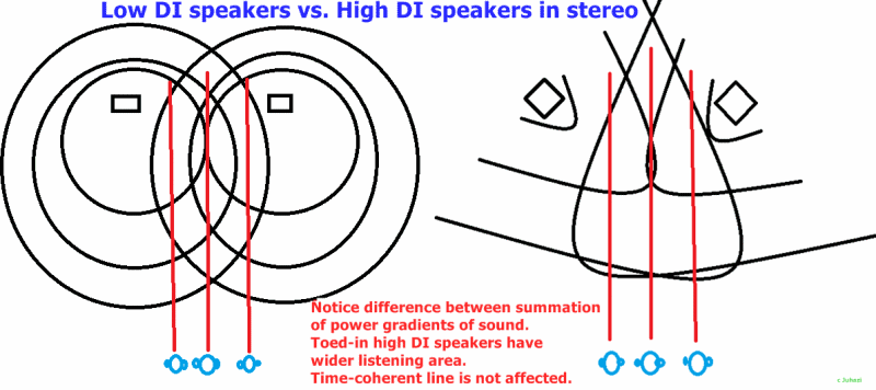

Here I visualize, why I wanted speakers with high and even directivity index (DI) for my living room setup. The animation show sound power gradients interfenrence/summation in stereo and we notice the wider listening area (relative L and R power ratio being constant). Of course time coherence is maintained only at exactly same distance to L and R.
We can also see why it is important to toe-in high DI speakers!
The second major benefit of high directivity is that speakers make less floor, sidewall and ceiling reflections. These reflections degrade soundfield and are perceived mainly as deterioration of stero image and irregulaties in amplitude response.
If it were as easy as that in the real world. 😱Here I visualize, why I wanted speakers with high and even directivity index (DI) for my living room setup. The animation show sound power gradients interfenrence/summation in stereo and we notice the wider listening area (relative L and R power ratio being constant). Of course time coherence is maintained only at exactly same distance to L and R.

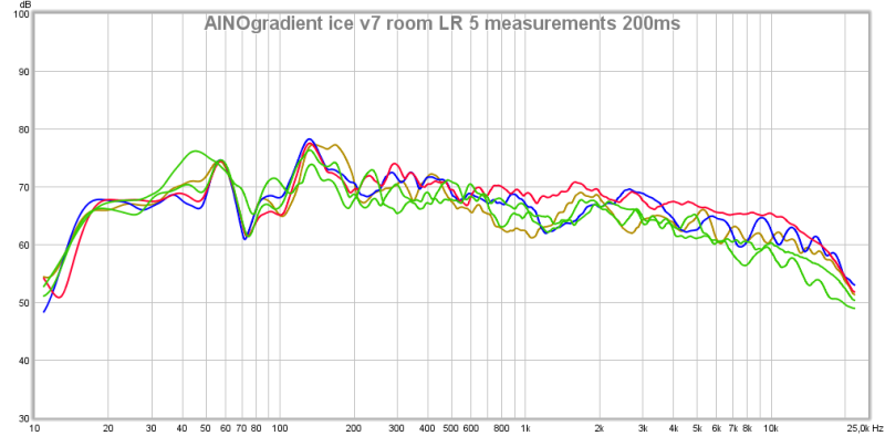

Does your wider sweet spot keep its quality over the colored area? It is more like three (or five) single spots in my case where time/intensity trading works.
Rudolf, mys post #221 covers your question with an overay of 13 measurement made in a hemisphere around "the spot", radius 1m. This shows just amplitude response of two speakers playing same signal simultaneously (thus lots of lobing). I don't trust my measuring skills enough to analyze other aspects.
But, believe me - I and my friends can verify that the sound and image "hold together" exceptionally well with AINOs. I still don't have two bass boxes, so this is not final! I will report back when I have measured and auditioned a full pair. The pianist Petrescu is on tour now and my wife-in-law's son who is an EE (specialized in dsp) is coming here next week. I hope to get boxes ready for them.

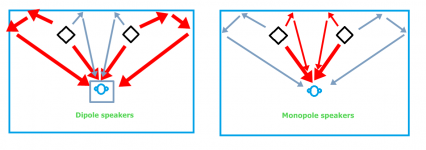

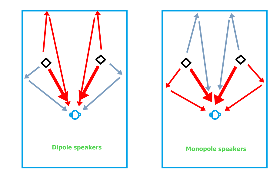

Another simplistic presentation of benefits of dipole speakers.
A dipole radiates evenly front and back, but sideways is attenuated more than 10dB. A monopole radiates evenly front and sideways, but backways is attenuated more than 6-10dB.
For good sound perception in stereo, early reflections should be minimal and attenuated. Late reflections add "spaciousness" to the sound. Reflections naturally continue their paths and meet crossed walls, attenuate by distance and start to blend. The bigger and "softer" the room is, the better.
In these graphics, red arrows represent strong spl and blue attenuated spl. The lenth of an arrow represents delayed time for hearing the signal. Close o back wall is no-no for both (unless on-wall for monopoles).
Positioning of speakers in these graphs is ideal. Both surfer from placing them closer to walls, but in a different manner. Dipoles suffer most from placing too close to front wall (behind the speakers) and not toe-in'ing them. Monopoles suffer most from placing too close to side walls.

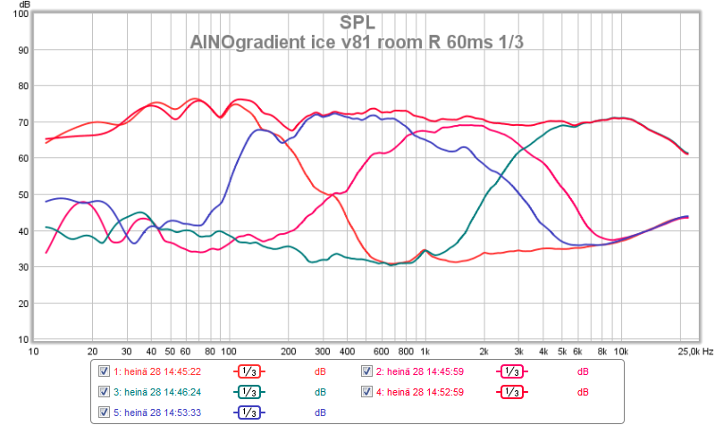

Room mode bumps at 60, 120, 240Hz
Single speaker 1,5m response at 60ms and room response at 200ms (each line average of 6 measurements at 1m sphere)

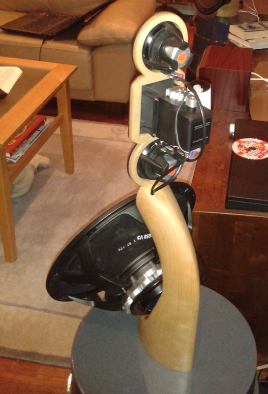

I have exhaged some PMs with Greebster -thank you Mike! We are figuring out/trying to understand and improve dipole behavior of the mids. I chose the mtm arrangement after chosing to use 3" high-mids because of their smaller diameter. This creates some other problems - vertical lobing, interferences from the tweeter's body and the baffle/frame all these are mounted on. Frame is 8mm thick. The lower mid suffers from the nearness of high-mids, top of bass box and the post behind it. Post's cross section is elliptic to minimize diffractions.

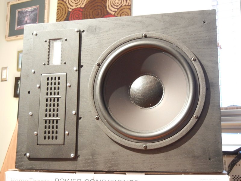

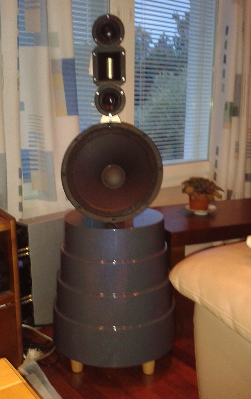

Poor quality photos of ready-made AINOgradients attached!

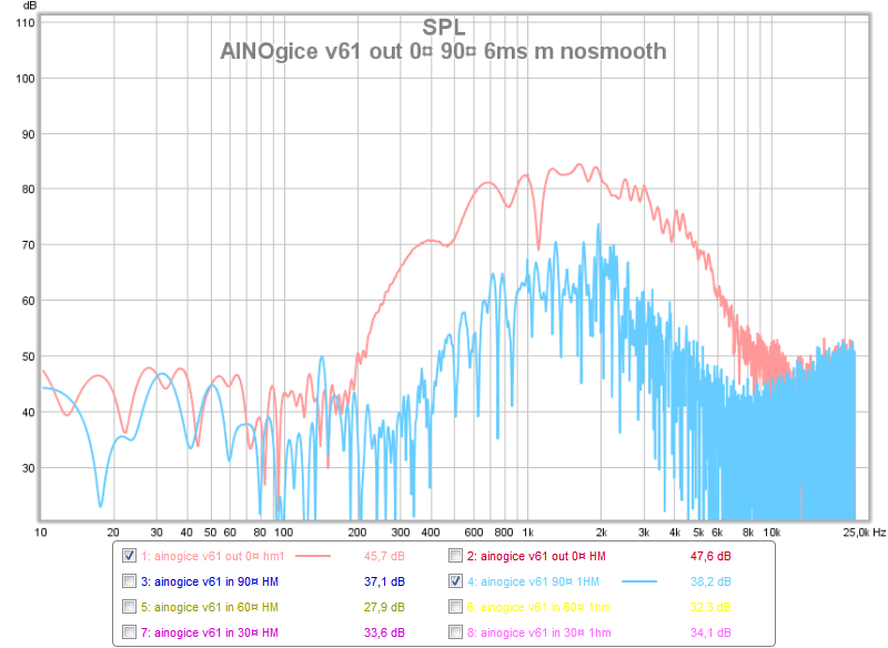

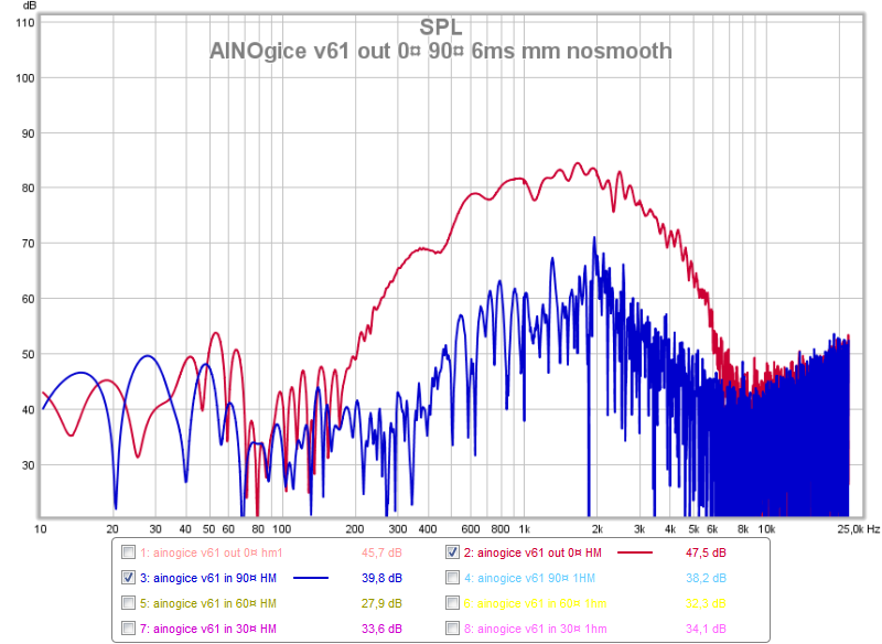

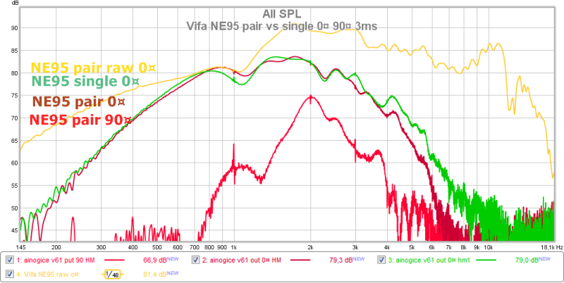

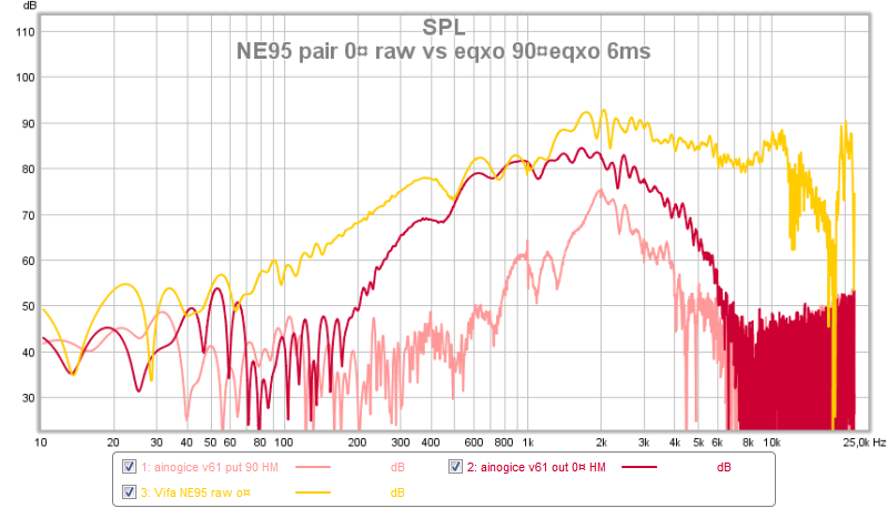

I also attach graphs that may help to analyze the behaviour of my mids. All measured outdoors, version AINOgradient Ice v61. All elements attached all the time, just different electrical connections and rotation.
From these graphs we can also see what parametric eq and xrossover setting do. Dipole corrections loses a lot from efficiency! I use minimal boost and only in the region of highpass xo, to avoid digital clipping in minidsp.
My selection of amplifiers is working well. B&O Icepower 125ASX2 are drivin W and LM, 50ASX2 are driving HM and T. I use a Yamaha RXV-630 AV-receiver as preampifier and "mixer". SPL with AINOs is a bit louder than a pair of MarkK ER18DXTs at same volume setting. I don't have a meter but max spl is far above 100dB (my ears started hurting at -10dB) and there was no clipping, distortion or resonaces. LM membrane was moving some 4mm. I use LT type eq in minidsp for SEAS L26ROY woofers, something like -7dB between 30 and 70Hz.
Sorry, I don't want to say anything new about the sound, because I want to get more opinions.
W SEAS L26ROY in sealed 25 liter, polyfill (monopole)
LM Beyma 12MWNd nude, tilted (dipole)
HM Vifa NE95-4 nude, pair in series (dipole)
T Fountek NeoCD3.5H (monopole)
minidsp 4x10HD, acoustic xo's 150HZ LR4 800Hz LR2 3100Hz LR4
Bang&Olufsen Icepower 125ASX2+50ASX2 modules (total 4 channels/speaker)

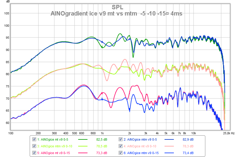

More evaluation of MTM vs. MT arrangement

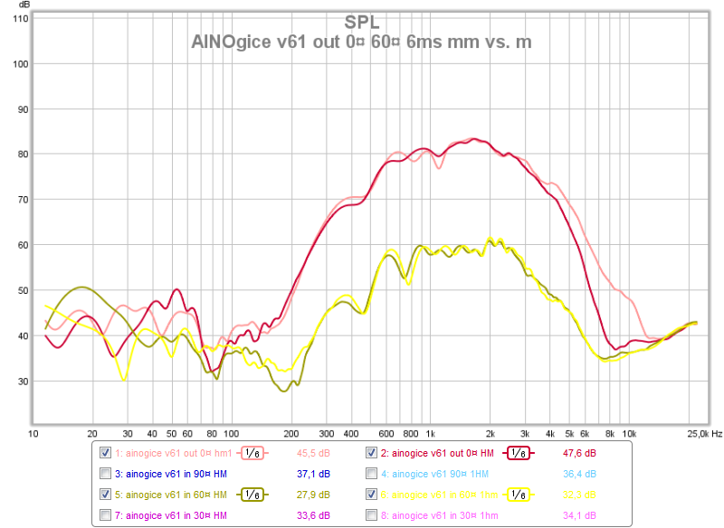

I played a little more with my old measurements, v61 outdoors. Here I use 6ms IR window. Pair of M is always darker line, single(lower) M is pale color.
There are differencies, but no consistency to my eyes.
However I can hear lobing effects with MTM when playing sine waves. More listening test will be done with pink noise, sine and music when I have an opportunity. SPL, distortion etc. -wise a serial pair and single are equivalent. A benefit from MTM is symmetric vertical directivity and perhaps some more "attack" in transients.

A benefit of MTM setup is wide horizontal directivity and narrow vertical directivity. This way we can reduce floor and ceiling reflections.

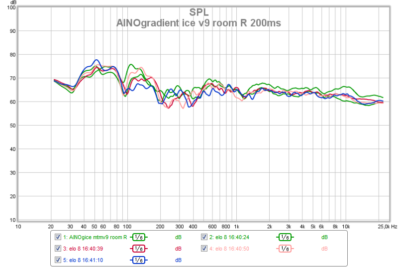

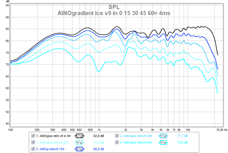

The weather doesn't permit outdoor measurements, so indoor... I made some changes to xo, its now all LR4 acoustic, xos 200,1000,3300. Horizontal response is the same as before, nothing new.

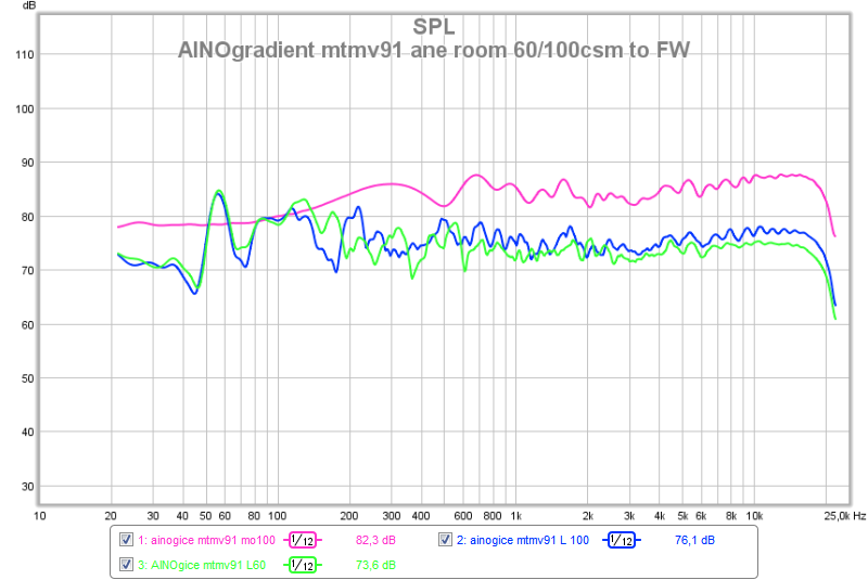

Front wall distance affects response a lot. Pseudoanechoid 6ms vs 60 and 100 cm to front wall 200ms - first attachment.

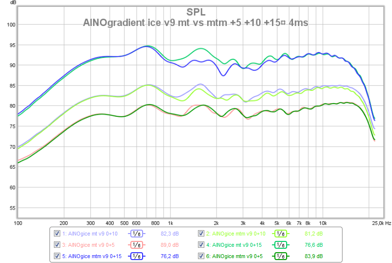

I measured vertical directivity of mtm and mt arrangement. Now I got some sensible results and I must say that mt has perhaps better vertical directivity. However mtm is reasonably even till +/- 10¤ which means +/- 50cm at my listening distance. I'll stick with mtm. I also mesurend +10¤ at 30¤ horizontal and it is just like 0¤, not shown here.
Room response average of 5 mic positions, R speaker at 60cm to wall and bass too heavy. Just to show how much this means.
Horizontal directivity, this time short IR only 4ms. This is mtm. Please notice that 2-3kHz is a bit hot here, but same range is cool at vertical offset - compensates total power response..
Yep. Also the drivers will have different path lengths hence different cancellations freq that will flatten each other out.
Hello!
60cm? You won't be able to get good midrange response that close IMO. It shows on the graphs, response flattens only around 1k. In my experience, dipoles are a b.... to place, where the midrange is great, bass is crap. Theoretically best place for bass is near side walls/corners. Further away one might manage to excite only one or two modes and use EQ. Or sit very, very close to the speakers..
