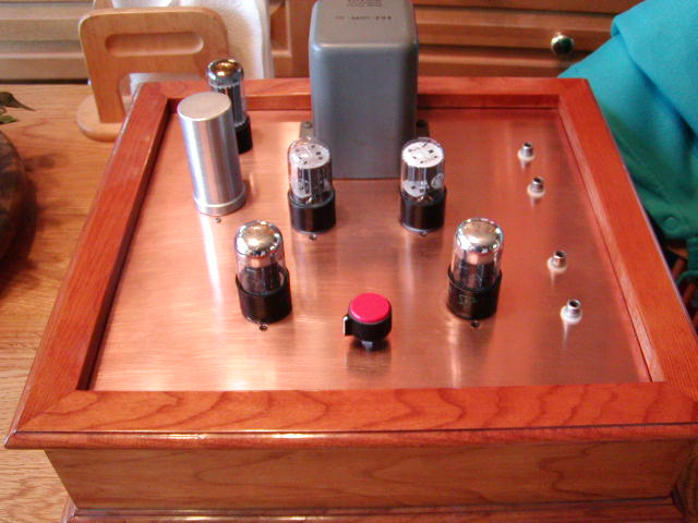

Hi Charlie,
I have built a number of Aikido line stages. Some with dual mono supplies, some with power supplies as part of the main chassis and some with power supplies that are separate from the main unit. All work fine but I enjoy the dual power supply Aikido the best because of the added separation between channels.
With respect to the cabinet I like to use brass or copper as a top plate that sits on a wooden base. The copper or brass cost about the same as a aluminum chassis and I think it looks better. I still need to replace the plastic volume control knob but the picture gives you an idea. The VC and rca jacks are insulated above the chassis and grounded to a central point.
