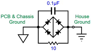

Circuit ground is connected to earth via a single point, with back to back diodes, 10R power resistor and a 10nF cap.

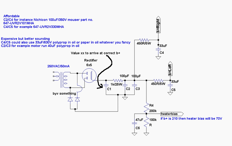

Power supply is:
DC 6.3v supply to the rectifier heater
HT to 6X5 diodes via a pair of diodes to lessen start up stress.
Then to 3.3uF film cap
Then 10H choke
Then the HV splits into two separate sections - each with a further 180uF-1k-47uF filter for left and right. However, I have both of these joined together after the second 47uF.
Heater elevation is also on this power supply board, 200K-68K decoupled with 47uF.
DC sits around 300V, and elevation is ~80-82V

Just to add - the PSU I'm using is this one:
https://www.diyaudio.com/community/threads/aikido-linestage-help-needed.98142/post-1158365
Exception - C1 is 3.3uF, and I'm using 10H choke instead of 1K/25W. C2/C3 are 180uF and C4/C5 are 47uF

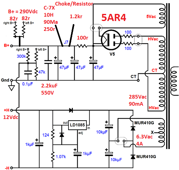

This is what my PS for 6SN7: Either Choke/Resistor doesn't cause hum/pop. B+ is stable, doesn't cause any problem when the AC move from 120Vac-115Vac. I configure B+ at 120Vac where it works fine at 115Vac if it drops. My home AC is stable at 120-118.
Either Choke or Resistor at J7 has no problem with hum.
I have tested both with/without ground house, doesn't cause hum either. You can wire the GND to the chassis.
The hum/pop I was encountered were a steel chassis and a damage resistor. After found out the steel chassis causing hum with toroidal transformer, I changed to the aluminum. Then a damage resistor causing a pop or a cracking sound I think. Finally, it has been working without problem.
