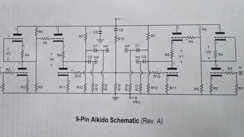

I have an aikido problem that has evaded me. I built a 6sn7 aikido using the official broskie board and parts, and a valve rectified psu from an old group buy here by bas horneman I think.
Anyway, I hadn't used it in a long time and when I went back and done some tidying up etc I had a lot of rustles and noise - typical of dirty valve sockets. So I swapped out the sockets for new ones from langrex with a few drops of deoxit on each and the noise is gone.
BUT now I have a new issue that is really stumping me. Every now and then, there is a pop that trips the DC protect on the power amp. It's quite quick, and hard to catch on a dmm, but as much as I can see it just barely trips the DC protect at under 1v. It's gone as quick as it came and might not happen for another half an hour or more. There is no other noise from the preamp.
The first thing I thought of was the output caps - maybe those old pio caps are getting leaky, but I swapped in modern film caps from mouser and it happens the same. I also swapped all valves for another set just in case also to no avail. All this is with inputs shorted of course.
Anyone got any ideas? I wondered about oscillation and could go with bigger grid stoppers but I'm not sure it's oscillation.

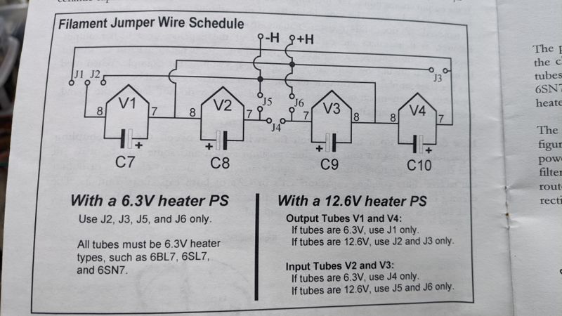

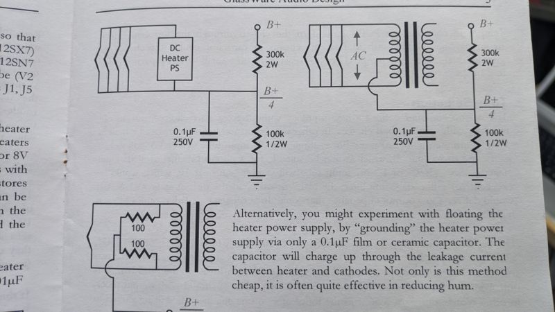

Pics from the booklet attached. I see Broskie also recommended 1/4 B+ as well. I'll change that tomorrow.

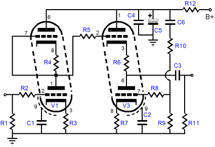

Exactly what would you recommend for decoupling - the same as Broskie in the circuit attached?

Depends on the impedance of the elevation resistors.
Certainly the 0.1uF shown would be the minimum. I've used up to 100uF.
But don't use excessive resistor values, no more than 100k to ground.
The B+ / 4 elevation makes the upper and lower Vh-k voltages equal (but opposite polarities).

I adjusted the elevation - 200k-68k which with a B+ of 310-320V works out at 85-87V elevation. This stays below the 100V max K-gnd in the datasheet. The 68k is decoupled with 47uF.
