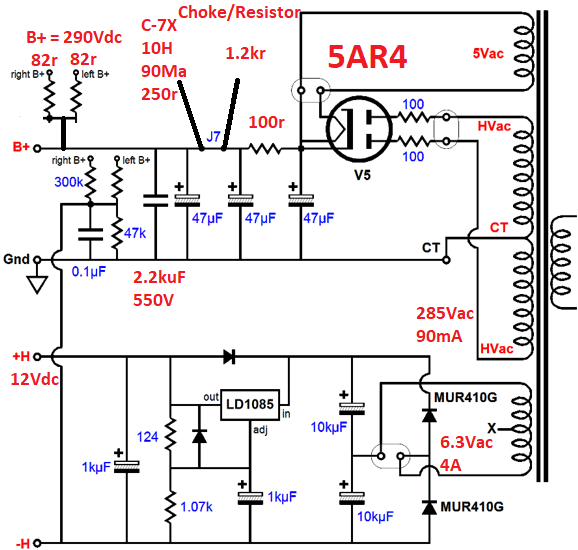

I want to ask you about 21st Century Maida Regulator (Rev.3.0 or older) if is used with this circuit, does capacitors C4A and/or C4 are required or not? Is there any benefit of using these capacitors in the circuit? I am referring to the schematic of Aikido is posted in #31.
Many thanks,
bekim
Tom surely can provide a better answer than I can, but in my Aikido I use a tube rectifier, 10uF, the Neurochrome board, 10uF, then bypass R12, C4 and C4A. The unit is dead quiet. But maybe there are technical reasons to do otherwise.

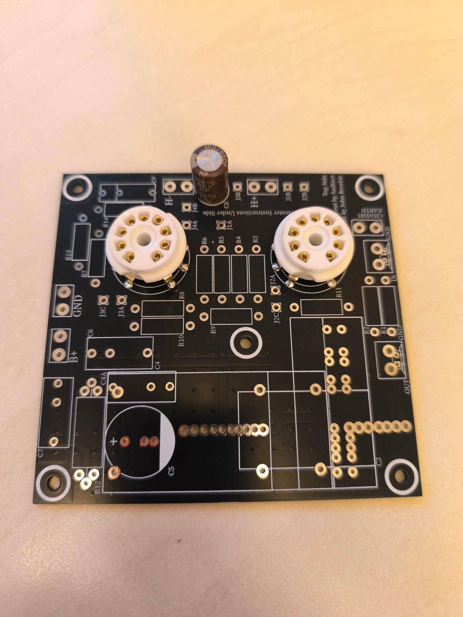

Folks:
I am still largely side-tracked by another project but I have begun populating the Noval boards for my Aikido project and have stumbled on what is likely a dumb question: what is the recommended wattage for R12? I was about to install a 1/2 watt resistor in that position but noticed the footprint is far larger there than those for the other resistors on the pcb. Is this my paranoia at work or did I manage to not make a foolish error?
Many thanks and happy holidays!
Scott

I have 3w for R12. It's actually depend on your PS. Without load, it's around 330v and 290v with 4 tubes.
This is my PS configuration for 4x6SN7 to run on both Left and Right.
R12 has pads such that you can put 2 resistors side by side in parallel for higher dissipation.
The actual dissipation depends on your B+ supply, current through the aikido and the voltage you need to drop to get from your 'raw' B+ to your target b+ at the tubes.
In my case (6SN7).
I am expecting 15mA through each channel
Target B+ at the tubes is 250Vdc
'Raw' B+ is 265Vdc.
R = E/I
= 15Vdc/0.015
= 1K
P= E x I
= 15 x 0.015 = 0.225w for the DC part. Derated by at least x5 = 1.5w
I am running 2x 2k 3w metal oxide resistors in parallel.

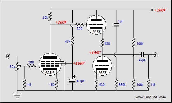

Hello again.Hello everyone,
Have you ever tried the Aikido configuration with 6AU6 and 5687?
My question to everyone is if any of you, have built the circuit above with 6AU6 and 5687 ( I have many of them in stock). I designed the circuit in a pcb with sprint layout 6 and if it works OK I will send it to China for production. Has anyone dealt with this circuit? I don't use the LT Spice.
I would appreciate any feedback.
Thanks a lot
