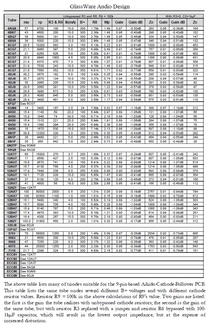

I have seen the chart detailing output impedances of the various valve options but I am a little unsure what sort of input impedances I would be looking at with the cathode follower kit.
I haven't quite decided on the valves but 6CG7 or 6DJ8 is probably what I will go for.
I am looking at options for potentiometers and will probably use a shunt stepped attenuator. Would a 100K series resistor based shunt POT be a good bet in the ACF 9 pin with 6CG7 and 6DJ8?

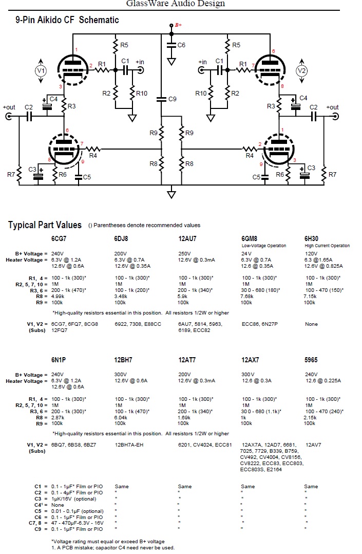

I have attached the schematic and also the table with the part values for the different valves that can be used in this circuit.

6DJ8 will have a lower output impedance than a 6CG7, see Zo on the chart. Also you can run 6DJ at 150 to 200 volts where the 6CG usually runs 250 to 350, if that makes any different to you.

I was looking at the table and 6DJ8 looks the best candidate from an output impedance point of view. Your description of 6DJ8 vs 6CG7 also suggests this would suit my system and taste better.

Is that sometimes tube designators will be reversed. For instance V1, the input tube for one channel will be labelled V2, the input tube for the other, and vise versa. It can drive you a bit nuts if you are trying to compare the board to the schematic.
The instructions are fairly basic, you don't get the "Heathkit" style of detail.
I've not had any parts mislabelled but you might get several values for some of the resistors. You choose depending on the tube you use or in the case of a power supply the output voltages you want.
