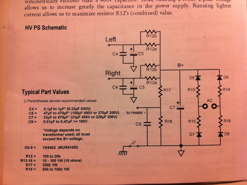

I'm using this board with 6SN7's in all four locations. I stuffed the board using the "Typical Part Values" for this configuration specified in the manual and tested it with a 240Vac transformer borrowed from another project.
The transformer I'm trying now is a Hammond 185E230 with series secondaries measuring 260Vac. The B+ measurement test pad measures 350V. This seemed kind of high given the documentation frequently mentions B+ and 300V in the same sentence.
I've finally realized that the B+ test point is before the R12 resistors after having just changed them to higher values to lower B+ but then seeing no result.
The voltage across C5 is now 289V. The Typical Part Value table that I built to references a B+ voltage = 300V and Vac to Rectifiers = 240Vac.
Anyone know where I'm trying to hit 300V, B+ test point or C5?

B+ would normally refer to the voltage, measured under load, from the power supply before it hits the circuit..... so in your first pic, where it says "left" or "right" and with the tubes in place.

A circuit designed for 300V will probably work fine at 350V, provided that any capacitors can stand the extra voltage. Don't panic!
IME with the octal Aikido, the higher the voltage, the better for linearity, assuming your parts can stand the extra volts.
My PS caps are 450V and C4, C5, and my coupling caps are all 400V.
