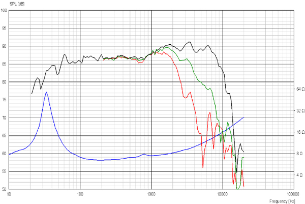

He posts the original ScanSpeak image:
As well as his own measurements which are much closer to what I measured, and published:
So, for whatever reason, when it comes to these series of driver, ScanSpeak's measurements are not up to date. These are much better measuring and sounding drivers than the spec would lead you to believe.
Update: The discrepancy which Troels mentions above is exactly what I see, but for a different driver. I was talking about the 18W/4531, while Troels experimented with the 18WU/8741/T00. However, his observations and conclusions are exactly the same as mine:
And I was really surprised to find the ScanSpeak 18WU performing exceptionally well compared to the infinite baffle response found at ScanSpeak's data sheet:
Even the difference in measurement from published to in cabinet are practically the same.

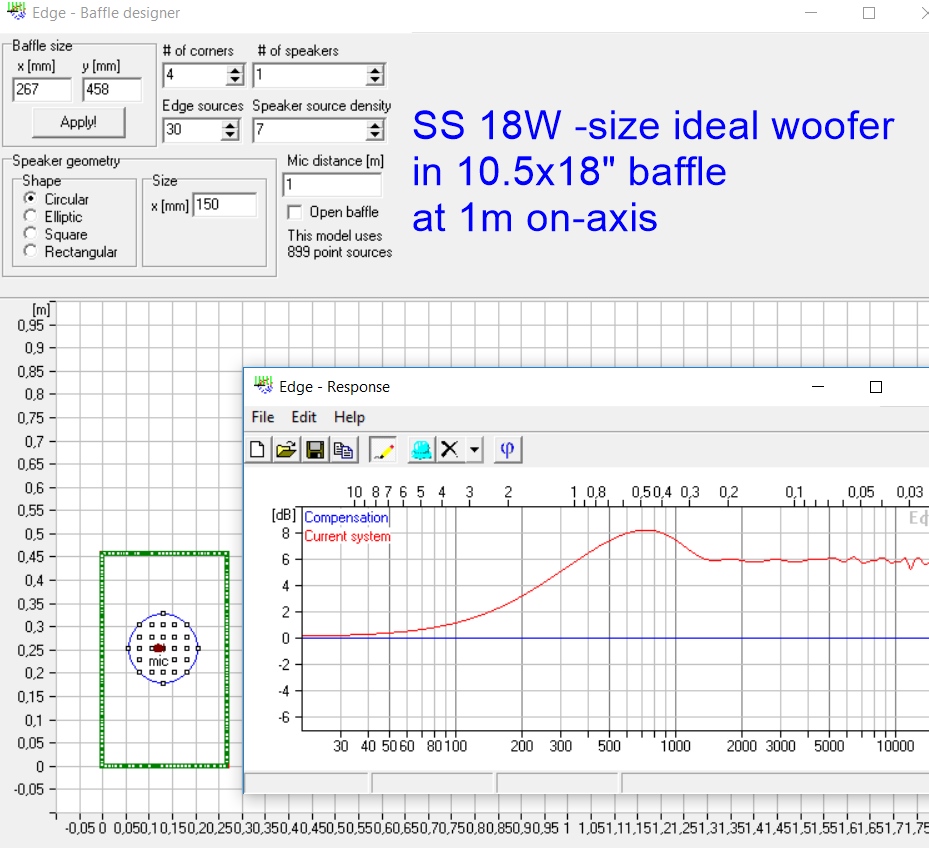

Troels attributes the difference to infinite vs. actual baffles, but at the top of the mid-woofer's range, that doesn't make much sense to me. I want to think this is more of an engineering change that was not documented. Let me go look at Zaphs data in a bit.

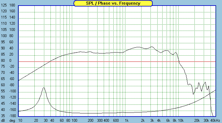

Should have done this before, but here is a comparison of the 18W/8531 from the spec sheet:

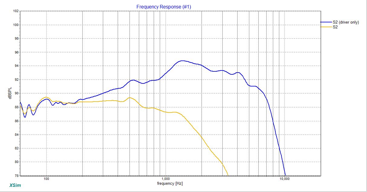

And not exactly the same driver, but my own measurements with the 4531 (4 Ohm) variant:
attachment.php
Notice that my chart uses a fine-scale, and that there is a little hump, but it's nowhere near the magnitude of the hump in the spec, and it's certainly not a shelf.
You can see in the yellow line the final slope after 2nd order filtering applied. There is a notch filter and Zobel but they don't contribute to this discussion. They just flatten the slope. You may review the full crossover design in the attachments on this thread:
SNR-1 : Mundorf / Scanspeak 2 Way
Based on this review, I remain commited to my original thesis: The 18W/x531 mid-woofers are very good sounding and very easy to integrate with a tweeter in a two-way system.
-as noted by Troels: it's the interaction with the baffle. ;)
Which is clear from the quote from him in my second post, above. To refresh, Troels said this:
It is also clear, from the phrase I quoted directly, that he's very surprised at how big a difference there is overall. So am I.
