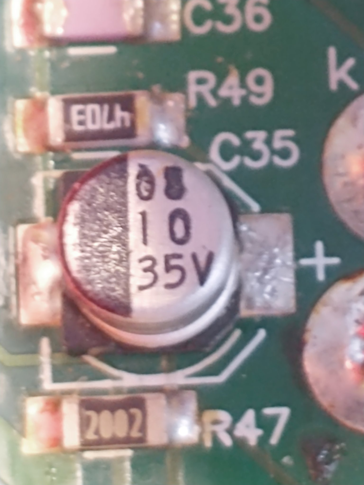

Pinged him and no response yet. But I decided to do some more signal tracing and discovered that the signal entering the C35 and C37 is balanced and the signal "exiting" not balanced. So I took the chance to remove the surface mount caps and replace with some 10uF Nichicon caps I have around. Signal is now perfectly balanced at the amp, but both channels are lower than before. So as I suspected I think the right channel was too high before and even the left signal was too high (but less so). The only thing is I'm not sure 10uF is correct, can somebody tell me how to read the numbers on this cap? The old caps measured .11 and .14nF.

Herman van den Dungen did respond, cool guy! He connected me with his service guy and they have tolerated my questions so far. They confirmed that C35 and C37 can cause extra loud output and distortion so recommended replacing them (I had already).
