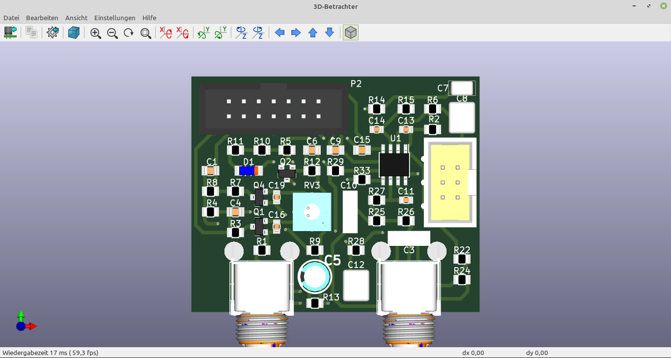

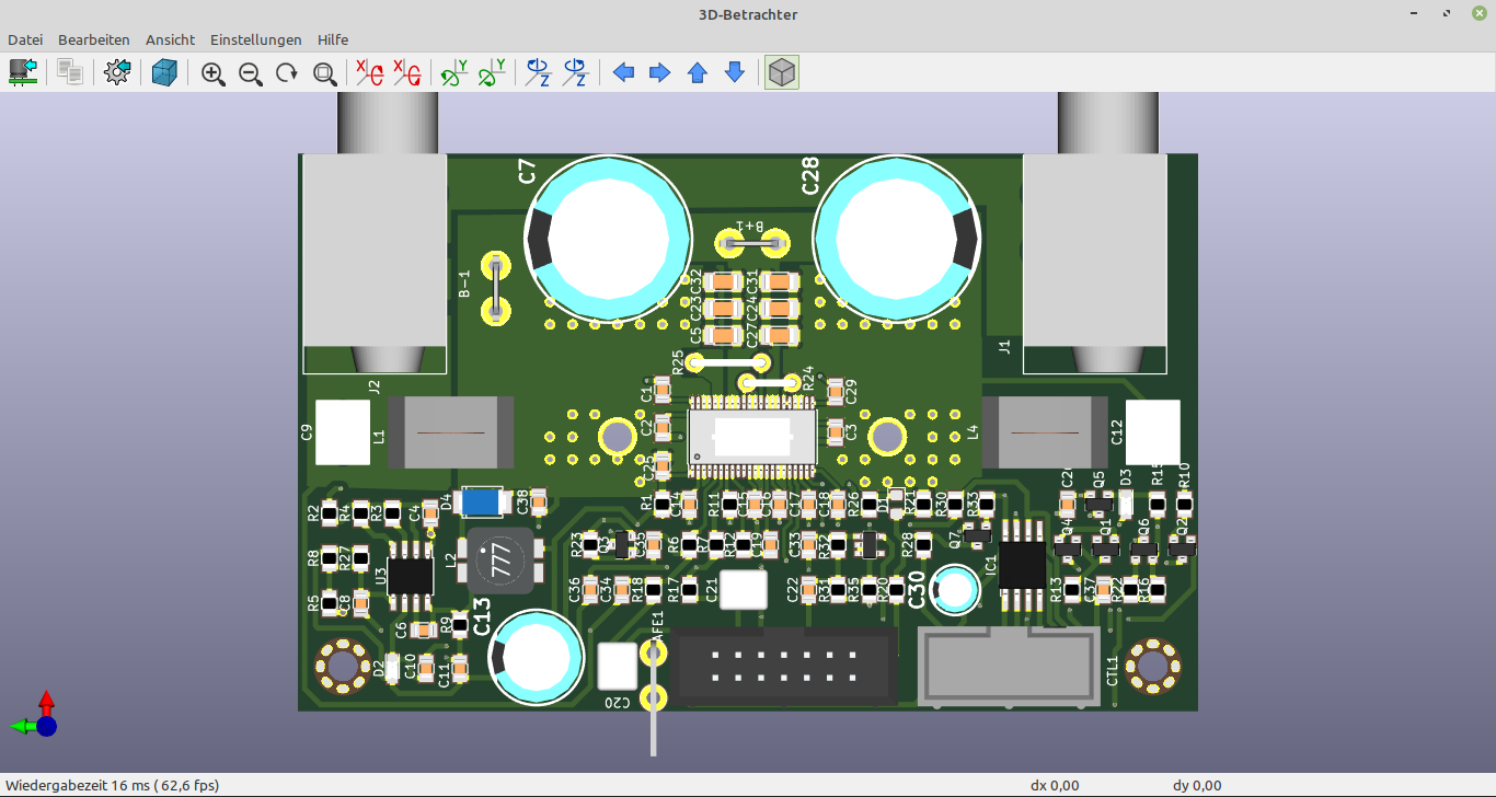

I am not that intrigued by real old stuff that I generally consider too bulky. But some old ideas concerning sound reproduction are worth to be transformed into newer and smarter hardware. And with some efforts DIY solid state technique outperforms DIY tube technique in size, weight, cost and RELIABILITY. No doubt this has taken a long learning curve. To illustrate what I am taking about I append two 3D-views of my latest modules that make up for a complete, simple amp outperforming 2xEL34/6L6GC stages.
