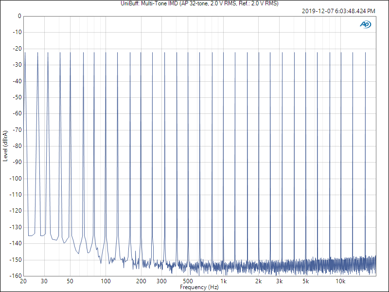

Any FFT is like that, though. The bin width is fs/N, where fs is the sampling frequency and N is the FFT length. That's why you get poor frequency resolution at LF and excellent resolution at the HF end of a log-f plot with an FFT.
I've attached an example. In this case, the test signal is 32 tones of equal magnitude, logarithmically spaced in frequency. Note how the skirt around each tone is much wider in the LF end of the plot than the HF end, even though the width of the skirt around each tone is the same in terms of absolute numbers.
