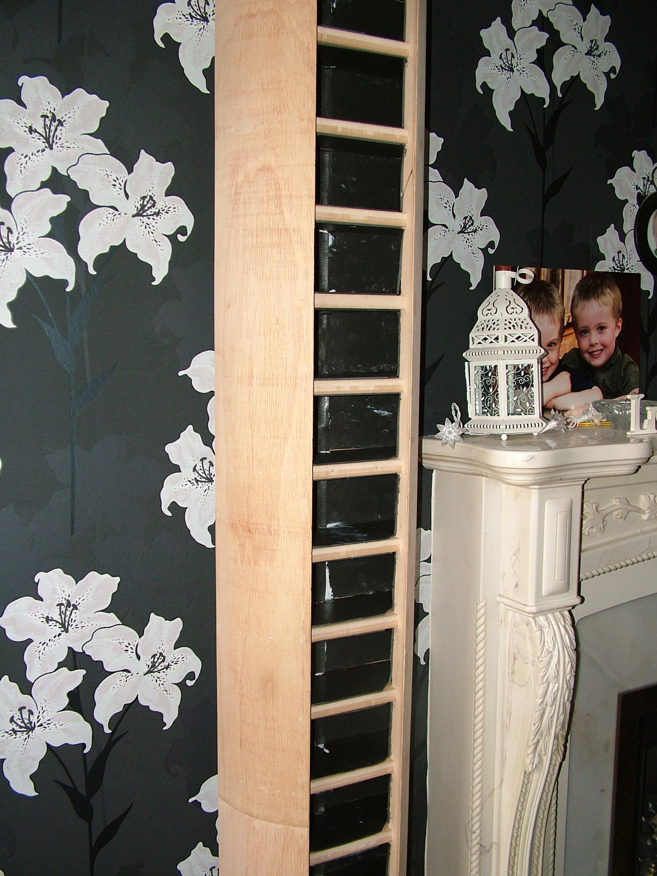

I am with you Line Source!
Its all about bringing the highest quality AV experience into as many real world family homes as possible.
If I had to call it I'd say in wall is the best choice, but only where one ( the family) has the luxury of being able to build / re-model their room to accomodate the speakers....Not too many folks really.
So On Wall gets my vote, easy to move around / upgrade / downsize etc.
Technically lots of advantages over floor standers and sonically can be made to sound astonishing.
Build in high efficiency digital amps / DAC's to the back of the speakers, this only adds approx 30mm depth or can even be ( although not the best way) included inside the cabinet.
Final stage is to include a HD ( 24 bit 192KHz or even up to DSD) WiFi reciever in the electronics and you have the dream team...On Wall, No racks, No Box's, No Cables (only 1 DC power supply cable into each speaker), only great sound!
Cheers
Derek.

True. I was just hoping to add more volume without having the enclosure jut out more than the minimum necessary. 🙂It looks good. It could be made even simpler if it's just a triangle shape and driver pointing inwards like you have there. Can avoid the extra angle and achieve easier to manufacture cabinet.
Another reason to add that extra angle was to give a 45-deg edge to the baffle instead of a 90-deg edge. Reduces diffractions, I believe?
Against a wall, a shallow but wide cabinet has less diffraction problems than a narrow but deep one of the same volume.

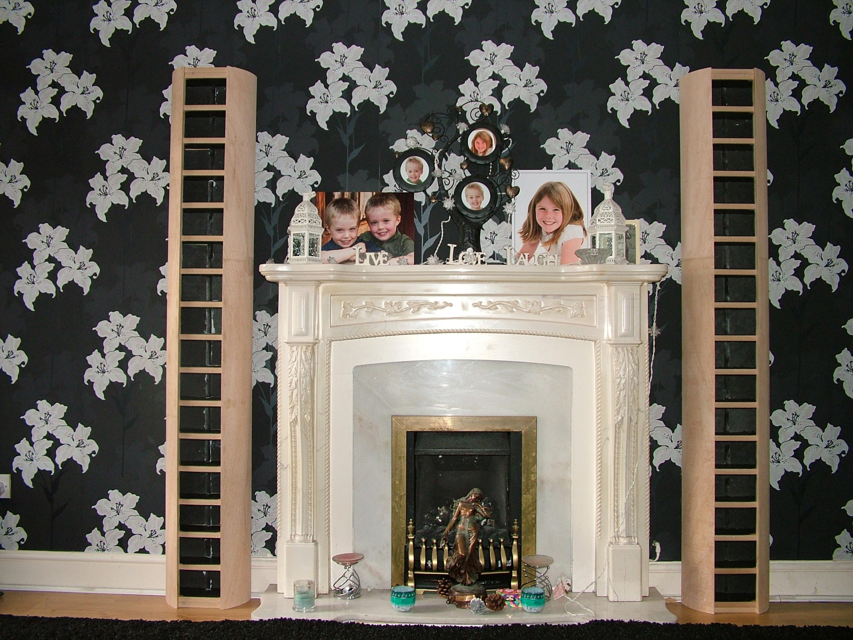

Hi SouthPaw ( Boxer?)
The thread is still active I think...I have not had a chance to finish the attached yet, but hope to get some time soon.
I really think that on wall and / or in wall is the way to go for DIY, really great WAF means the wives are much more willing to let you spend the money!
Also the " sound per £ pound " ratio is fab as the speakers benefit from the boundary affect rather than suffer from it...Location, location, location!!
My goal is to do design a range of on wall / in wall domestic and Pro loudspeakers which do away with pre-amps, crossovers, cables & interconnects, DAC's and all mains power filters and cables ( apart from a battery charger) i.e. have a battery powered system consisting of:
All digital source: A fanless media PC with A to D as well as digital inputs.
Signal transmition: WiFi. Min 350 Mbs per channel ( up to 9 channels ).
Signal decoding and amplification : True digital amplification with full DSP control.
Loudspeakers: On wall / in wall Line array with true full range drivers i.e. no subs required for music but optional for home cinema.
Aesthetics: Beautiful but subtle for on wall, invisible for in wall and robust but discrete for Pro.
Pricing : Aggressive!!
Hope to have some DIY Kits available in may.
Cheers
Derek.
