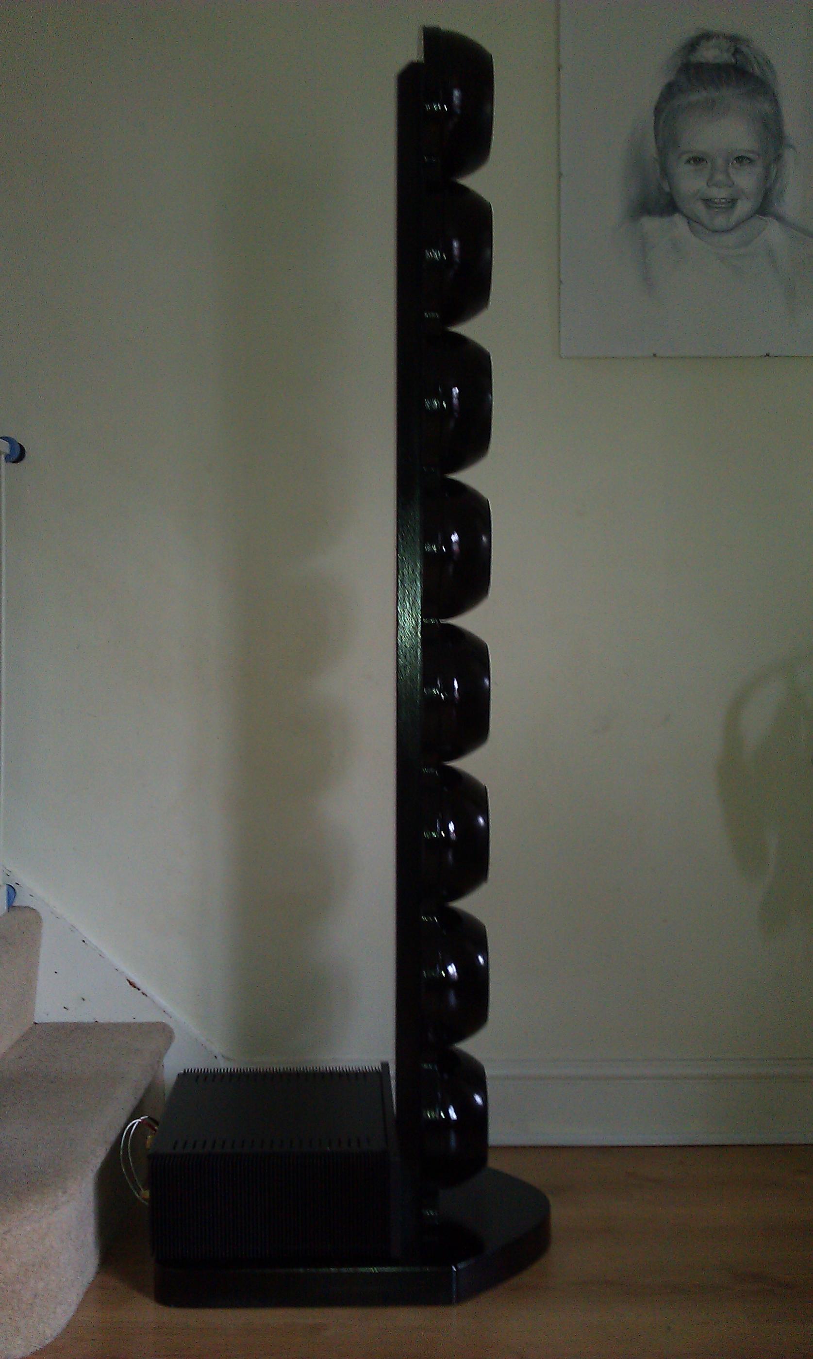

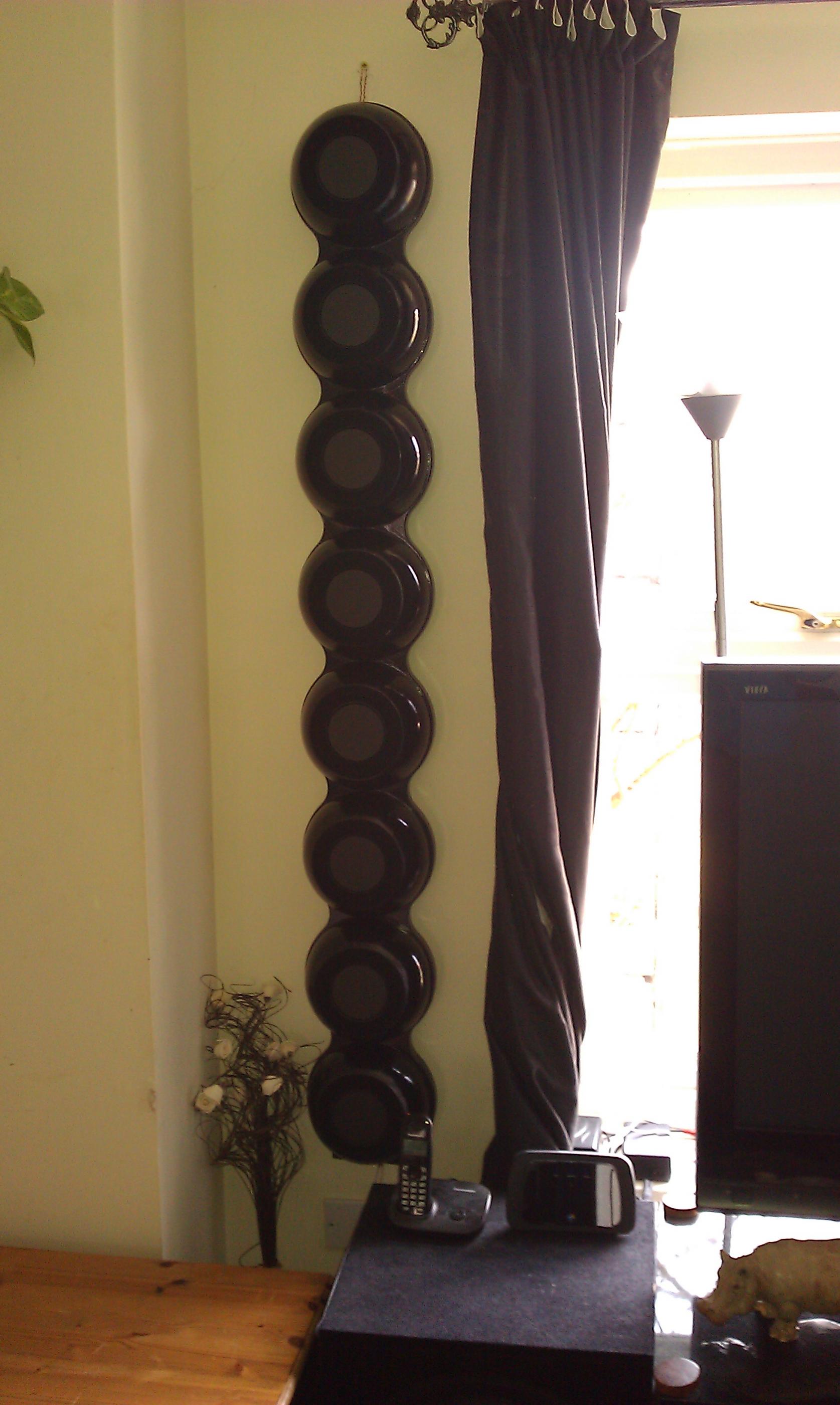

On Wall can be great.
After years of massive floor standers, sealed, open baffle, two way, three way, fully active, DSP ( DEQX) etc I have finally arrived at a great sounding, great looking High WAF, no hassle solution.
On Wall, line array BMR, full range ( no Xover at all for music) with Eq using the fab JRiver 18 media host with the even fabber(!) Jplay plugin.
On wall gives you "natural" low mid and bass extension ie no extra amp power input and no extra cone excursion.

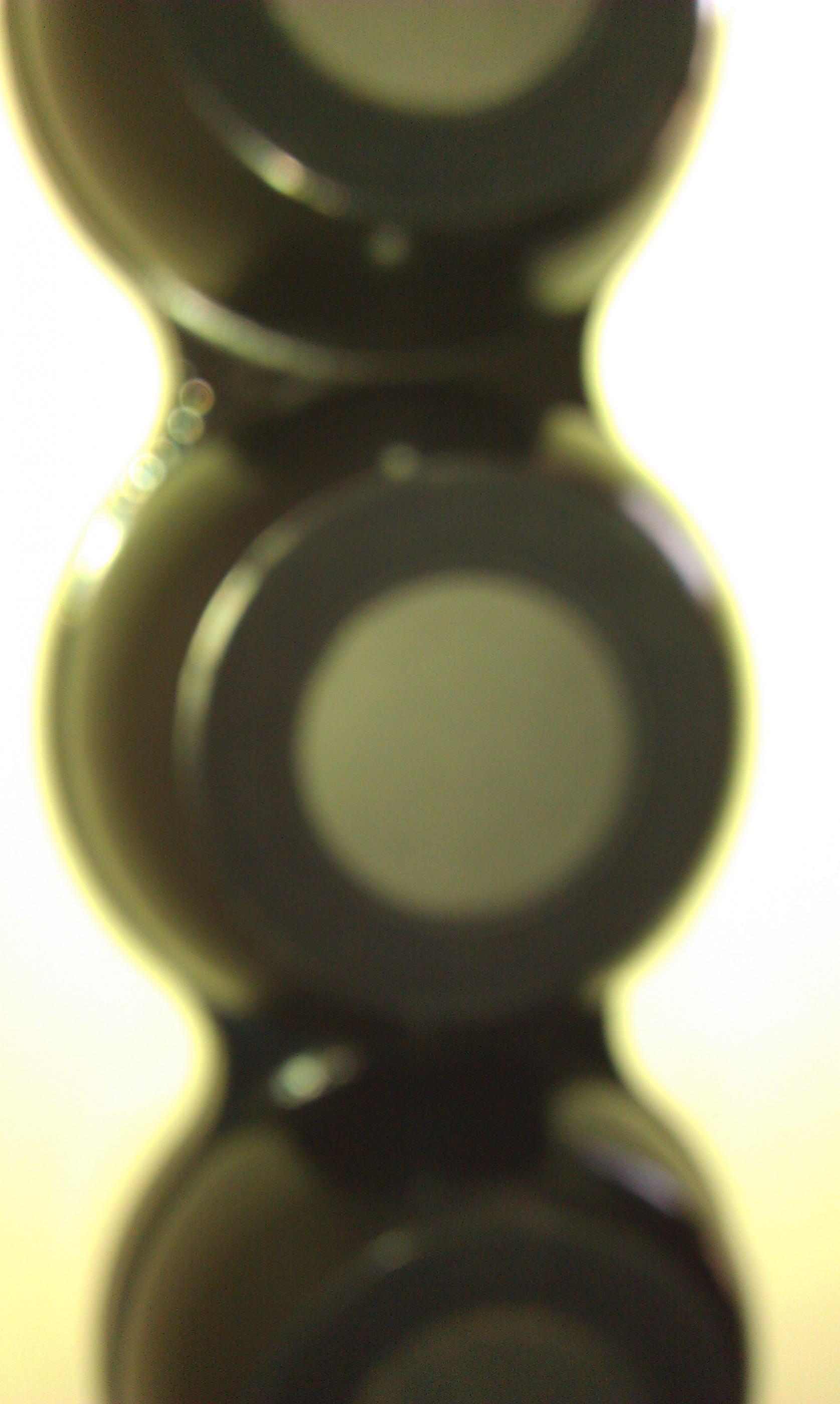

Using the BMR's gives you almost 180 degrees even power response ie on and off axis is all very even and balanced.
Line Array ( 8, 12 or 16 drivers per speaker) gives you a massive reduction in cone excursion and therefore a corresponding massive drop in all " traditional " distortions that the objectivists love to measure.
Far more important ( IMO), time domain distortions ie mass on a spring / cone on a suspension are greatly reduced as the cones are not pumping in and out 5mm or 10mm but only 0.5mm or 1mm instead.
I encourage you to try on wall or in wall line arrays, esp with BMR drivers, the results are really great!
Cheers
Derek.

Line array reading
There is a lot of reading material available on Line Arrays,some of it is actually true!
I would recomend a Google around and spend a few weeks researching the effects of placing a Line Array on or in a wall.
Then you need to look at the drivers you use, in particular the off axis response.
In the short term must say that I disagree with AllenB and Tinitus, I am curious to hear about the line array cabinets and drivers they have built and listened to on the wall...any photo's chaps...?
I am experimenting over the next month or two so I hope to have some more measurement based answers later.
At the moment the sonics of the on wall line array are so obviously superior to traditional free standing towers using the same drivers, I am loathed to change too much!
