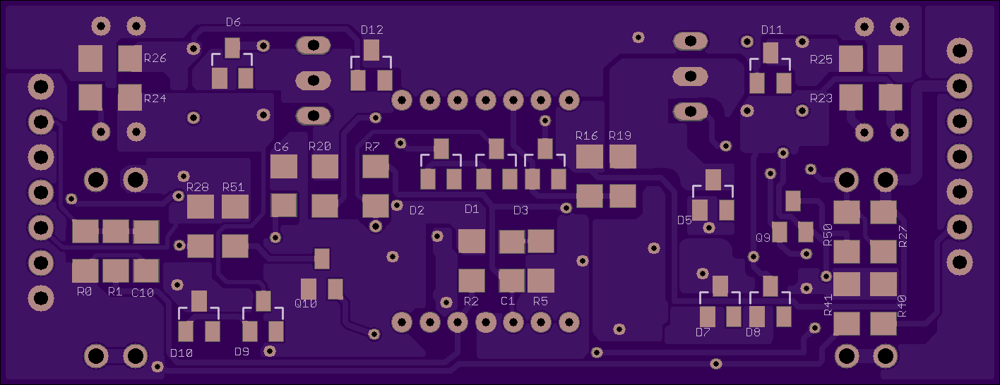

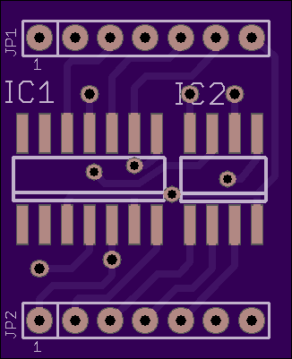

Quick update folks, I sent my boards off to fab tonight. I had to re-do my other unrelated design because I had lost the files from the last time I did it. I ended up ordering a crap ton of them. I needed a fair number of the boards for my other project, and it turned out that if I could come up with a total of 100 sq inches of board that I could get them made significantly cheaper. I know this was risky, that I might have errors on the boards, but the quantity order made it cheap enough that I am willing to take the risk.
So far dealing with OshPark has been painless and I submitted the board only a few hours ago and it has already been scheduled for a panel going out in a few days. I am really looking forward to getting these in hand. It will hopefully be the culmination of a lot of work!
I ordered about 10 extra of the daughter boards because it seems they get mangled whenever a shadetree tech tries to repair these. With any luck I got the measurements correct and they will fit the factory boards as well. I have my fingers crossed!
Here are the renders from OshPark in case anyone is interested:
And they are here! YAY!
A few things almost bit me. The pin header holes for the small daughterboard are almost to small. Like, frustratingly close, but can still get it in 🙂 and I did the same thing for the poly caps. I did the drawings for both of these parts, as well as many others. I used the datasheet sizing, and I must have put in the exact pin size instead of going a bit over. They both fit, but just barely. I am glad they don't have to be scrapped, but time will tell if I made any other mistakes. I am halfway through populating one of them. Have the back side done except for two resistors. They are supposed to be 22R and somehow I managed to buy 2R2... Hopefully nothing else bites me and they work as planned. I have 20 main boards and 30 daughterboards.
Pics for proof 😀 :
Pics for proof 😀 :

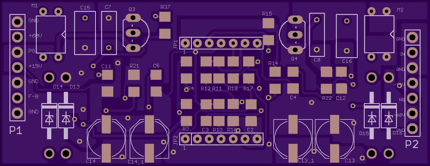

Joris, the DLI4060 house chip serves the same purpose the comparator/op amp. I assume it is just two dies in one package. I have another acquaintance from the board with whom I was in contact by email, and he confirmed that the circuit in daughter board from my drawings here worked in place of his daughter board with the house chip.
As far as I can tell all the amps that have these boards use the +/-9 volt supply. The DLM boards themselves are silkscreened +/-15V, I am guessing they are tolerant of 15V supply, but I have yet to see it implemented.
Also, my amps with failed DLM drivers were not failures of the comparator/op amp but of the driver circuits. I believe that both of Adriano's were failures of the house DLI chip, so you might be on the right track. If you start a thread here about your specific amplifier then you will get a lot of troubleshooting help from people who are much smarter than I!
I have also now used my daughter board on a DLM amp that had the bare die epoxied to the board and it worked there as well.

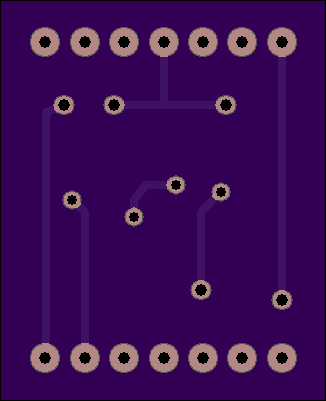

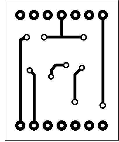

I had forgotten that I never posted the DIY etching templates for the corrected headers on teh daughter board. I recently had a gentleman PM me requesting the fixed templates for the daughter board. They are attached below. The bottom side is mirrored and the overall dimensions should still be .65x.8

Thank you, Jason! This is actually useful as in my case for example the actual fault was in the ICs after all.
One minor thing and a note to anyone who would use this template - you can't flip the back side as the pcb will not match the ICs pinout, what you really want is to flip the front side.
So both pictures above should be flipped to match the real pcb layout.
