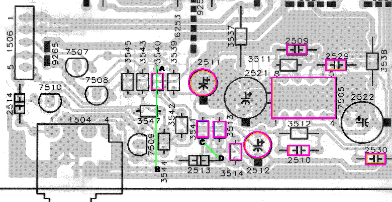

I write from Sicily, about mods i've done to my cd 723, as suggested by Nuuk in its site Decibel Dungeon.
referring to this, I hav a doubt about the correct placing of rlc folters on output; as reported in the picture, the green line A-B starts from 3540, which is the resistor on the path to R out for the headphone facility, and green line C-D starts from 3541, which is teh resistor on the path to L line out!
IMO one of the two is wrong, and I thought it's A-B: A should be placed on the lower pin of 3542, I think...
I asked to nuuk but he didn't remember, and said me to ask in this forum.. can anyone help me (expecially Massimo, which is reported as the prompter of this mods)?
thanks,
Giuseppe
