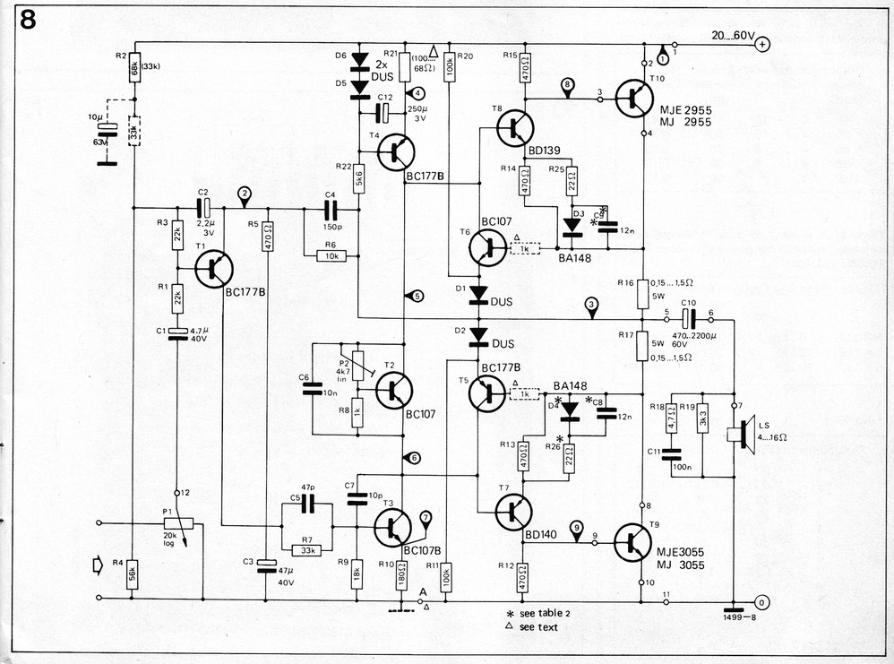

Equin single rail power amp, with modified Quad303 triple cascade , came in Elektor January 1976
Parts PCB foil were sitting around in some box for almost 40 years.

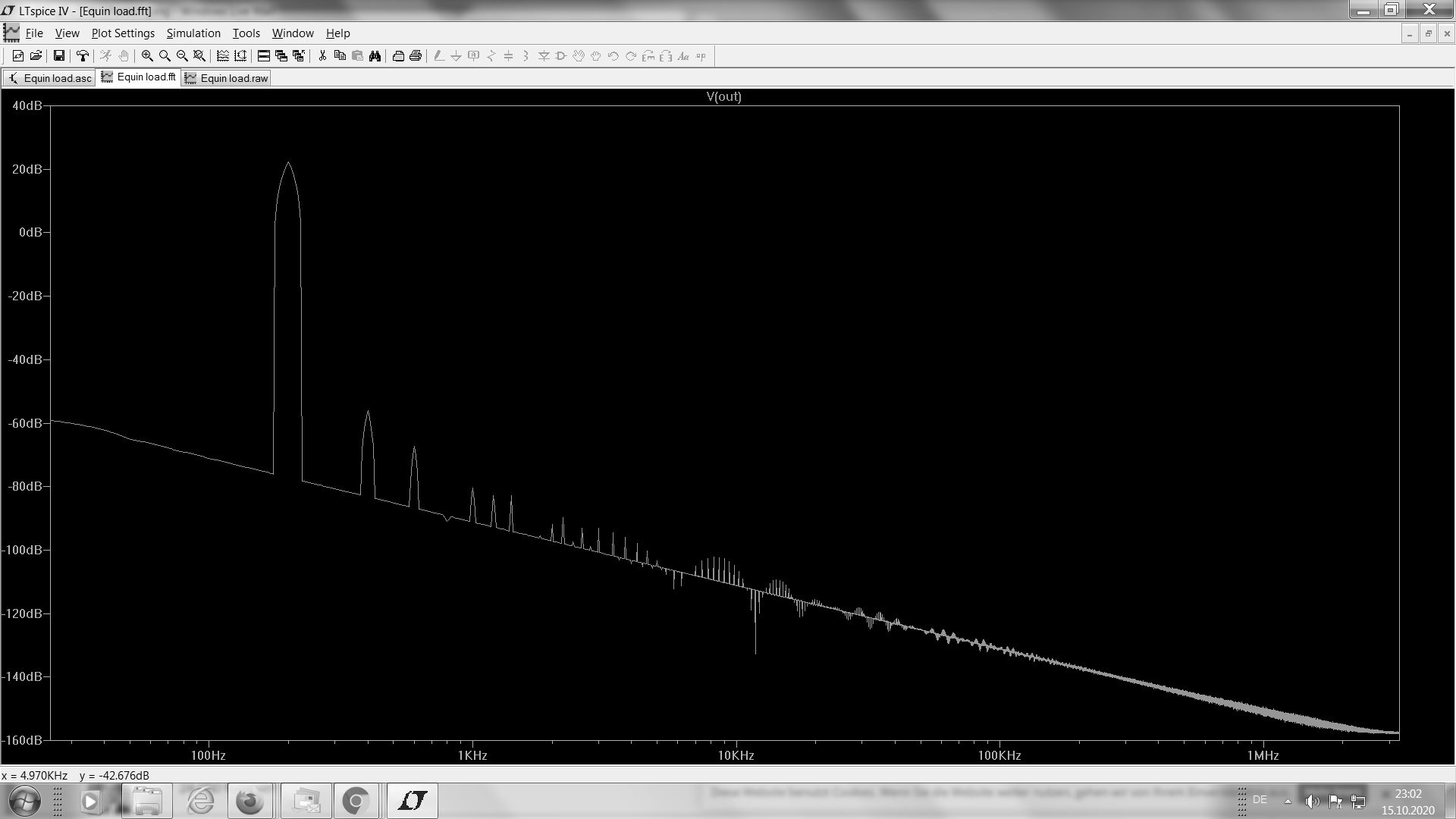

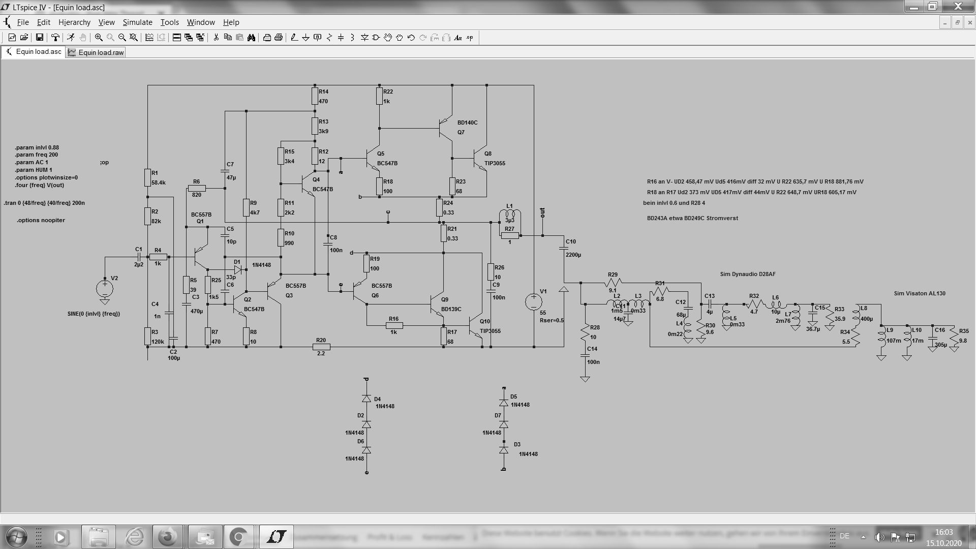

LTSpice sim comes almost too good to be true. Perfect harmonics spectrum.
Result shown with sim of two way speaker at 200 Hz, the frequency where most music with acoustical instruments has max amplitudes. The speaker has exactly at 200 Hz impedance minimum. comfortable 4 ohms. More simulation required to test emf feed from speaker , and thermal distortion. Harmonics spectrum remains unchanged with frequency like a tube amp. Thd at 42 watts is 0.012905%

From a quick glance at both Equin and Equa schematics or pcbs, it appears that the bias transistor is not in direct contact nor near the outputs heatsinks. Is it correct?
the bias transistor is for compensating ambient temp . Simulation LTSpice assuming that the temp variable refers to junction temp the dc current power bjts varies from 60 mA at 20° to just 100 mA at 120 ° that is just the trick with the feedback in the triple cascade. And that without time lag. However the feedback is also ac and that should be a problem with the rather slow TIP3055
EQUIN has "solved" that with low impedance drive of the triple cascade with emitter follower . 2SC5200 could be the perfect choice but Toshiba only !

Regarding CFP and triples, then I've always thermally coupled the bias to the first driver pair, and got very good stability of the quiescent current. Even using low speed (4MHz) epi devices, I've needed to add suppression capacitors to stop oscillations, and if I were to use high speed devices in a triplet I'd suggest using a CFD configuration (complementary feedback Darlington) which may be easier to stabilise.
Hahfran,
Could you sim the open loop and thus analyze stability of the the Equin? I built it in 1977
(btw: called Ekwin in Dutch) and although it worked, I had stability issues I could not solve back then. One of the two channels always ran hot.
