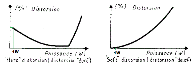

Even if the amp have 0.01% or 0,0001% THD I think is important parameter how that dynamic distortion is developed in function of output power , special inside of the First Watt area.
Reactions: adason

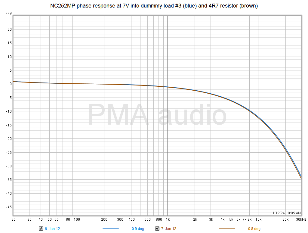

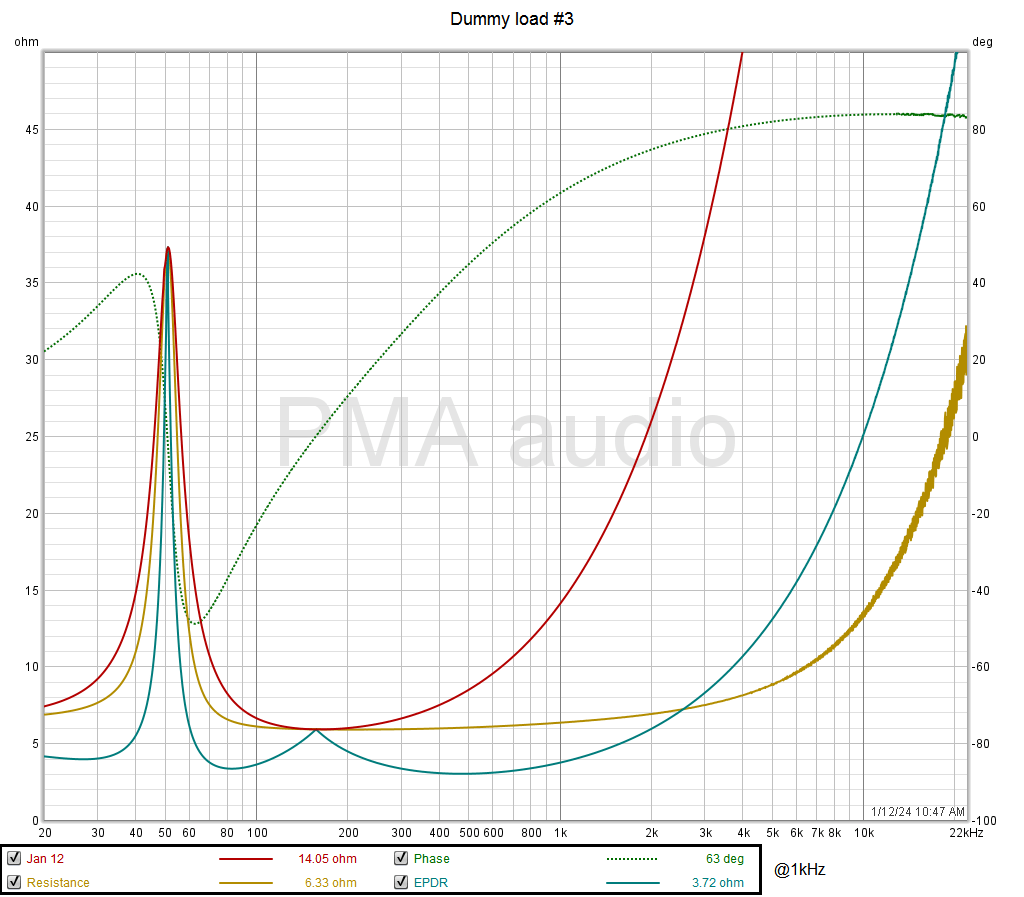

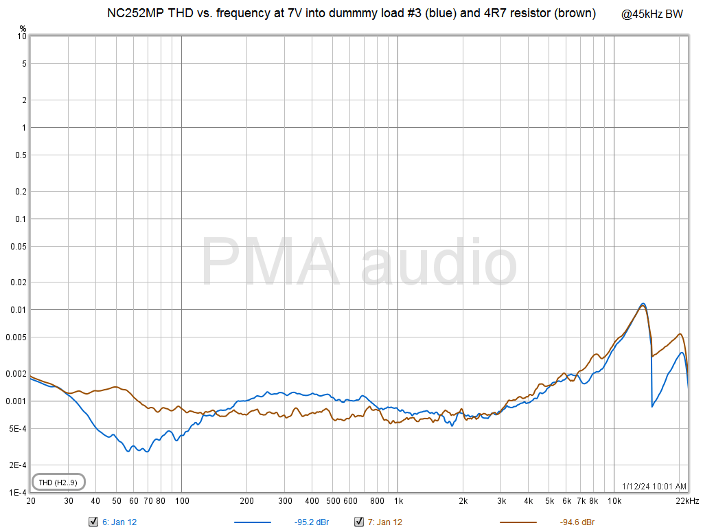

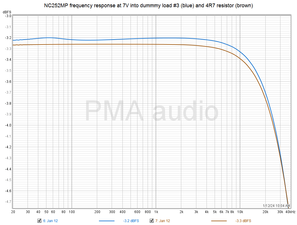

Examples of complex load influence on frequency response of the amplifier with very low output impedance (high DF, damping factor)
First, load impedance magnitude, phase, resistance and EPDR
Effect on amplitude response (y-axis dB relative to ADC FS input range), compared to 4R7 resistor load
(negligible)
Effect on phase response, compared to 4R7 resistor load
(negligible)
Effect on THD vs. frequency, compared to 4R7 resistor load
(reflects EPDR and resistance of the load)
Reactions: dennis h and Bonsai

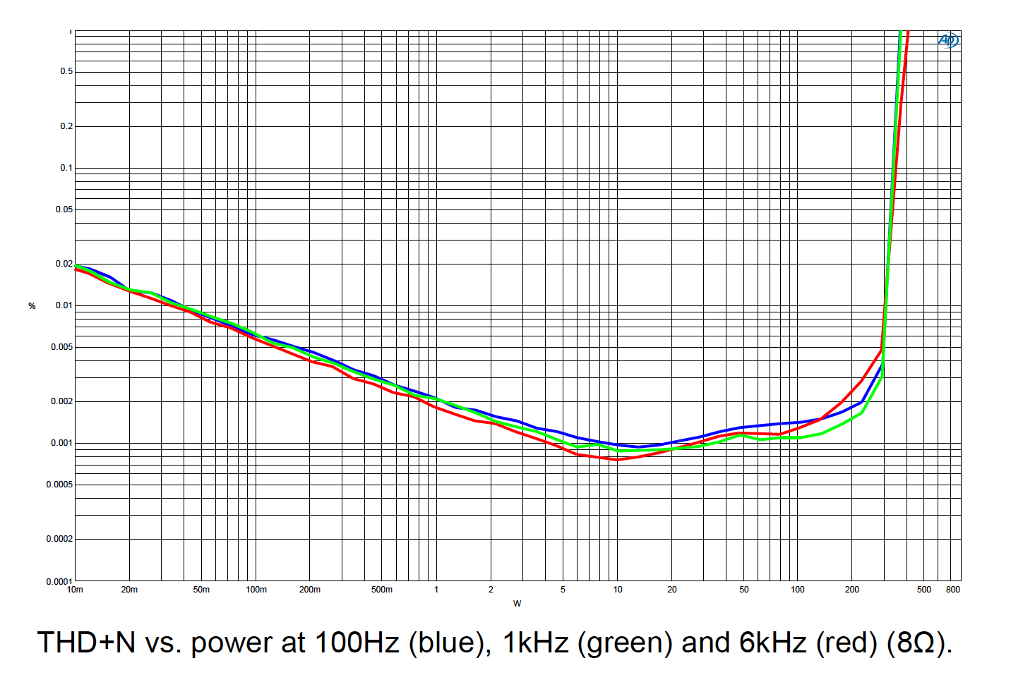

The plots are obsolete nowadays. None of the well designed amplifiers will have such low idle current and such high crossover distortion as shown in Hiraga image. We are not discussing toys here. Jean Hiraga has done not very good service to audio community with his misleading articles. Worse, he shows no dB or % on Y-axis.
Well designed amplifier measures like this
You do not need rise of distortion with power. Both Hiraga or Pass amplifiers, beloved by audiophiles, will have higher THD even at low power. And even this measurement shown is limited by system noise at low power, not by amplifier distortion.

regarding to my atachment from my post # 432 I think that there Hiraga was very right , but I admit that your diagram show THD plot of one fairly good designed amp , on the other hand many and most of other AB or D class comercial amps don`t shows such relative linear THD charachteristic , here`s the diagram example of modern Hypex NC502mp D-class amp , (second diagram is corrected by me ) .

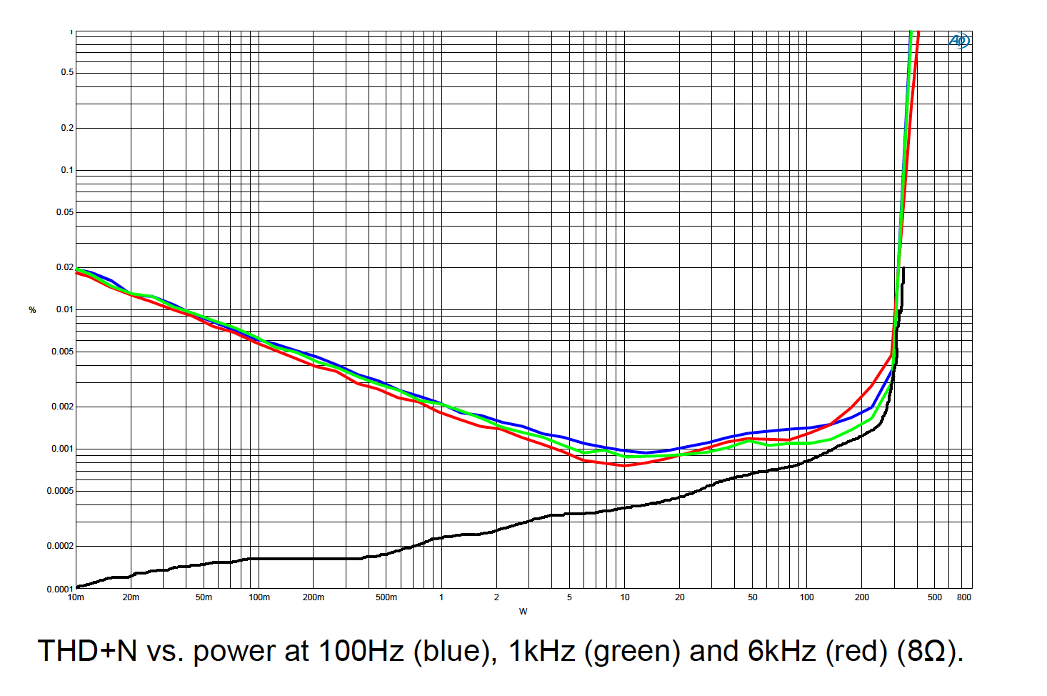

btw, Personally, if I am in a position to choose between two amplifiers where one has a THD of 0.001% but with a worse percentage of distortion within the first watt and the other amplifier which has a THD of 0.1% but with insignificant distortion within the first watt, I would certainly choose the latter.

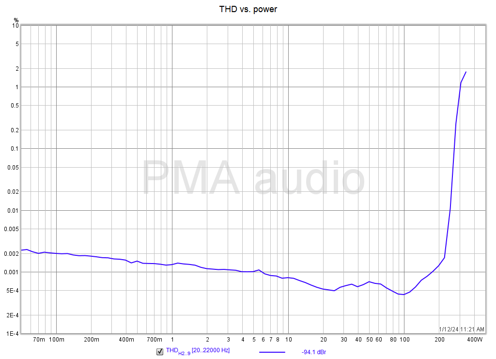

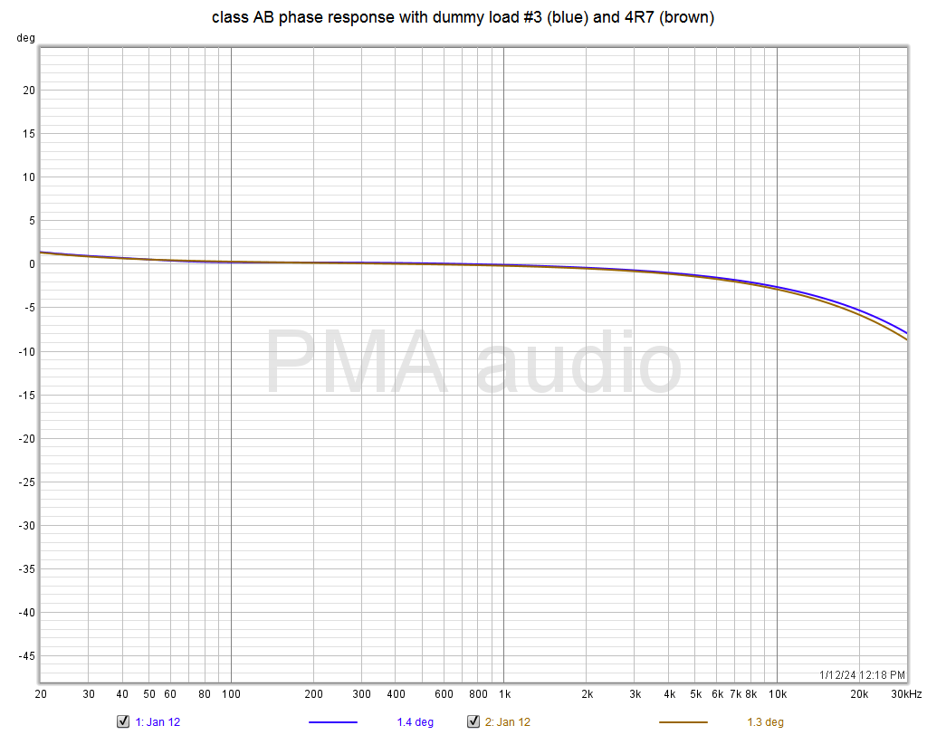

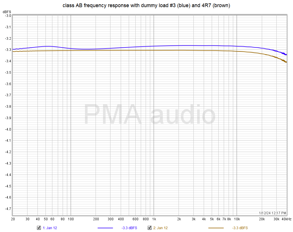

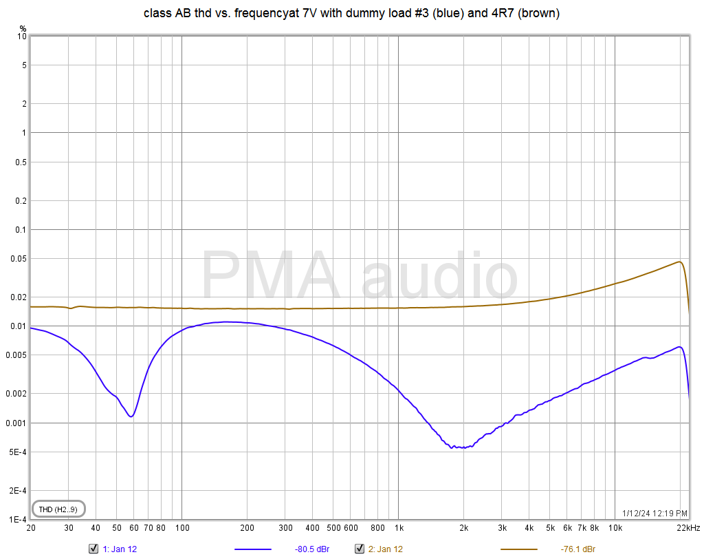

Same plots as in post #433, now for class AB amplifier that has wider frequency response, but also higher output impedance.
@Bonsai : Andrew, may I kindly ask you how would these amps be scaled by your score rating? 😉
One can see that distortion of the Hypex class D amplifier in post #433 is much less affected by load complex impedance. Interaction of complex load and class AB output stage.
classAB_dummyload3_4R7_freqresp.png classAB_dummyload3_4R7_phaseresp.png classAB_dummyload3_4R7_thdfreq.png
View attachment 1259097 View attachment 1259098 View attachment 1259099
