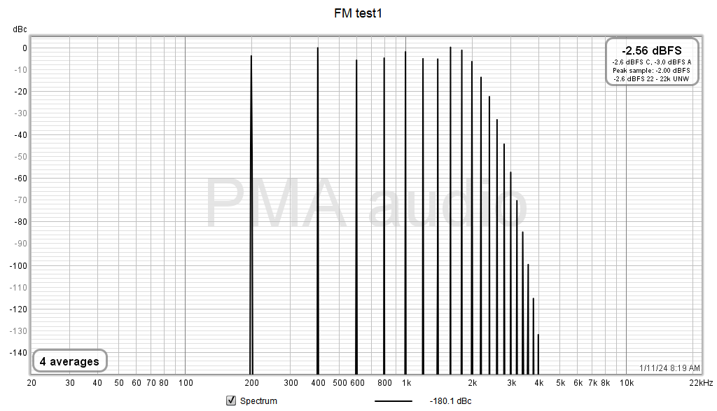

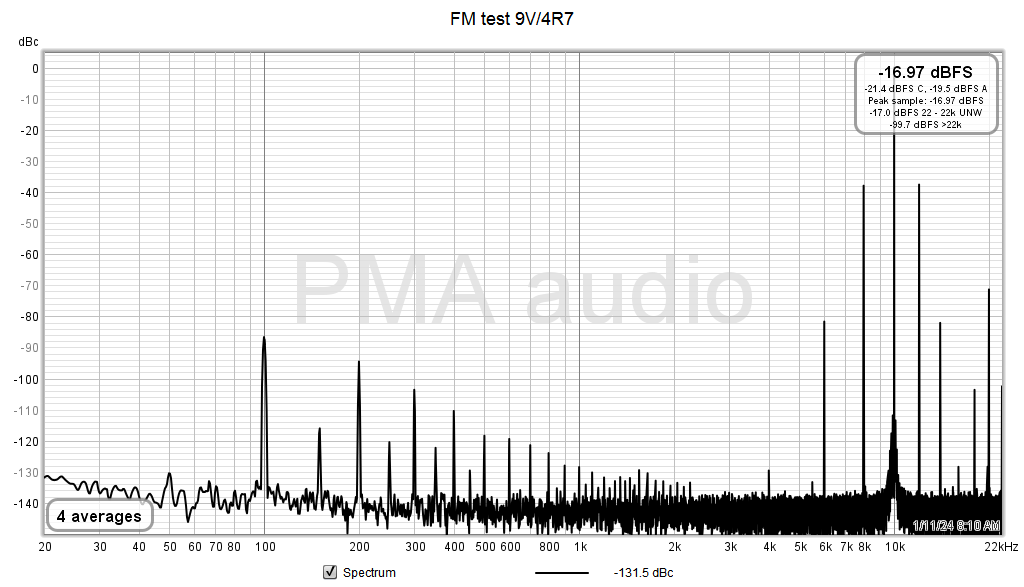

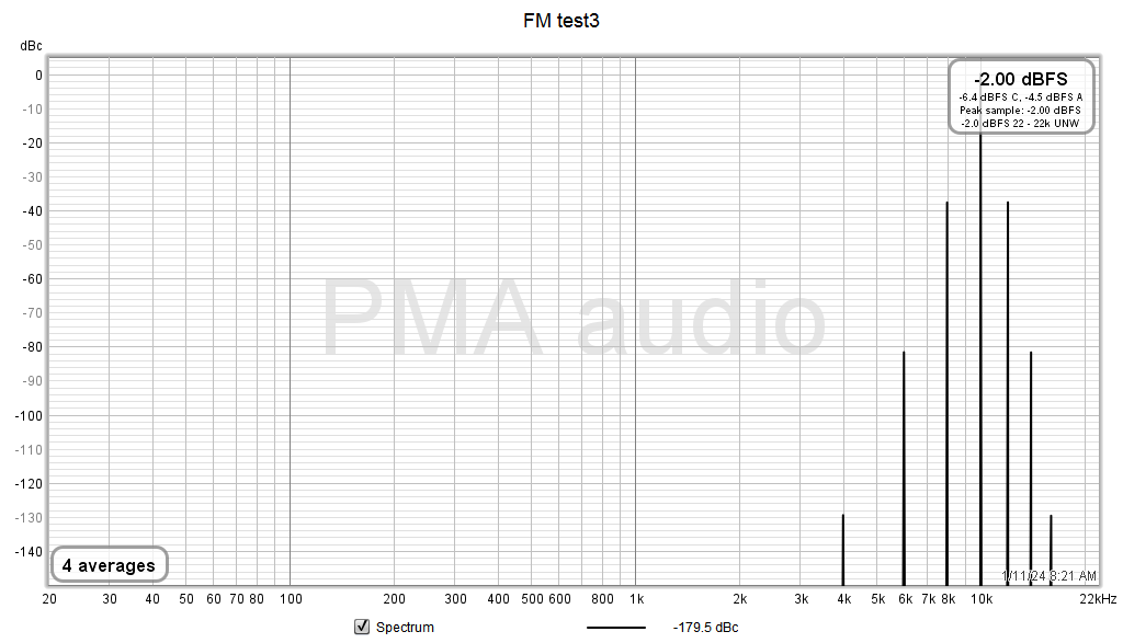

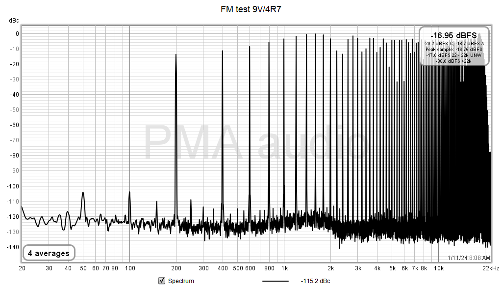

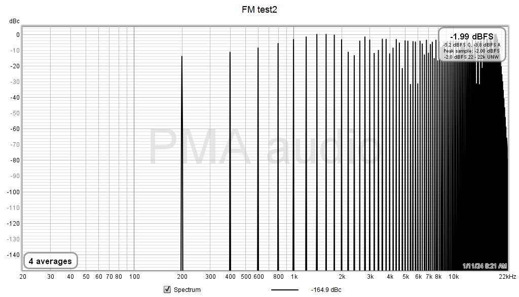

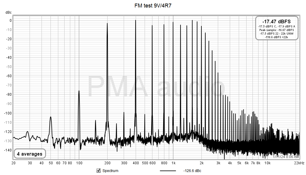

@Bonsai , I am using a set of FM signals, more here:
https://www.audiosciencereview.com/...istortion-with-fm-modulation-technique.37697/
Some results, original signals + responses:
Please also note a different LF hum rise.

I am afraid there is no chance to develop a number from these FM tests. What I am observing is a noise floor modulation (you can see it in my post here above) and also PSR issues, mains frequency components throughput that depends on signal composition, though the test level is always same. I thing both these issues should be minimized with a good amplifier design. My view is that it is difficult to make an essence of parameter numbers, because the possible problem is too complex.
