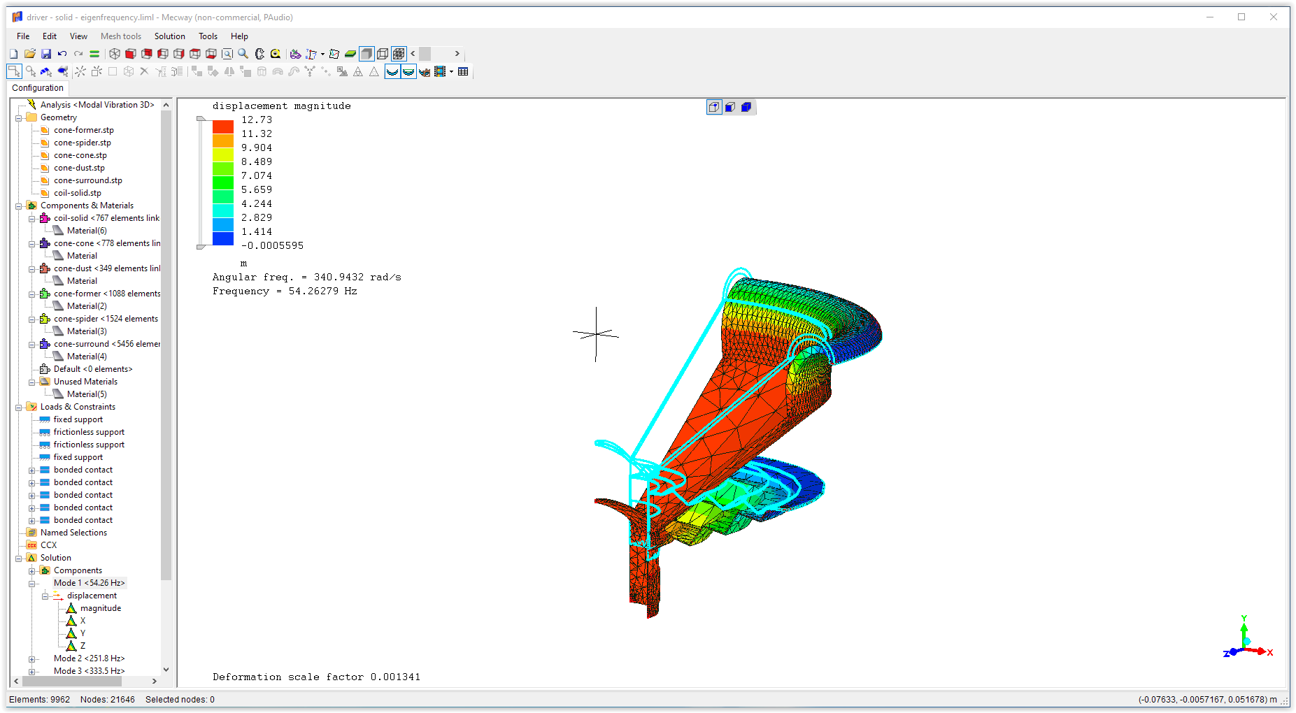

A hypothetical woofer is used in the following Mecway modal simulation. A quarter of the 3D-solid model is used to reduce complexity. The model is initially created in a 3D CAD tool. It is exported to STEP for Mecway importing. Since fundamental frequency is target of this simulation, the use of symmetry planes is acceptable. The fundamental (resonance) frequency of this mode is 54.3 Hz as shown in the figure.

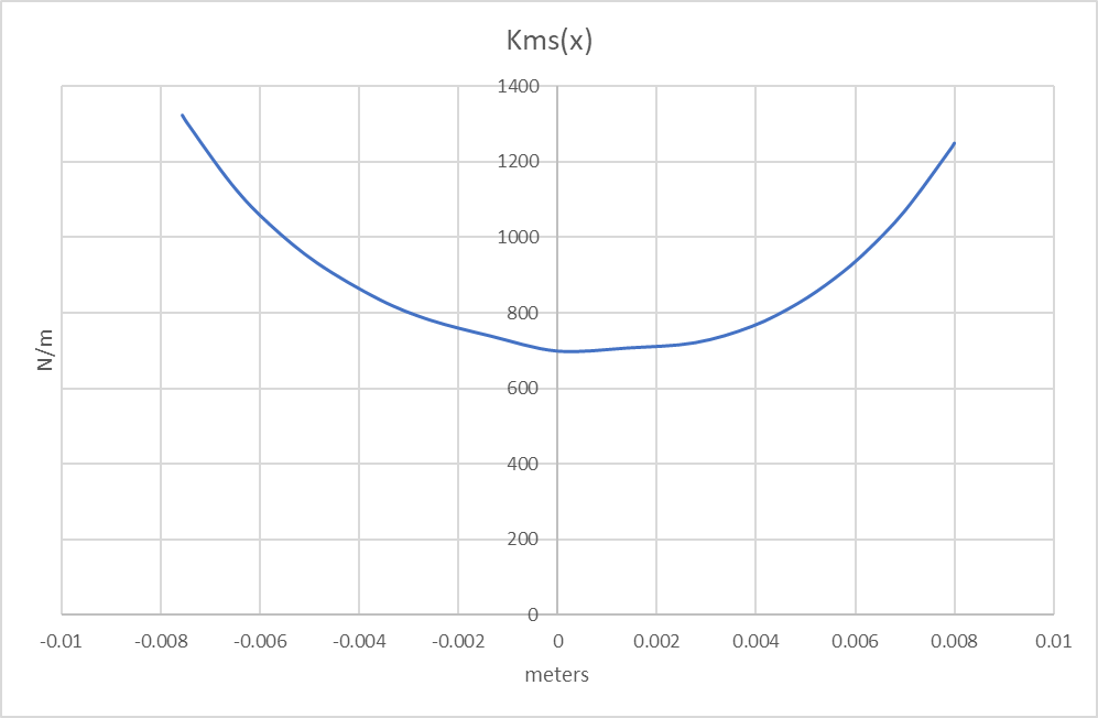

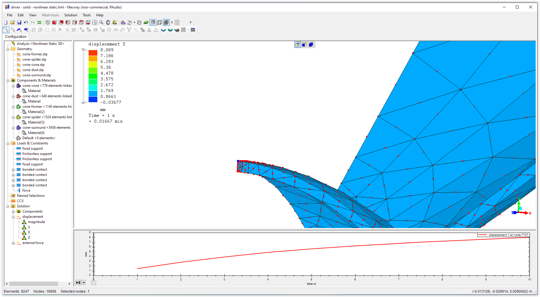

A y-axis force constraint is applied to the coil elements. The force is varied from 0 to 10N (or 0 to -10N) in nonlinear quasi-static simulation (CCX solved employed). The solver takes care nonlinearity of large deformation (surround and spider). Displacement of the dust cap is not a linear function to the applied force. If we export the data to excel, we can obtain Kms vs displacement as shown. As shown, the suspension (surround and spider) stiffness at resting is about 700 N/m. Symmetry of it is not perfect. The coil-in direction is a bit stiffer.
We can fine tune the surround and/or spider geometry to optimize the Kms(x).

LISA and MECWAY are great. I haven't used them in a long long time... maybe 6 or 7 years since I last used it. I've been thinking about buying the latest versions though as it's a much more useful program compared to what I have been useing for the last few years. They are inexpensive and very powerful.
I see you've applied material properties for the different components... very good. What materials did you use? As in... how did you apply any fabric material such as for a spider or suround...??? Or how did you account for impregnated fabric? Or did you have some other homogenous material you worked with?
Also, I am sure LISA and MECWAY can do some other things too...
I used the material parameters of the COMSOL example Loudspeaker Driver Tutorial Model in the Mecway model.

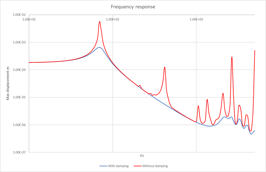

Mecway/Lisa doesn't have frequency domain solver. We would need to use many dynamic response runs to obtain the response. Displacement data of each run can be exported to software like AKABAK 3 (boundary element solver) to make acoustic simulation.

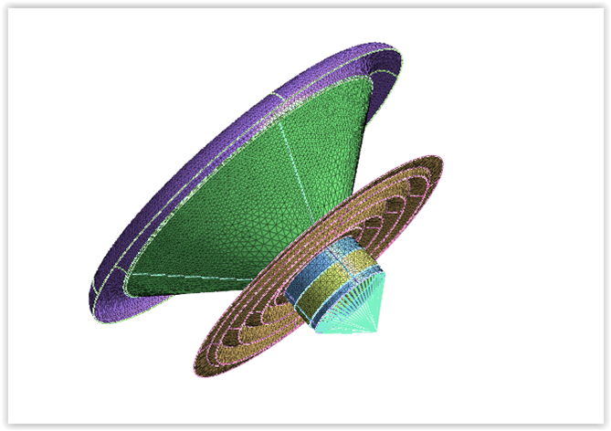

The model in Mecway is also imported to another FEA code, midasNFX. Shell elements are used for all parts (except coil) of the driver. Coil is in solid elements. Full 3D geometry is considered since resource for using shell is relatively minimal compared to solid. It would take long time and huge memory size. Direct frequency response is used to obtain max. displacement vs frequency as shown in the figure.

Hi Bes,
I can't agree more for your points. Without proper material parameters, the FEA results would be questionable. Getting material parameters is always a challenge to us. Suppliers may not able to feed us the data needed for FEA. Static vs dynamic is another challenge. Most of the time we can just obtain static parameters. Dynamic measurement by, e.g. DMA is expensive, limited or simply not available.
These obstacles are not blocking us to use FEA as long as we know the limitations and carefully interpret the results. Using basic material parameters, we can have initial design made. We know some basics of the design. This is an important stepping stone of the following steps.
We do see good correlation between simulation models and prototypes. But nothing is perfect. Tweaking, fine tuning ... never end.
