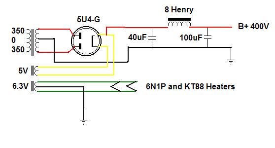

Here is my PS schematic. Really dead simple. The caps are ASC motor run (not start ) caps. Cheap and very effective. My PTX is a Hammond 273BX (remember I made monoblocks so each PTX only has to power one channel). The choke is a Hammond 8 Henry.
My mains voltage is a little high so my B+ is closer to 425 than 400 but still well within 10%.

That schematic isn't really the same as Mikael's. Mikael's schematic is much simpler and uses only a single triode (1/2 a 6N1P) in the input stage rather than two triodes (or both halves of a dual triode). Also this schematic has a feedback loop, Mikael's does not. All in all a quite different amplifier (but it does look interesting!). I do like the decoupling of the PS, something I ended up doing with my monoblocks.
Also there is a problem with the PS schem in that design. The 5U4-G has only 4 pins, not 5. Also the maximum value for the 5U4G is 40uF for the first cap in a cap input PS.
One , two or none . The schema shows four pins for the 5u4G .
The other problem : No music lover " audiophile " or not will deny the superior musicality of the new SiC Schottkys diodes as rectifiers against any rectifier valve , so the cap can be 100uf and

You are right about the number of pins! I don't know what I was looking at as a second quick look confirmed it for me. However the schematic does still show a 100uF cap following the 5U4G.
I have a 5U4GB here, and it does, indeed, have five pins. This one is branded: "Realistic Lifetime", and says in finer print: "E. T. A." within a small ellipse, and "Japan F4". Two pins connect to the cathode, the other two to each diode plate, and that odd pin has a small metal tab spot welded to it on the underside of the lower mica spacer. The rest protrudes about 1/4" above the spacer, and is bent some 30 deg towards the right-hand diode plate. Looking at it through a magnifying glass, it's obvious that it was simply snipped off with a pair of dykes.
I don't know what that's all about, but it looks like connecting that thing to anything is just asking for a flash-over. :bigeyes: You'd think that if they needed an extra pin for stability in the socket that there'd be no need for an extraneous metal/glass seal for an apparantly "useless" connection.
I agree: 110uF in the P.S. is way too much. A 5U4GB may be one of the beefier vacuum power diodes, but its surge rating is still just 1.0A. I doubt that a pair of them with plates in parallel could handle 110uF. :whazzat: That supply will go through 5U4GB's pretty quickly.
