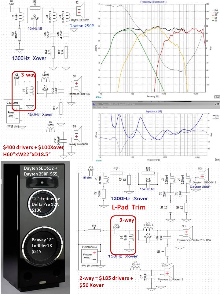

I'd like to build a speakers using affordable drivers like the kind you can get at Parts Express that's relatively efficient similar to the JBL L100T3's I have.

You've picked a number of difficulties. Cheap, three way, and efficient... 🙂 If you could give up one or the other....
For instance, what about a coaxial from Eminence? Fairly high in the efficiency range, inexpensive, but 2 way.
If you must do a 3 way, how about starting with a 10" Beyma professional driver? Around 95 dB but you'll loose some of that in the baffle step. About $200 for the 10G40
Also, if you are designing it yourself, a 3 way speaker is twice as hard compared to a 2-way. You'll have to do a lot more work. If this is a new project I'd highly discourage you from designing your own.
Also look at Madisound and Meniscus kits.

Dayton Audio PA310-8 12" Pro Woofer
This one looks like a good candidate. What do you think of it?
That looks like it's on the right track. Both low in cost and very efficient.

No. 🙂 The issue with woofers is usually baffle step. You usually end up loosing some efficiency to get deep enough bass. You want tweeters to have equal or greater efficiency, so you can pad them down to match the woofer after the LP filter is applied. If your woofer is more efficient than your tweeter, you end up padding the driver that will have the highest power. In other words, padding the woofer wastes the most amount of power.
Take a look at the LM-1 thread, there's a simulation file there for the LM-1C. You can compare the "raw" driver with the driver after the crossover to get some idea. The LM-1 has barely any baffle step so it's a bad example. 🙂

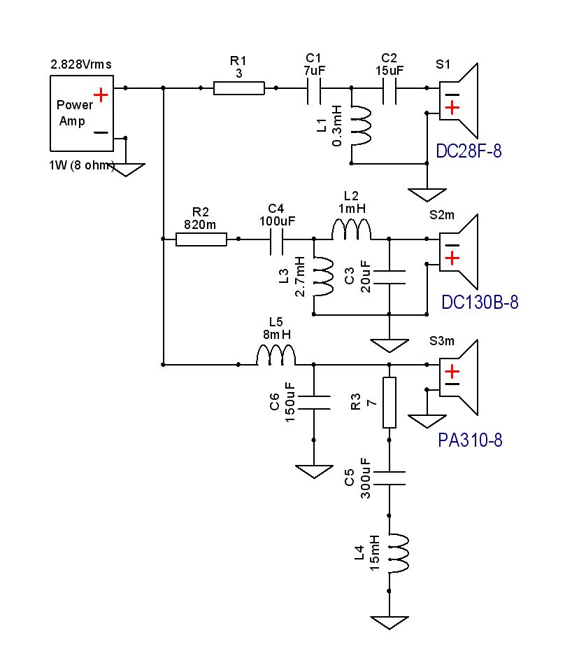

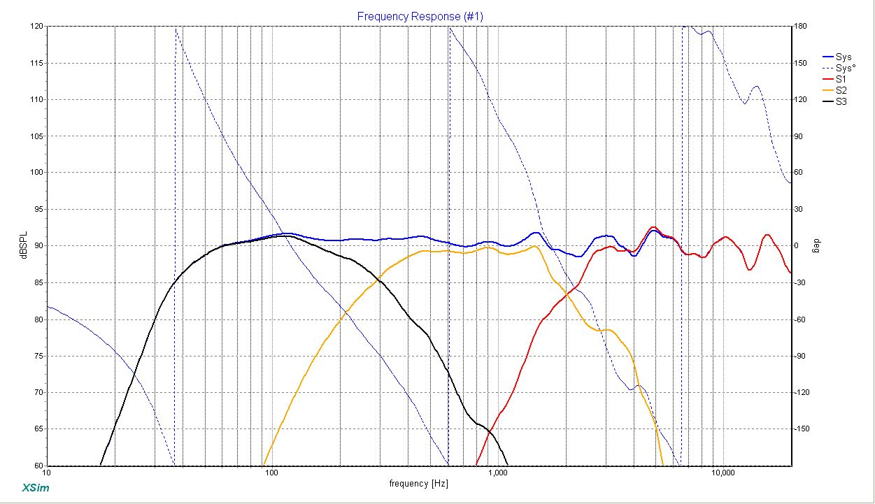

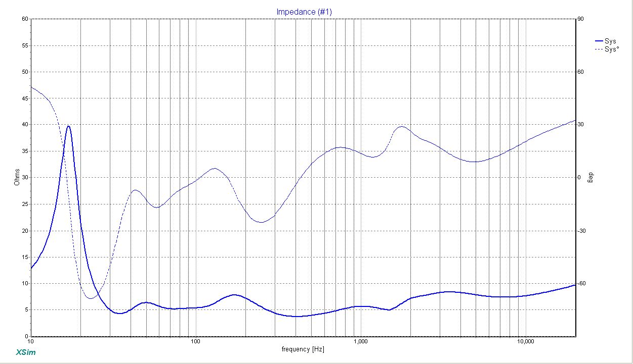

Dayton Audio Project - Playground
70 litre BR, W=13", H=45", Fb=40 Hz, midrange delayed 20mm, woofer 50 mm.
Dayton measurements came in handy for a quick sim. Mid was simulated in a 7 litre
sealed box. Roundover 0.25", drivers vertically aligned in the centre of a baffle.

Daniel Hertz M1 $100K Speakers

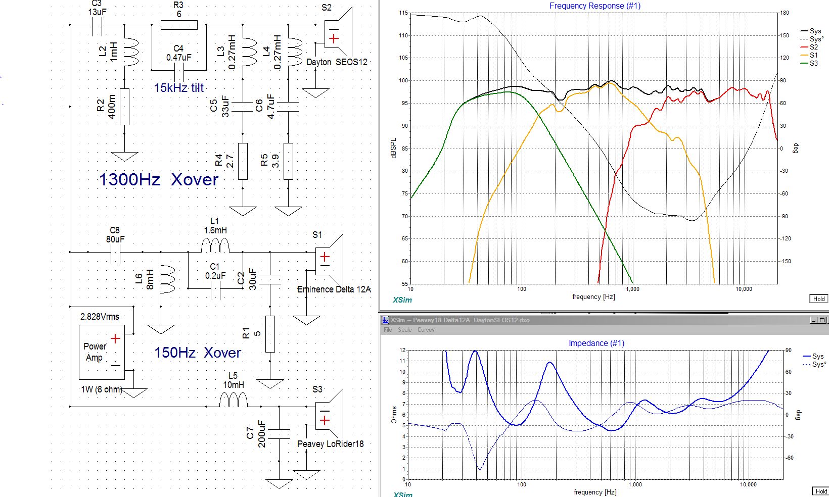

How about: $400 for drivers $100 crossover parts each.
Over 95db/watt. The perfect partner for a 5W tube amp.
Zmin ~4.7 ohms
The Russian President, Dmitry Medvedev owns a pair.
Too Much?
Zmin ~4.7 ohms

You can build a 2-way EconoWave speaker with the info in post#9 for about $250-each in parts with ~45Hz in-room bass from a 3cuft ported cabinet. You would have the later option of sealing this midbass cabinet and adding a real 18" woofer for deep bass even an 8-watt amp can generate. Use big box wood shop skills to construct low cost high efficiency speakers.
95db/watt efficiency, plus high frequency controlled directivity.
2-way EconoWave speaker ~$240 for speakers + crossovers each.
-Dayton SEOS12 waveguide ($14)
-Dayton 250P compression driver ($40)
-Eminence Delta Pro 12A ($130)
- Affordable and Efficient 3-Way Tower design
