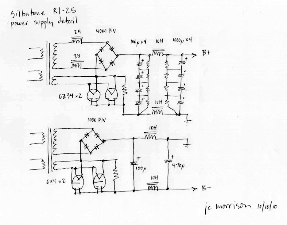

I'm using a version of what Eli Duttman describes as a "cockeyed bridge" on my current breadboard project.Ada schematic that do that? Thx

That said, I've got numerous vintage amps that use SS rectification and they seem to have survived the faster startups. The "cockeyed bridge" I posted earlier seems to offer a bit of both worlds.
The reason I like using (indirectly heated) tube rectifiers is because of the slow startup. You can use a thermistor but they don't come anywhere close to an indirectly heated tube. Even a directly heated rectifier is probably a bit more gradual. Nothing wrong with nostalgia, either.
And many guitarists seem to like tube rectification because they consider the "rectifier sag" to be part of their "sound".
I like your [Eli Duttman]'s 'cockeyed bridge' 🙂 Thanks for that.

Is the b+ is out from the centre tap provided by 6ax4?I'm using a version of what Eli Duttman describes as a "cockeyed bridge" on my current breadboard project.

Yeah, the B+ comes off the cathode of the 6AX4GTB which is connected to the first PS cap, just as it is with a more typical design.Is the b+ is out from the centre tap provided by 6ax4?
