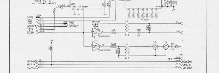

My current transport (Studer A727 CDS) has both standard AES3 and S/PDIF (RCA) digital outputs. I fitted an extra BNC, directly from the Philips SAA7220 decoder (pin 14, DOBM) with Belden 1505A according to Jocko’s recipe http://www.diyaudio.com/forums/showthread.php?s=&postid=301131&highlight=#post301131
Sound wise it does not matter if they are connected simultaneously or one at a time, even if i add the CDD882 (see above) with it’s own direct BNC S/PDIF (yes the dCS has a lot of inputs:whazzat: ). I don’t know what my dCS DAC exactly does electrically with these three different sources when not selected, but my volt meter shows they all share the same chassis ground when the connected with the digital interlinks (I did not open up my dCS for this, but you can hear relays clicking when i switch inputs).
Otherwise these three inputs do sound different mutually, but that's another story and still under investigation 🙂

As far as grounding is concerned, the Studer pcb’s are layed out very, very neatly. Should be of course, as a balanced pro machine, developed in a SOTA joint venture (CDS) between Studer and Philips. Messing around with shunt supplies did cause some ground (and clock!) related problems, varying from erratic behaviour to stressy (jittery?) sound. As the experts tell us, grounding deserves utmost care, so yes you are probably right to look at that again.
