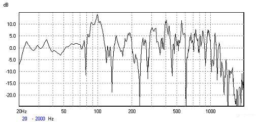

Here's the amplitude response in my listening room with no EQ and 2 subs, one each along the mid point of two opposing walls. No low frequency absorption is fitted to the room for these experiments.
Very flat apart from a sharp dip at about 78Hz and then multiples there of, along with a large-ish peak (15dB) at 100Hz.
(Ignore the response above 150Hz. I think I set the upper cut-off frequency at 1kHz)

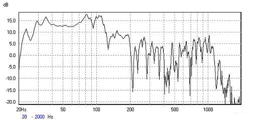

With just a simple 2nd order bass boost at 53Hz and a small change to the position of the subs along the wall, the following amplitude response results.
About +/-3dB from 30Hz to 120Hz....
Note that there is no smoothing at all in these plots.
