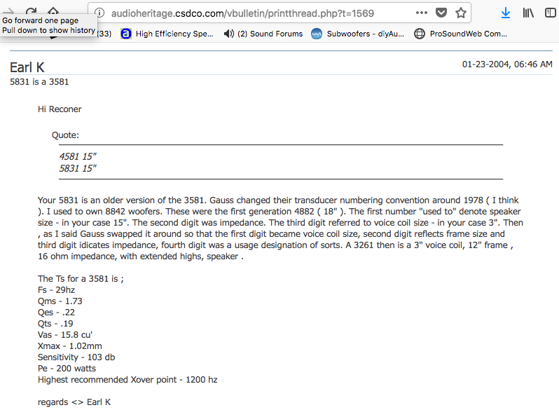

The Gauss 5831 T.S. parameters are fairly different from the TAD 1601, I doubt they would sound "just like" each other.Thank you
If they are not reconed and are remagnetized due their age
Which speakers would you choose?
Is that true that 5831 sounds just like tad 1601?
I would not choose to buy a 40+ year old speaker unless I could test it before purchase.
I can't find ts parameters of 5831The Gauss 5831 T.S. parameters are fairly different from the TAD 1601, I doubt they would sound "just like" each other.
Can you give me a link?
