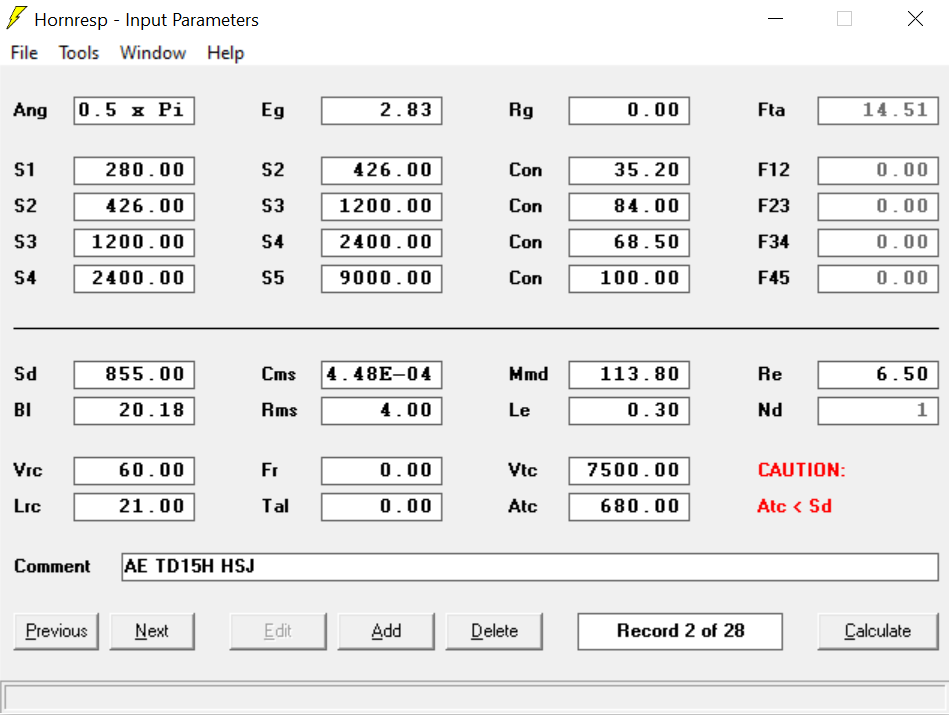

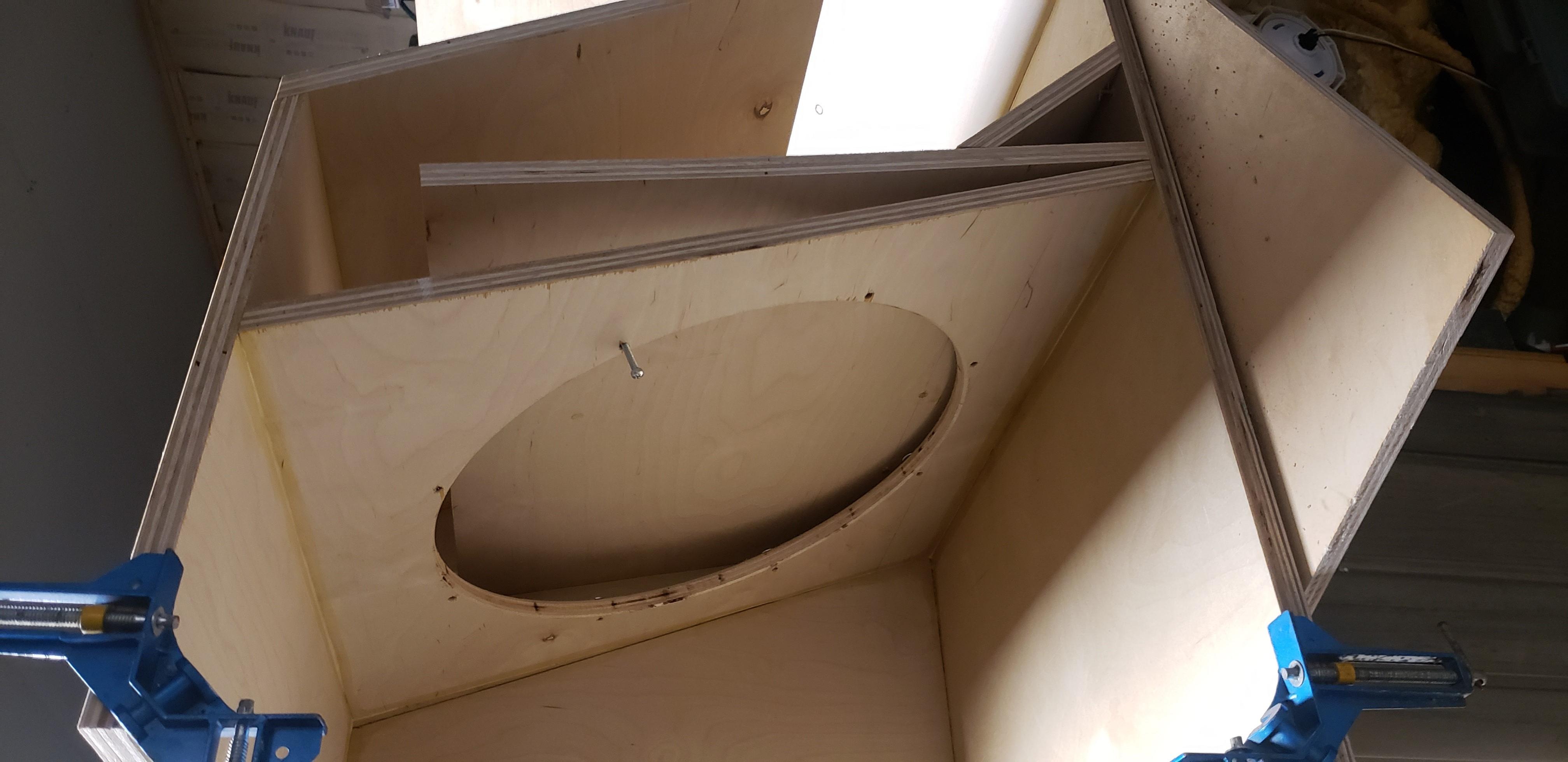

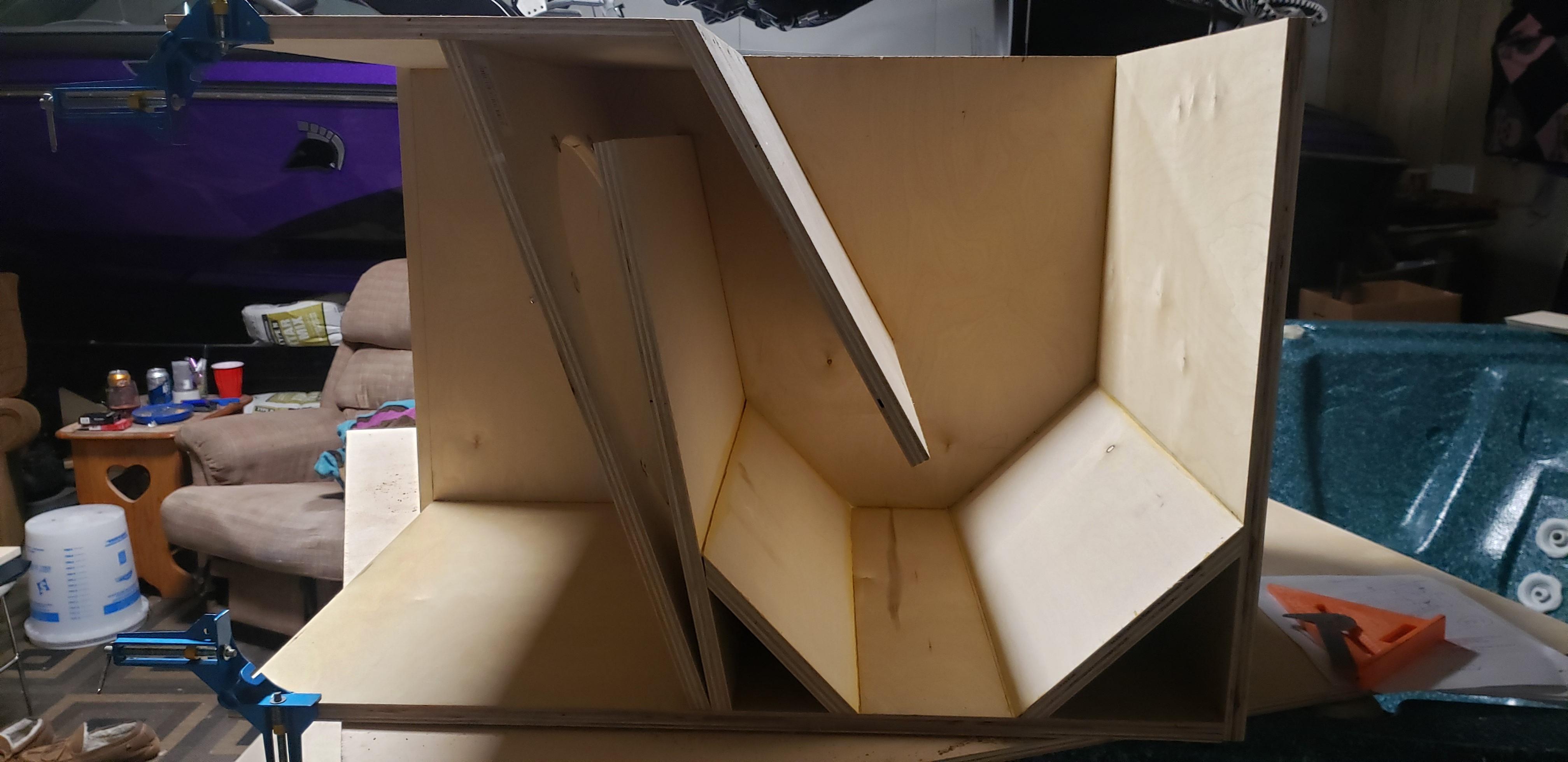

Sorry for the delay guys. The design is a well known one one found here.
Horn Subwoofer
Ive built a few of these already. Decided to test and give it a go. It models very well with a wide variety of drivers. I did find that he was correct in corner loading. You lose the low end roll off by placing it in half space. But when corner loaded.... Whew! A pair of these with td15h's in them would be PLENTY for a large living room or listening room. One of them in my 30x30 garage on a crown xls2000 has managed to irritate my neighbors about a half mile away.
So You will need to modify the original design. The top lid needs to be lifted by 200mm to accommodate driver depth. The one i built were using 18" drivers but the same will need to be done for the 15" drivers. sensitivity is incredible!
Also his design was for 25mm MDF. I made a conversion to 18mm baltic. Its not too tough to do if you shrink down external dimensions to accommodate the smaller thickness. The only dimension you want to have right on the money is the s2 throat. The 50mm and 82mm dimensions need to be kept. The rest can be off the few millimeters from wood thickness with no shift in response. I centered the remaining segments within original 25mm dimensions.

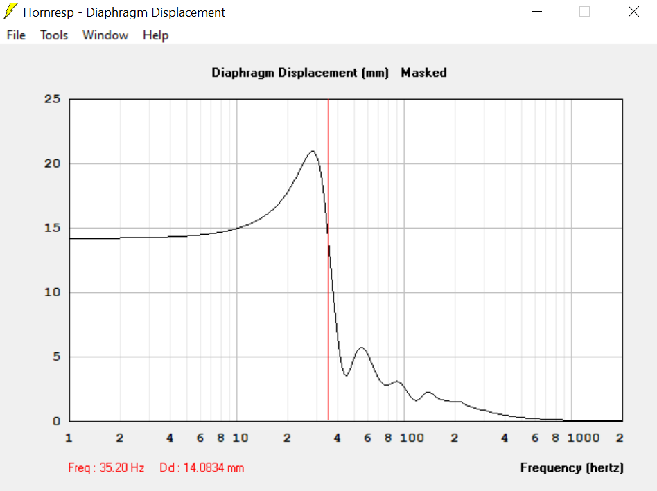

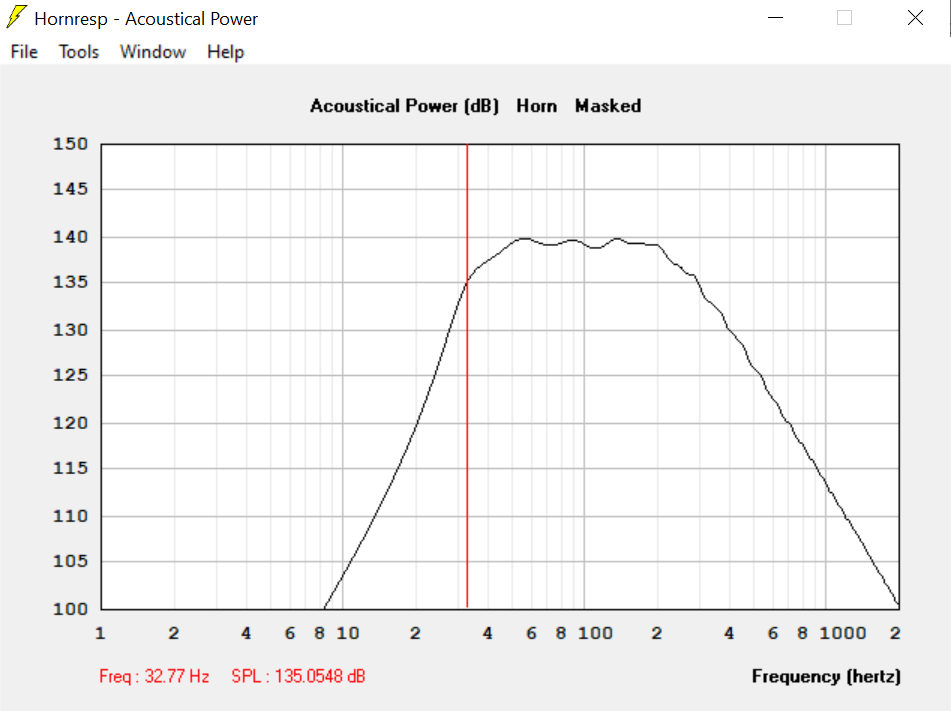

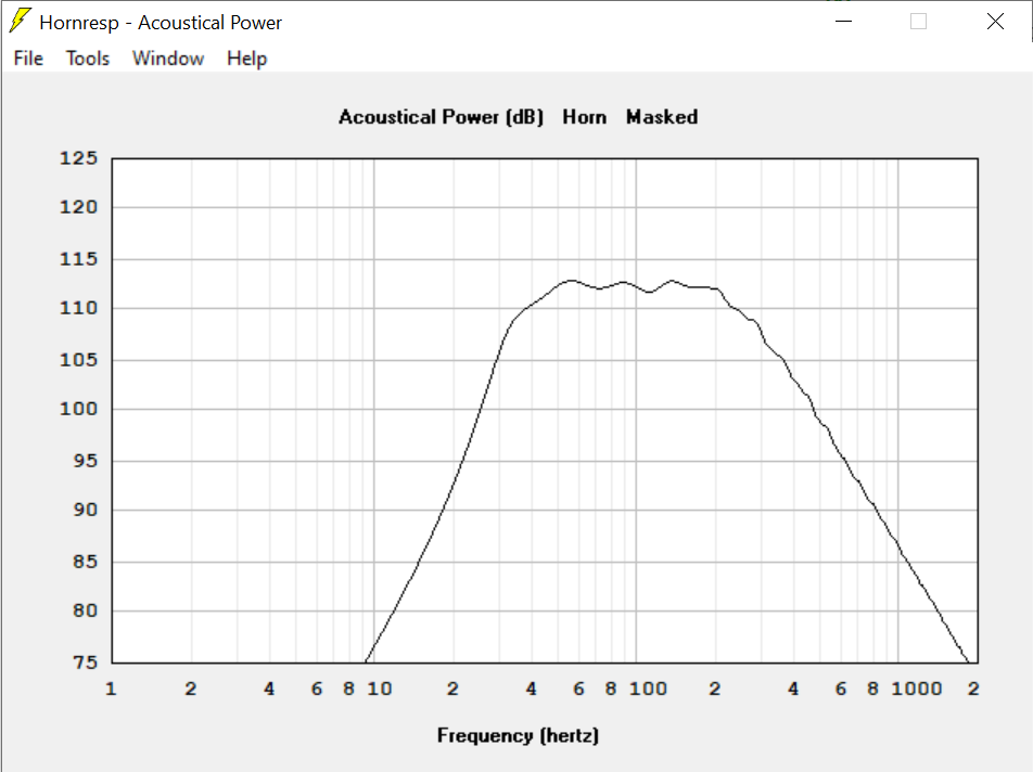

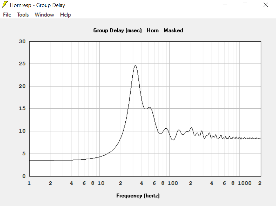

Now applying 500w or 63v to sims.
response and displacement. With 500w, you could get away with no HPF and let it roll off. Ive noticed from my builds, that this cabinet can dig deeper then modeled. Running thru test tones and a cheap SPL meter, and using my highest point of 52hz as reference, I got my -6db at 27hz and my -3db at 35hz. But of course the room itself will be a big factor. If applying greater then 500w, I would adjust a HPF accordingly. I have HPF set at 35hz/24db but im slightly exceeding drivers recommended RMS.

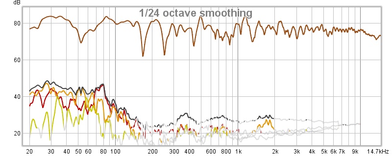

I use the TD15S in 170ltr tuned to 30hz and get 24hz in a 12 y 18 by 7 foot room 33" from the side and 44" from the front walls. Cross at 350hz to mid. Here's the response at 8' listening position with REW.
