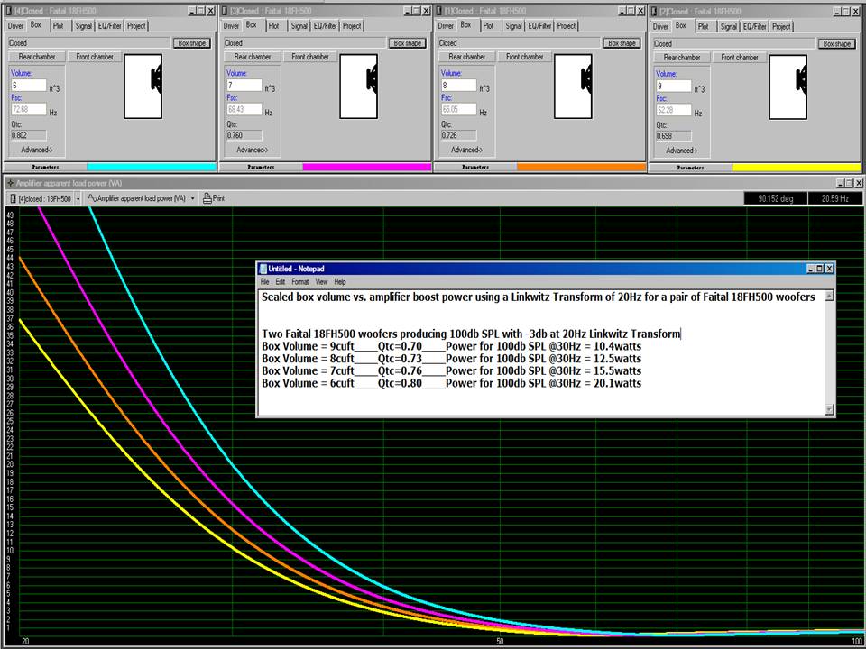

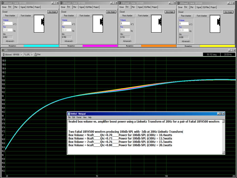

Two 18" side-side woofers can produce 100db SPL 30Hz bass with just 10 watts of power in an 8cuft cabinet. Two 18" side-side woofers can produce 100db SPL 30Hz bass with just 20 watts of power in a more modest 6cuft cabinet.
Sealed box volume vs. amplifier boost power using a Linkwitz Transform of 20Hz for a pair of Faital 18FH500
Two Peavey Faital 18FH500 woofers producing 100db SPL with -3db at 20Hz Linkwitz Transform
Box Volume = 9cuft____Qtc=0.70___Power for 100db SPL @30Hz = 10.4watts
Box Volume = 8cuft____Qtc=0.73___Power for 100db SPL @30Hz = 12.5watts
Box Volume = 7cuft____Qtc=0.76___Power for 100db SPL @30Hz = 15.5watts
Box Volume = 6cuft____Qtc=0.80___Power for 100db SPL @30Hz = 20.18watts

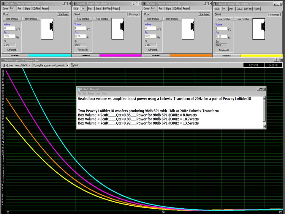

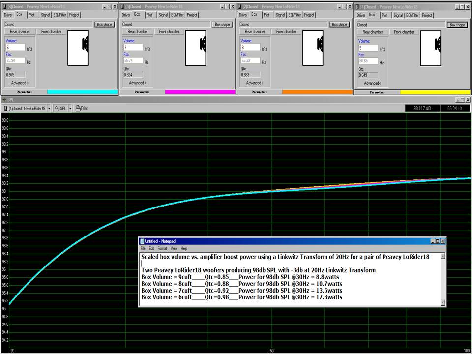

Sealed box volume vs. amplifier boost power using a Linkwitz Transform of 20Hz for a pair of Peavey LoRider18
Two Peavey LoRider18 woofers producing 98db SPL with -3db at 20Hz Linkwitz Transform
Box Volume = 9cuft____Qtc=0.85___Power for 98db SPL @30Hz = 8.8watts
Box Volume = 8cuft____Qtc=0.88___Power for 98db SPL @30Hz = 10.7watts
Box Volume = 7cuft____Qtc=0.92___Power for 98db SPL @30Hz = 13.5watts
Box Volume = 6cuft____Qtc=0.98___Power for 98db SPL @30Hz = 17.8watts

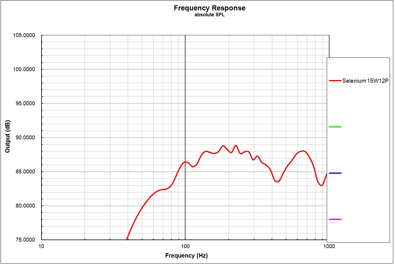

Simulation of basic dipole design similar to picture. Maximum SPL from One_15W12P Dipole @10% distortion. Model based upon the pictured baffle and estimated wall distances with one 15W12P speaker at the center. No modeling of BAF rear absorption material.
Measure the width. At the least it should be well waveguided where this is a wavelength. The double height (actually four times when you consider the floor image) will add to this but the width will be the weakest link so to speak. Even half a wavelength is having an effect but mouth resonance could also have an effect.I never really worked out whether the LF section was horn loaded or just a wave guided sub?
That sim, isn't far off what i get before equalisation, the BAF loads up the horn as well.
