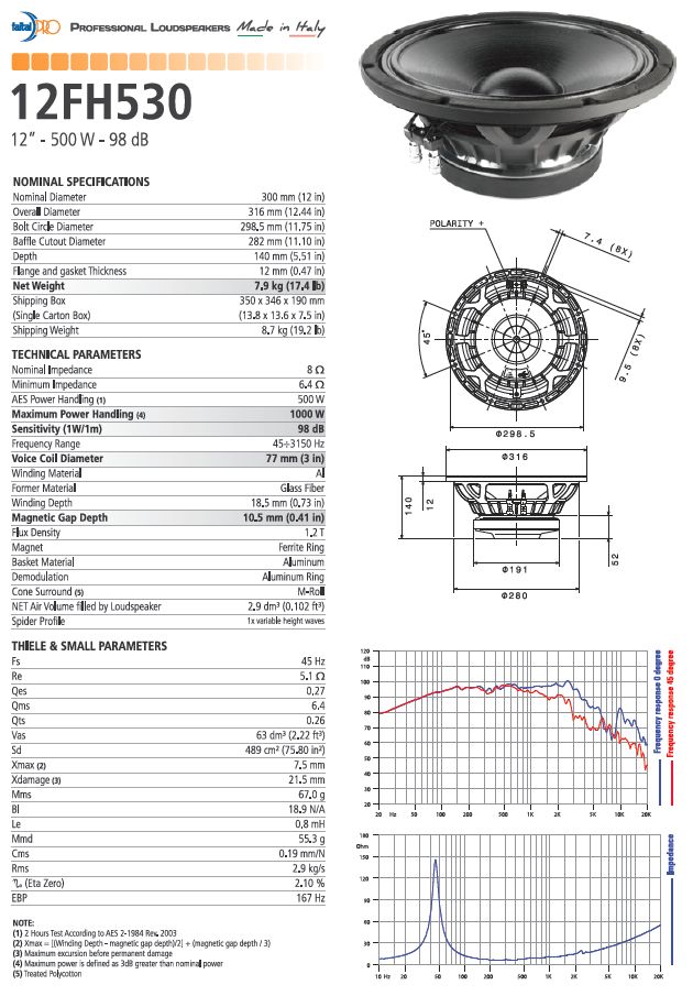

I have looked at the faital 12FH530 driver that was used in the BMF1, but am not sure if going to marry with TPL as well.
The Beyma 122ND has an Xmax of just 2mm. The Beyma 12P80Nd has an Xmax of 7.5mm. Very different motors.

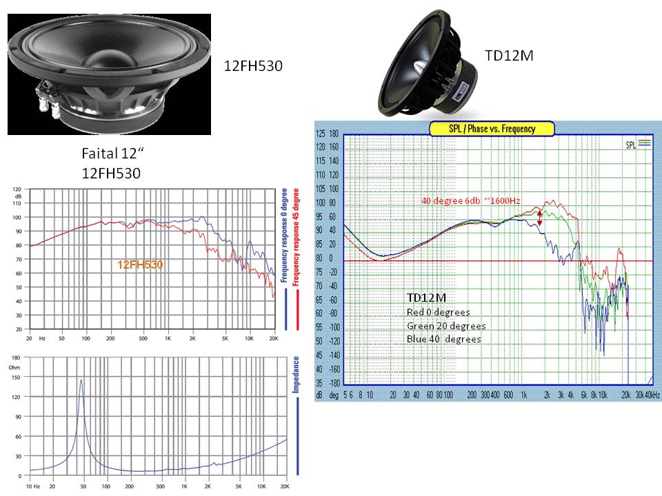

THE USUAL SUSPECTS:
1--My favorite is the Lambda TD12M because it has the lowest harmonic distortion and matched polar at 1600Hz(and I own a pair)
2--From the datasheet, the Faital 12FH530 also looks excellent. Low Le shorting ring on the pole. Dampeded cone breakup. Good SPL polar match to TPL horn.
3--From the datasheet, the Beyma 12P80Nd has the highest BL=23.1 and BL/Mms(56g). The cone uses composite paper plus carbon fiber. The mirrored(2-spider) suspension is linear to 7.5mm xmax. The datasheet SPL shows cone breakup ~2Khz which suggests a steep slope active Xover is beneficial. The Qtc=0.17 offers motor controlled speed with accuracy which several say is necessary to match the TPL-150.
4--From the datasheet, the 18Sound 12NMB420 also looks excellent. Low Le, just 34g Mms, dampened cone breakup. Good SPL polar match.

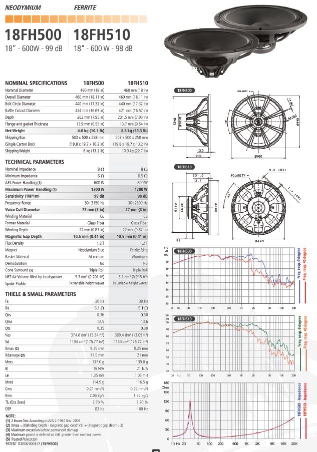

THE ITALIAN CONNECTION: Faital 12FH530 and two Faital 18FH500
probably the best overall driver pairing

(Is the 122Nd - not in same league as the 12P80Nd sonically?)
I ran a simple sim on the 122Nd which estimated that with 2mm Xmax at 90Hz it can generate ~ 101db @1m maximum SPL before the distortion would increase from out-of-gap over extension. Xdamage is 16mm, so increased distortion would probably be the main concern for high SPL transients.
The 122Nd SPL/freq curve in the datasheet shows ~5db increase jump at the primary cone diameter resonance(400-500Hz) which you would want to check with your own measurements before constructing a crossover.

From the datasheet, the NEW Faital Pro 18XL1800 looks like a great high power, high output woofer capable of scary SPL deep bass. MMs = 245g, Le=2.04mH, Qts=0.40.
Simulate two 18XL1800 in a sealed 9cuft box with a 20Hz Linkwitz transform and see how much power is required for 100db SPL @30Hz.
I favor 18" woofers with modest Mms(like 170g), modest Le(like 0.9mH) and smaller box Qtc(like 0.37 ) which in a 9cuft box plus 20Hz LinkWitz transform can generate 100db @30Hz with 20 watts of power(without room gain added). A philosophy of power efficient bass over monster high SPL bass.

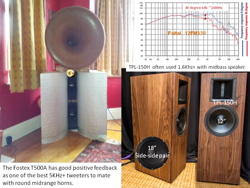

Have you experimented with using a small horn tweeter like the Fostex T90A or T500A? They were designed for integration with a round midrange horn. There are several positive feedback reports. You can locate the Fostex just under your LeCleach front edge and use your DSP for time alignment.

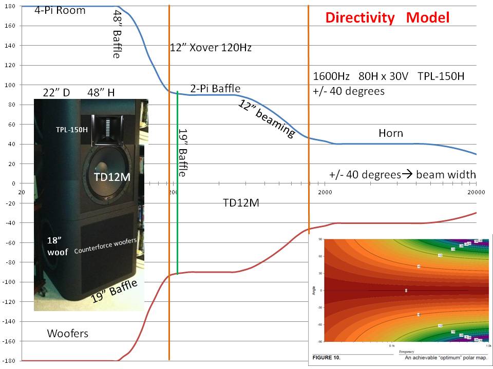

The Beyma TPL-150H has a 80H x 30V horn pattern. They are often mated to sealed boxed midrange speakers which gradually beam to +/- 40degrees around 1600Hz. This creates a smooth directivity function that provides a natural soundstage in many homes. Geddes has a good whitepaper. http://www.gedlee.com/downloads/directivity.pdf
I suspect you have enough spare stuff in storage to build a speaker like the BMF-1 around your TPL-150H. If you constructed a separate sealed woofer box you could also test it with your current LeCleach system.

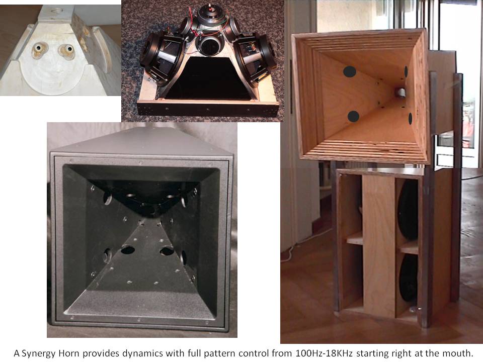

I think the point of me wanting to replace the midrange is being missed. I have thougth that the TPL and a round horn don't work that well some time ago. What I do know is that integrating anything below the midrange horn is more challenging. I have some BMS 4592's. I used in the horns no integration issues at the top, my 10 ft listening position wasn't far enough back for them though to be on axis. So that's why I think the horn needs to be replaced, to ease integration, but what I replace it with needs 99% of the qualities of a big CD in a big horn, is this an impossible ask?
A Synergy Horn provides dynamics with full pattern control from 100Hz-18Khz starting right at the mouth. It solves the "big horns in a small room" delayed arrivals integration problems. Your DSP will greatly simplify the complex crossover. You could construct 60H x 60V horn, or 50H x 50V horn to remove the small room short latency wall/floor reflections that confuse the real stereo image.
My understanding of some good small room speaker options:
1) Remove small room effects: Synergy Horn with dipole woofers OR two sealed counter-force woofers if DEEP BASS is important.
3) Geddes controlled directivity: BMF-1 design. Control short delay room reflections down to 400Hz. My last post illustrated the polar pattern of sealed woofers + 12" midbass + TPL-150H.
3) I love wood horns: BMS 4592 in LeCleach with DSP boost on bass and treble. Adjust horn height and toe-in. Experiment with Geddes-type open cell foam to reduce tweeter beaming.

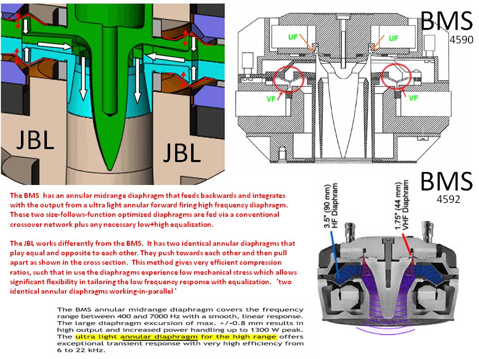

If it was me, I would not consider using the BMS 4592ND in case you expect an improvement. I have tried these drivers in several horns and while they had SPL and dynamics in spades, I never succeeded making them sound natural. Too much sibilance (t- and s- sounds, especially on female vocals). I know that Bert Doppenberg uses the BMS 4592 in his Orphean speakers, which should sound good, but his drivers are modified mechanically somehow....
I also happen to have the Beyma TPL-150H and they sound much more natural and relaxed in their frequency range than at least I will ever be able to make the BMS coax'es do...

Are you "satisfied" with your 28" diameter LeCleach horn using the DSP equalized BMS 4592 coaxial compression driver from 350Hz up to 18Khz when it is mounted near ear level NEXT TO your 2x woofer bass horn? (You might put the LeCleach on top of the woofers and just turn-off the top 15" woofer for an ear-height test. )
In post #9 I estimated that the center of your LeCleach was about 62" high and suggested removing the TPL-150 to test if bass integration improved as the you lowered the LeCleach closer to ear level. A small Fostex T90A could be mounted without raising the LeCleach with JBL 2482.
With DSP equalization on the BMS 4592, putting Geddes-type open cell foam just inside the LeCleach throat will slightly increase the tweeter air pulse power that mixes with the more powerful midange pulses inside the BMS 4592. The foam should remove more tweeter harmonics than midrange, and this might reduce the reported S'sssss sibilence. ----any thoughts?
