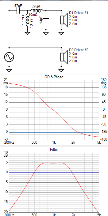

Increasing sensitivity or overall level, and increasing SPL are two different things because SPL is non band specific.
You have no idea what you're talking about. We are talking about PASSIVE speakers. If the FR is not loud enough, you cannot increase it to the same spl as the woofer passive.

BTW, the overall level of a midrange driver can be increased beyond its rated sensitivity using a passive band-pass filter.
It can, if..
..you are willing to take the highly increased Q and overswing
..you are willing to take the vastly worse decay
..you are willing to take the phase changes
..you are willing to take the immensely higher group delay
..you are willing to take the worse impulse answer
..you are willing to limit the bandwidth
..you are willing to take the low impedance (guess where the energy for that comes from?)
..you are willing to take the immense hit on the SQ
..you are willing to accept the influence on the crossover (if it can be done at all because the filters interact)
..you are willing to pay for the parts (usually more expensive than the driver)
..1-2 dB increase are enough, because you'll have to get the bump on top flat again
Which means, it's never even an option. Please, show me an example in a simulation.
But if the amp can deal with a ribbon, then...
Again, total BS!
That graph does not have anything to do with a speaker. Take a simulation of a 2 or 3 way speaker, no matter if it's Boxsim, Virtuix or whatever but use it with a speaker and show the impedance and how it works with the crossover.
Funny you're using coils with 1,1mH with just 10 mOhm (milliOhm).
And just a little hint: A delay of just 1ms equals a distance offset of 34,3 cm!
