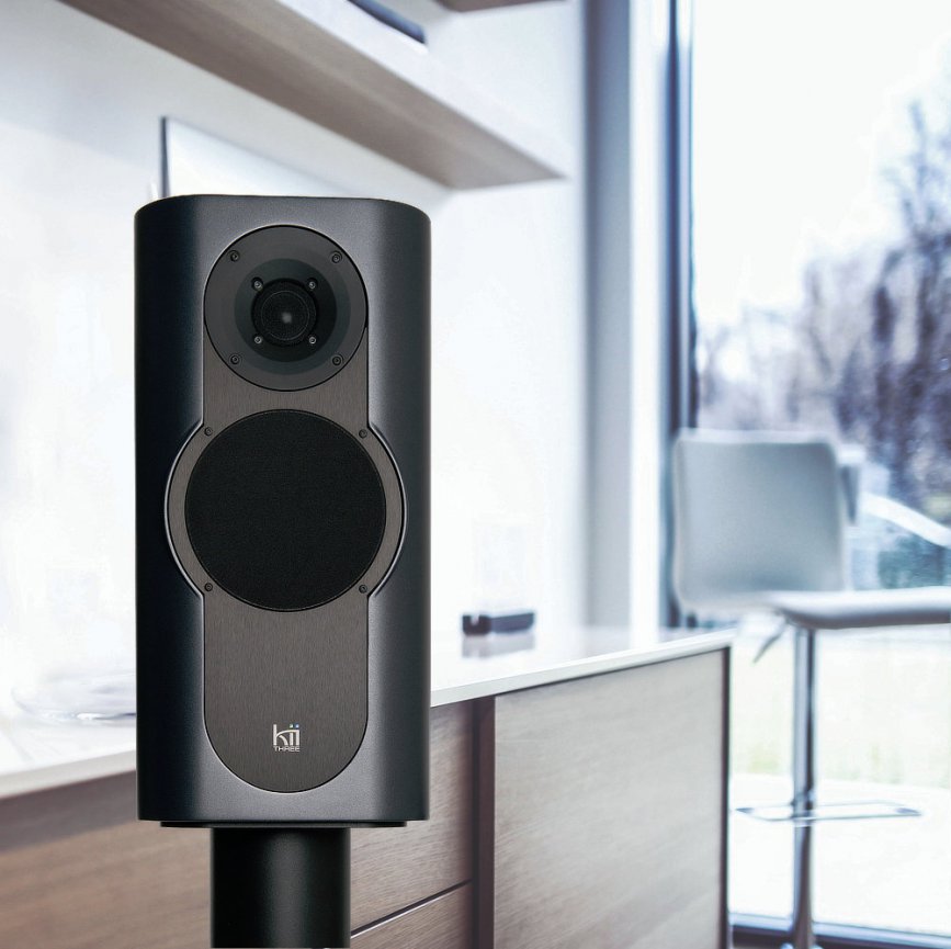

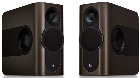

-I should also note that if you want to do a major round-over (..like the stuff from tapeease.com), that even though it requires extra width: the result would be superior. Something like their 3" Quarter Round (or larger). ..but it would likely make more of a visual "impact" in-room with that extra width.
You could even do it like Kii to keep width narrower - with its midbass proud of the round-over (..though the top edge isn't great with their design):
Though like much of the other additions I've mentioned: premature; this is something that should be noted:

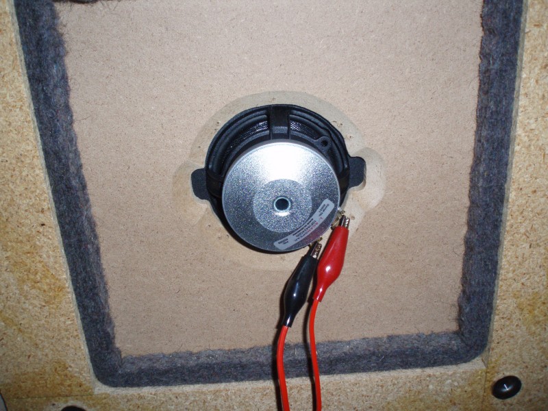

Needs rear chamfer/bevel around drivers, most notably the midrange.
Ex.

The Kii look would pretty much require a supplier (*like Tapeease). Only large industrial router/planars are going to have access to a custom bit to do an actual round-over like that - and even then it's kind of a waste (..because it's a block of wood being rounded-over rather than something like the Tapeease). There are of course other ways to achieve that like a steam-and-bend on forms process, or doing multiple thin cuts to make the bend (and then filling-in the slots when done), or doing a stack-cut, or making a form and using a resin/cement, etc.. All to complex for this sort of build.
*of course you might be able to find such a supplier near you. Europe's got a lot of nice cabinet-grade material sources, and my guess is there is probably something like that available.
I am confident i can do the woodwork related to the actual design, I may have access to a CNC but I am not sure yet, if not I will just buy a router (défonceuse) and practice.
There must be are proper provider like Tapeease somewhere around but I have not found one like that, and if it is I'm afraid that it will not be equivalent to the providers in US.

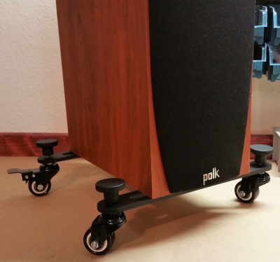

If you are "up to it" - casters on stands can work very well! (..the result will be very much worth it for critical listening.) 🙂

You mean I would put that small wheels on that cabinet stand and put spikes between the stands and the cabinets? I guess I would have to be really careful not to tip that, can't I use stuff like that instead ? :If you are "up to it" - casters on stands can work very well! (..the result will be very much worth it for critical listening.) 🙂

Not joking, I've been known to do this myself. 😉
You know, casters:
casters - Google Search
Total cabinet height needs to be the same, so subtract from stand height or place casters on outside of stand (..opposed to stand) like image below.
You know, casters:
